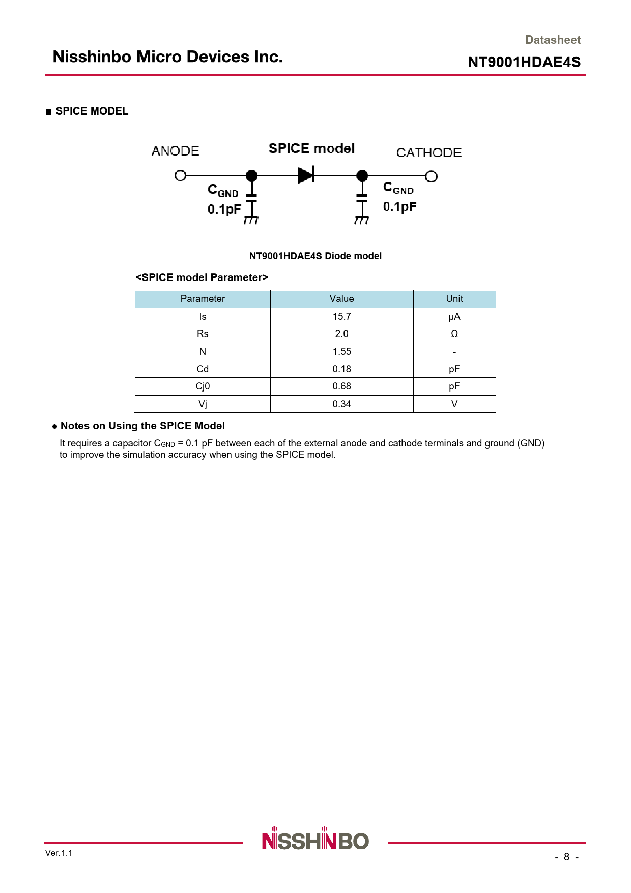

Datasheet. NT9001HDAE4S. ■ SPICE MODEL. NT9001HDAE4S Diode model. <SPICE model Parameter>. Notes on Using the SPICE Model
Datasheet NT9001HDAE4S ■ SPICE MODEL NT9001HDAE4S Diode model <SPICE model Parameter> Notes on Using the SPICE Model
Parameter Value Unit Is 15.7 μA Rs 2.0 Ω N 1.55 - Cd 0.18 pF Cj0 0.68 pF Vj 0.34 V
It requires a capacitor CGND = 0.1 pF between each of the external anode and cathode terminals and ground (GND) to improve the simulation accuracy when using the SPICE model. Ver.1.1 - 8 - Document Outline FEATURES GENERAL DESCRIPTION APPLICATIONS BLOCK DIAGRAM ■ PRODUCT NAME INFORMATION ■ ORDER INFORMATION ■ PIN DESCRIPTIONS ■ ABSOLUTE MAXIMUM RATINGS ■ THERMAL CHARACTERISTICS ■ ELECTROSTATIC DISCHARGE RATINGS ■ RECOMMENDED OPERATING CONDITIONS ■ ELECTRICAL CHARACTERISTICS (DC) ■ TYPICAL CHARACTERISTICS ■ SPICE MODEL ● Notes on Using the SPICE Model ■ MARKING SPECIFICATION ■ REVISION HISTORY PACKAGE INFORMATION CAUTION
