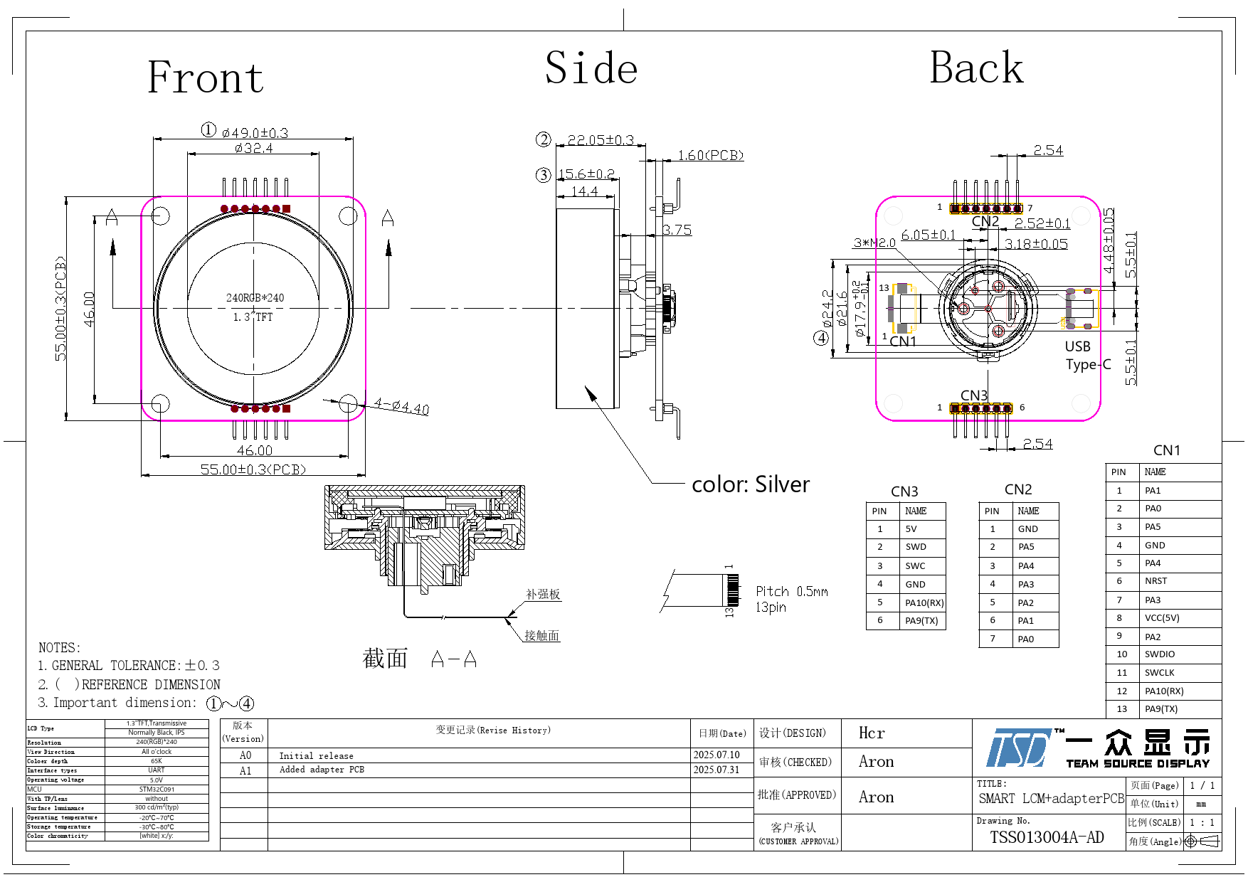

DescriptionTSD 240x240 resolution rotary knob display with STM32C091 MCU
Pages / Page1 / 1 — Front. Side. Back. 1. 2. 3. 1. 7. CN2. 13. 240RGB*240. 1.3"TFT. 4. 1. …
File Format / SizePDF / 305 Kb
Front. Side. Back. 1. 2. 3. 1. 7. CN2. 13. 240RGB*240. 1.3"TFT. 4. 1. CN1. USB. Type-C. CN3. 1. 6. CN1. PIN. NAME. color:. Silver. CN3. CN2. 1. PA1. 2. PA0. PIN. NAME. PIN. NAME. 1. 5V. 1
Datasheet TSS013004A-AD Team Source Display
Front Side Back 1 2 3 1 7 CN2 13 240RGB*240 1.3"TFT 4 1 CN1 USB Type-C CN3 1 6 CN1 PIN NAME color: Silver CN3 CN2 1 PA1 2 PA0 PIN NAME PIN NAME 1 5V 1 GND 3 PA5 2 SWD 2 PA5 4 GND 5 PA4 1 3 SWC 3 PA4 6 NRST 4 GND 4 PA3 补强板 5 PA10(RX) 5 7 PA3 PA2 13 6 PA9(TX) 6 8 VCC(5V) PA1 接触面 9 7 PA2 NOTES: PA0 10 SWDIO 1.GENERAL TOLERANCE:±0.3 截面 11 SWCLK 2.( )REFERENCE DIMENSION 12 PA10(RX) 3.Important dimension: 1 4 13 PA9(TX) 1.3"TFT,Transmissive LCD Type 版本 变更记录(Revise History) Normally Black, IPS 日期(Date) 设计(DESIGN) Hcr (Version) Resolution 240(RGB)*240 View Direction All o'clock A0 Initial release 2025.07.10 Coloer depth 65K 审核(CHECKED) Aron Interface types UART A1 Added adapter PCB 2025.07.31 Operating voltage 5.0V TITLE: 页面(Page) 1 / 1 MCU STM32C091 With TP/Lens 批准(APPROVED) without Aron SMART LCM+adapterPCB 单位(Unit) mm Surface luminance 300 cd/m²(typ) Operating temperature -20℃~70℃ Drawing No. 比例(SCALE) 1 : 1 Storage temperature -30℃~80℃ 客户承认 Color chromaticity [white] x:/y: (CUSTOMER APPROVAL) TSS013004A-AD 角度(Angle)
