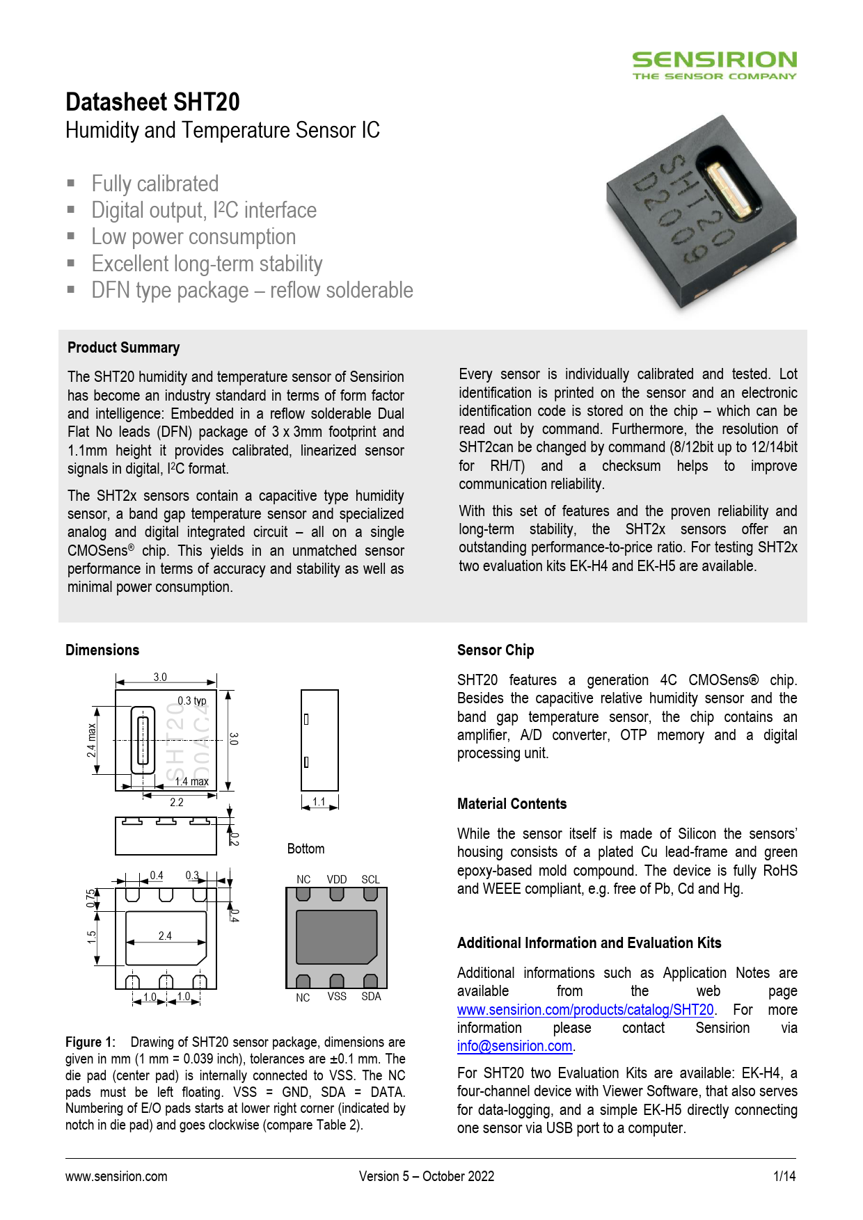

Humidity and Temperature Sensor IC ▪ Fully calibrated ▪ Digital output, I2C interface ▪ Low power consumption ▪ Excellent long-term stability ▪ DFN type package – reflow solderable
Product Summary
The SHT20 humidity and temperature sensor of Sensirion Every sensor is individually calibrated and tested. Lot has become an industry standard in terms of form factor identification is printed on the sensor and an electronic and intelligence: Embedded in a reflow solderable Dual identification code is stored on the chip – which can be Flat No leads (DFN) package of 3 x 3mm footprint and read out by command. Furthermore, the resolution of 1.1mm height it provides calibrated, linearized sensor SHT2can be changed by command (8/12bit up to 12/14bit signals in digital, I2C format. for RH/T) and a checksum helps to improve communication reliability. The SHT2x sensors contain a capacitive type humidity sensor, a band gap temperature sensor and specialized With this set of features and the proven reliability and analog and digital integrated circuit – all on a single long-term stability, the SHT2x sensors offer an CMOSens® chip. This yields in an unmatched sensor outstanding performance-to-price ratio. For testing SHT2x performance in terms of accuracy and stability as well as two evaluation kits EK-H4 and EK-H5 are available. minimal power consumption.
D imensions Sensor Chip
3.0 SHT20 features a generation 4C CMOSens® chip. 0.3 typ Besides the capacitive relative humidity sensor and the 0 4 band gap temperature sensor, the chip contains an x a 2 C 3 m 0. amplifier, A/D converter, OTP memory and a digital 4 T . A 2 processing unit. H 0 1.S4 max D 2.2 1.1
Material Contents
0 2. While the sensor itself is made of Silicon the sensors’ Bottom housing consists of a plated Cu lead-frame and green View epoxy-based mold compound. The device is fully RoHS 0.4 0.3 NC VDD SCL 5 and WEEE compliant, e.g. free of Pb, Cd and Hg. 7.0 0 4. 5 . 2.4 1
Additional Information and Evaluation Kits
Additional informations such as Application Notes are available from the web page 1.0 1.0 NC VSS SDA www.sensirion.com/products/catalog/SHT20. For more information please contact Sensirion via
Figure 1:
Drawing of SHT20 sensor package, dimensions are info@sensirion.com. given in mm (1 mm = 0.039 inch), tolerances are ±0.1 mm. The die pad (center pad) is internally connected to VSS. The NC For SHT20 two Evaluation Kits are available: EK-H4, a pads must be left floating. VSS = GND, SDA = DATA. four-channel device with Viewer Software, that also serves Numbering of E/O pads starts at lower right corner (indicated by for data-logging, and a simple EK-H5 directly connecting notch in die pad) and goes clockwise (compare Table 2). one sensor via USB port to a computer. www.sensirion.com Version 5 – October 2022 1/14
