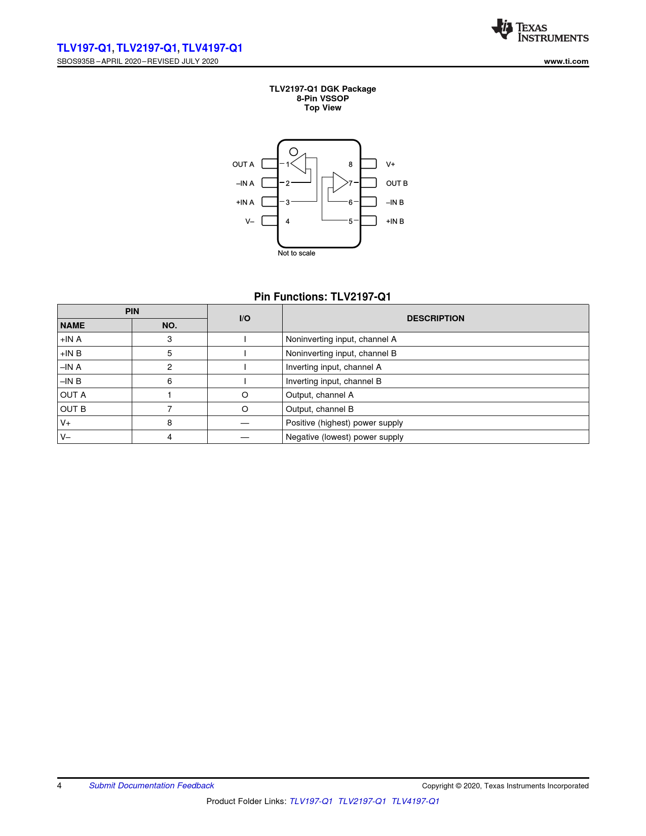

TLV197-Q1. , TLV2197-Q1. , TLV4197-Q1. www.ti.com. TLV2197-Q1 DGK Package. 8-Pin VSSOP. Top View. Pin Functions: TLV2197-Q1. PIN. I/O
TLV197-Q1 , TLV2197-Q1 , TLV4197-Q1 www.ti.com TLV2197-Q1 DGK Package 8-Pin VSSOP Top View Pin Functions: TLV2197-Q1 PIN I/O
SBOS935B – APRIL 2020 – REVISED JULY 2020
www.ti.com TLV2197-Q1 DGK Package 8-Pin VSSOP Top View Pin Functions: TLV2197-Q1 PIN I/O DESCRIPTION NAME NO.
+IN A 3 I Noninverting input, channel A +IN B 5 I Noninverting input, channel B –IN A 2 I Inverting input, channel A –IN B 6 I Inverting input, channel B OUT A 1 O Output, channel A OUT B 7 O Output, channel B V+ 8 — Positive (highest) power supply V– 4 — Negative (lowest) power supply 4 Submit Documentation Feedback Copyright © 2020, Texas Instruments Incorporated Product Folder Links: TLV197-Q1 TLV2197-Q1 TLV4197-Q1 Document Outline 1 Features 2 Applications 3 Description Table of Contents 4 Revision History 5 Pin Configuration and Functions 6 Specifications 6.1 Absolute Maximum Ratings 6.2 ESD Ratings 6.3 Recommended Operating Conditions 6.4 Thermal Information: TLV197-Q1 6.5 Thermal Information: TLV2197-Q1 6.6 Thermal Information: TLV4197-Q1 6.7 Electrical Characteristics: VS = ±4 V to ±18 V (VS = 8 V to 36 V) 6.8 Electrical Characteristics: VS = ±2.25 V to ±4 V (VS = 4.5 V to 8 V) 6.9 Typical Characteristics 7 Detailed Description 7.1 Overview 7.2 Functional Block Diagram 7.3 Feature Description 7.3.1 Input Protection Circuitry 7.3.2 EMI Rejection 7.3.3 Phase Reversal Protection 7.3.4 Thermal Protection 7.3.5 Capacitive Load and Stability 7.3.6 Common-Mode Voltage Range 7.3.7 Electrical Overstress 7.3.8 Overload Recovery 7.4 Device Functional Modes 8 Application and Implementation 8.1 Application Information 8.2 Typical Applications 8.2.1 16-Bit Precision Multiplexed Data-Acquisition System 8.2.1.1 Design Requirements 8.2.1.2 Detailed Design Procedure 8.2.1.3 Application Curve 8.2.2 Slew-Rate Limit for Input Protection 8.2.3 Precision Reference Buffer 9 Power Supply Recommendations 10 Layout 10.1 Layout Guidelines 10.2 Layout Examples 11 Device and Documentation Support 11.1 Device Support 11.1.1 Development Support 11.1.1.1 TINA-TI (Free Software Download) 11.2 Documentation Support 11.2.1 Related Documentation 11.3 Related Links 11.4 Receiving Notification of Documentation Updates 11.5 Support Resources 11.6 Trademarks 11.7 Electrostatic Discharge Caution 11.8 Glossary 12 Mechanical, Packaging, and Orderable Information
