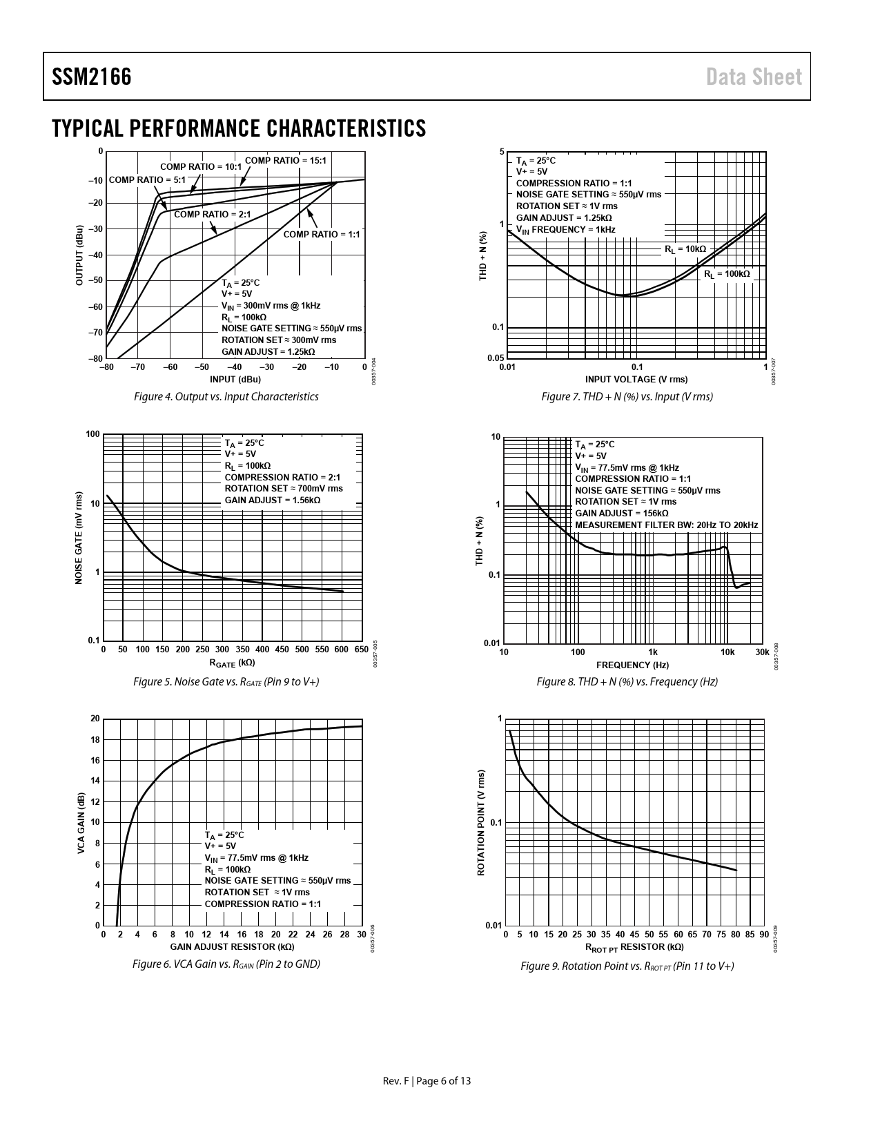

SSM2166. Data Sheet. TYPICAL PERFORMANCE CHARACTERISTICS. COMP RATIO = 15:1. COMP RATIO = 10:1. A = 25°C. V+ = 5V
SSM2166 Data Sheet TYPICAL PERFORMANCE CHARACTERISTICS COMP RATIO = 15:1 COMP RATIO = 10:1 A = 25°C V+ = 5V
SSM2166 Data Sheet TYPICAL PERFORMANCE CHARACTERISTICS 0 5 COMP RATIO = 15:1 T COMP RATIO = 10:1 A = 25°C V+ = 5V –10 COMP RATIO = 5:1 COMPRESSION RATIO = 1:1 NOISE GATE SETTING ≈ 550µV rms –20 ROTATION SET ≈ 1V rms COMP RATIO = 2:1 GAIN ADJUST = 1.25kΩ ) –30 1 ) V Bu COMP RATIO = 1:1 IN FREQUENCY = 1kHz d % ( R –40 N ( L = 10kΩ UT P UT HD + R –50 T L = 100kΩ O TA = 25°C V+ = 5V –60 VIN = 300mV rms @ 1kHz RL = 100kΩ 0.1 –70 NOISE GATE SETTING ≈ 550µV rms ROTATION SET ≈ 300mV rms GAIN ADJUST = 1.25kΩ –80 0.05 –80 –70 –60 –50 –40 –30 –20 –10 0

0 00 Figure 4. Output vs. Input Characteristics Figure 7. THD + N (%) vs. Input (V rms)
100 10 TA = 25°C TA = 25°C V+ = 5V V+ = 5V RL = 100kΩ VIN = 77.5mV rms @ 1kHz COMPRESSION RATIO = 2:1 COMPRESSION RATIO = 1:1 ROTATION SET ≈ 700mV rms NOISE GATE SETTING ≈ 550µV rms s) 10 GAIN ADJUST = 1.56kΩ 1 ROTATION SET ≈ 1V rms rm V ) GAIN ADJUST = 156kΩ m % MEASUREMENT FILTER BW: 20Hz TO 20kHz E ( T N ( A D + H T ISE G 1 O 0.1 N 0.1

00 Figure 5. Noise Gate vs. RGATE (Pin 9 to V+) Figure 8. THD + N (%) vs. Frequency (Hz)
20 1 18 16 s) 14 m r V B) ( d 12 T N ( IN AI 10 O 0.1 P TA = 25°C N 8 CA G V V+ = 5V TIO V 6 IN = 77.5mV rms @ 1kHz TA R O L = 100kΩ R 4 NOISE GATE SETTING ≈ 550µV rms ROTATION SET ≈ 1V rms 2 COMPRESSION RATIO = 1:1 0 0.01 0 2 4 6 8 10 12 14 16 18 20 22 24 26 28 30

00 Figure 6. VCA Gain vs. RGAIN (Pin 2 to GND) Figure 9. Rotation Point vs. RROT PT (Pin 11 to V+) Rev. F | Page 6 of 13 Document Outline FEATURES APPLICATIONS GENERAL DESCRIPTION FUNCTIONAL BLOCK DIAGRAM AND TYPICAL SPEECH APPLICATION TABLE OF CONTENTS REVISION HISTORY SPECIFICATIONS ABSOLUTE MAXIMUM RATINGS THERMAL RESISTANCE ESD CAUTION PIN CONFIGURATION AND FUNCTION DESCRIPTIONS TYPICAL PERFORMANCE CHARACTERISTICS THEORY OF OPERATION APPLICATIONS INFORMATION SIGNAL PATH LEVEL DETECTOR CONTROL CIRCUITRY Compression Ratio Rotation Point VCA Gain Setting and Muting Downward Expansion Threshold POWER-DOWN FEATURE PCB LAYOUT CONSIDERATIONS OUTLINE DIMENSIONS ORDERING GUIDE
