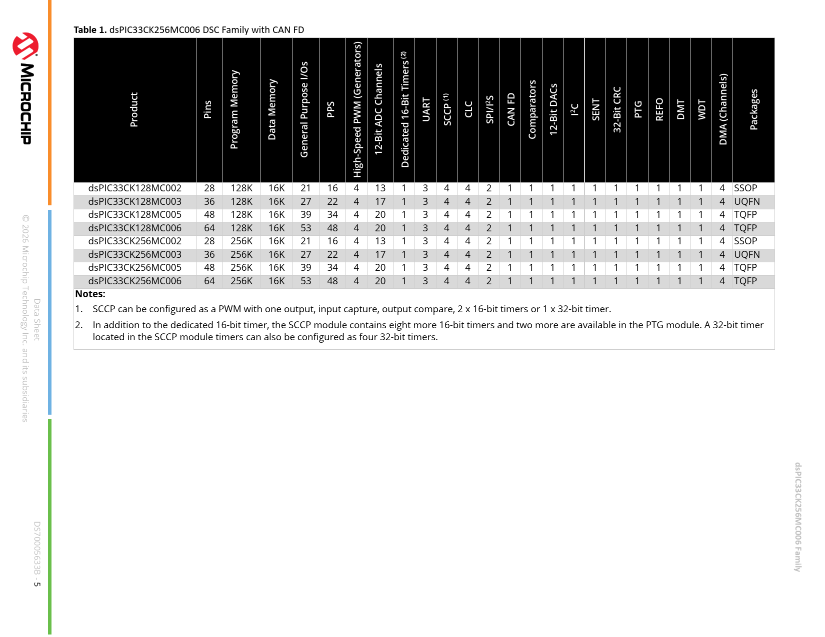

Table 1.
dsPIC33CK256MC006 DSC Family with CAN FD
(2) (1) S2 C Pins PPS CLC 2 I SENT PTG REFO DMT WDT Product UART SCCP SPI/I CAN FD 32-Bit CRC Packages Data Memory Comparators 12-Bit DACs Program Memory DMA (Channels) General Purpose I/Os 12-Bit ADC Channels Dedicated 16-Bit Timers High-Speed PWM (Generators)
dsPIC33CK128MC002 28 128K 16K 21 16 4 13 1 3 4 4 2 1 1 1 1 1 1 1 1 1 1 4 SSOP dsPIC33CK128MC003 36 128K 16K 27 22 4 17 1 3 4 4 2 1 1 1 1 1 1 1 1 1 1 4 UQFN © 2026 Microchip Technology Inc. and its subsidiaries dsPIC33CK128MC005 48 128K 16K 39 34 4 20 1 3 4 4 2 1 1 1 1 1 1 1 1 1 1 4 TQFP dsPIC33CK128MC006 64 128K 16K 53 48 4 20 1 3 4 4 2 1 1 1 1 1 1 1 1 1 1 4 TQFP dsPIC33CK256MC002 28 256K 16K 21 16 4 13 1 3 4 4 2 1 1 1 1 1 1 1 1 1 1 4 SSOP dsPIC33CK256MC003 36 256K 16K 27 22 4 17 1 3 4 4 2 1 1 1 1 1 1 1 1 1 1 4 UQFN dsPIC33CK256MC005 48 256K 16K 39 34 4 20 1 3 4 4 2 1 1 1 1 1 1 1 1 1 1 4 TQFP dsPIC33CK256MC006 64 256K 16K 53 48 4 20 1 3 4 4 2 1 1 1 1 1 1 1 1 1 1 4 TQFP  Data Sheet
Notes: 
rotatethispage90 1. SCCP can be configured as a PWM with one output, input capture, output compare, 2 x 16-bit timers or 1 x 32-bit timer. 2. In addition to the dedicated 16-bit timer, the SCCP module contains eight more 16-bit timers and two more are available in the PTG module. A 32-bit timer located in the SCCP module timers can also be configured as four 32-bit timers.
