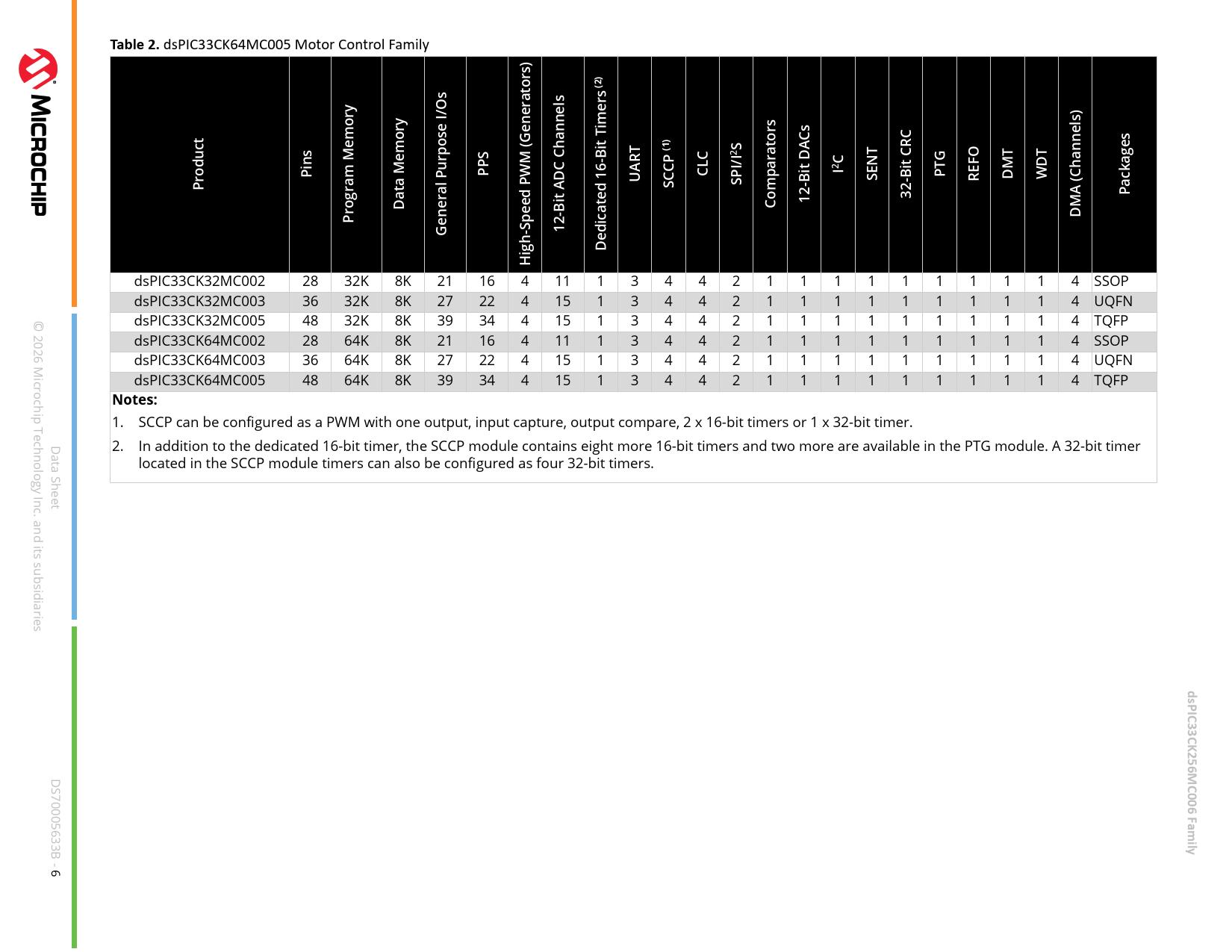

Table 2.
dsPIC33CK64MC005 Motor Control Family
(2) (1) S2 C Pins PPS CLC 2 I SENT PTG REFO DMT WDT Product UART SCCP SPI/I 32-Bit CRC Packages Data Memory Comparators 12-Bit DACs Program Memory DMA (Channels) General Purpose I/Os 12-Bit ADC Channels Dedicated 16-Bit Timers High-Speed PWM (Generators)
dsPIC33CK32MC002 28 32K 8K 21 16 4 11 1 3 4 4 2 1 1 1 1 1 1 1 1 1 4 SSOP dsPIC33CK32MC003 36 32K 8K 27 22 4 15 1 3 4 4 2 1 1 1 1 1 1 1 1 1 4 UQFN © 2026 Microchip Technology Inc. and its subsidiaries dsPIC33CK32MC005 48 32K 8K 39 34 4 15 1 3 4 4 2 1 1 1 1 1 1 1 1 1 4 TQFP dsPIC33CK64MC002 28 64K 8K 21 16 4 11 1 3 4 4 2 1 1 1 1 1 1 1 1 1 4 SSOP dsPIC33CK64MC003 36 64K 8K 27 22 4 15 1 3 4 4 2 1 1 1 1 1 1 1 1 1 4 UQFN dsPIC33CK64MC005 48 64K 8K 39 34 4 15 1 3 4 4 2 1 1 1 1 1 1 1 1 1 4 TQFP
Notes: 
rotatethispage90 1. SCCP can be configured as a PWM with one output, input capture, output compare, 2 x 16-bit timers or 1 x 32-bit timer.  Data Sheet 2. In addition to the dedicated 16-bit timer, the SCCP module contains eight more 16-bit timers and two more are available in the PTG module. A 32-bit timer located in the SCCP module timers can also be configured as four 32-bit timers.
