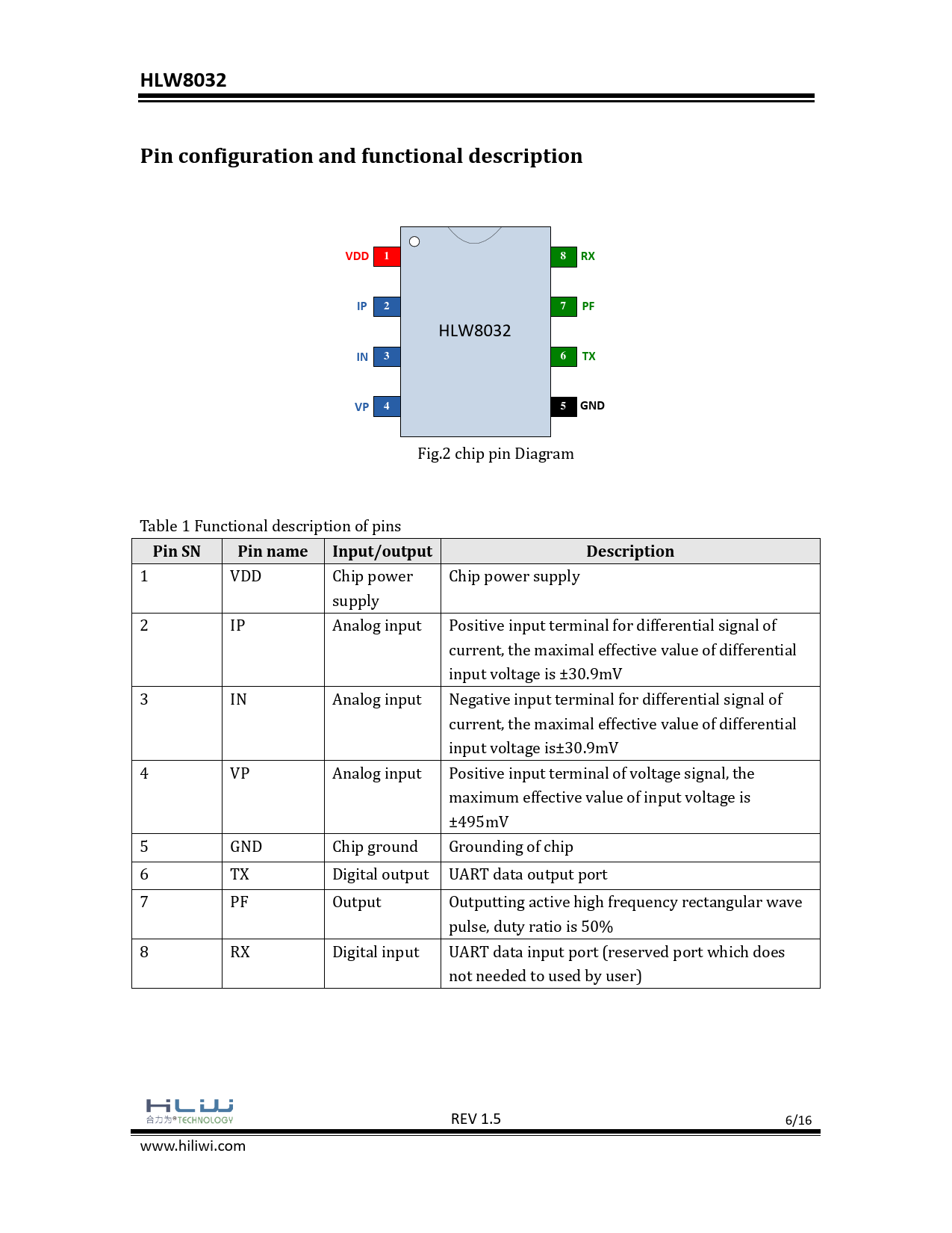

HLW8032. Pin configuration and functional description. VDD. GND. Pin SN. Pin name Input/output. Description
HLW8032 Pin configuration and functional description VDD GND Pin SN Pin name Input/output Description
HLW8032 Pin configuration and functional description VDD 1 8 RX IP 2 7 PF
CF HLW8032
IN 3 6 TX VP 4 5 GND
Fig.2 chip pin Diagram Table 1 Functional description of pins
1 VDD Chip power Chip power supply supply 2 IP Analog input Positive input terminal for differential signal of current, the maximal effective value of differential input voltage is ±30.9mV 3 IN Analog input Negative input terminal for differential signal of current, the maximal effective value of differential input voltage is±30.9mV 4 VP Analog input Positive input terminal of voltage signal, the maximum effective value of input voltage is ±495mV 5 GND Chip ground Grounding of chip 6 TX Digital output UART data output port 7 PF Output Outputting active high frequency rectangular wave pulse, duty ratio is 50% 8 RX Digital input UART data input port (reserved port which does not needed to used by user) REV 1.5 6/16 www.hiliwi.com
