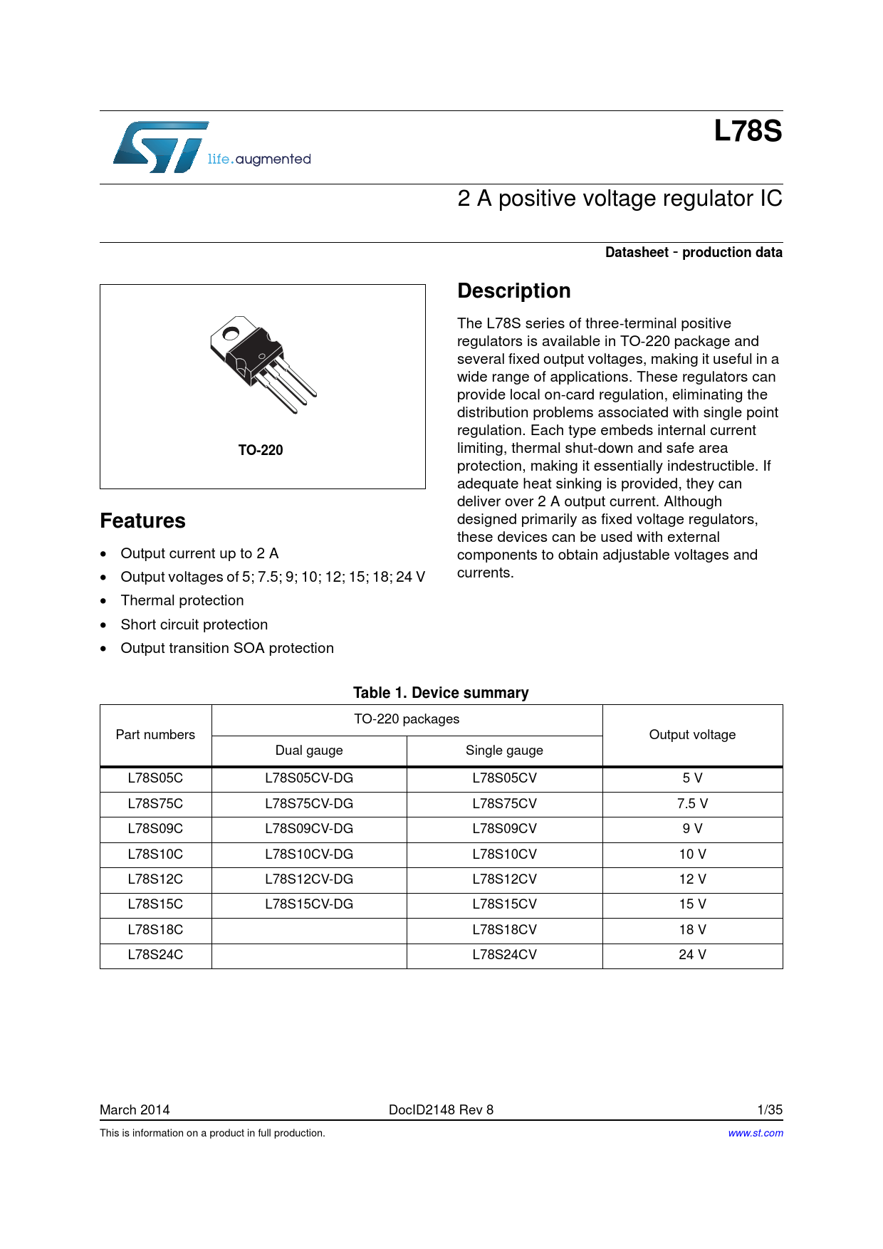

L78S
2 A positive voltage regulator IC
Datasheet
production data Description
The L78S series of three-terminal positive regulators is available in TO-220 package and several fixed output voltages, making it useful in a wide range of applications. These regulators can provide local on-card regulation, eliminating the distribution problems associated with single point regulation. Each type embeds internal current
TO-220
limiting, thermal shut-down and safe area protection, making it essentially indestructible. If adequate heat sinking is provided, they can deliver over 2 A output current. Although
Features
designed primarily as fixed voltage regulators, these devices can be used with external • Output current up to 2 A components to obtain adjustable voltages and • Output voltages of 5; 7.5; 9; 10; 12; 15; 18; 24 V currents. • Thermal protection • Short circuit protection • Output transition SOA protection
Table 1. Device summary
TO-220 packages Part numbers Output voltage Dual gauge Single gauge L78S05C L78S05CV-DG L78S05CV 5 V L78S75C L78S75CV-DG L78S75CV 7.5 V L78S09C L78S09CV-DG L78S09CV 9 V L78S10C L78S10CV-DG L78S10CV 10 V L78S12C L78S12CV-DG L78S12CV 12 V L78S15C L78S15CV-DG L78S15CV 15 V L78S18C L78S18CV 18 V L78S24C L78S24CV 24 V March 2014 DocID2148 Rev 8 1/35 This is information on a product in full production. www.st.com Document Outline Table 1. Device summary 1 Diagram Figure 1. Block diagram 2 Pin configuration Figure 2. Pin connections (top view) Figure 3. Schematic diagram 3 Maximum ratings Table 2. Absolute maximum ratings Table 3. Thermal data Figure 4. Application circuits 4 Test circuits Figure 5. DC parameter Figure 6. Load regulation Figure 7. Ripple rejection 5 Electrical characteristics Table 4. Electrical characteristics of L78S05C Table 5. Electrical characteristics of L78S75C Table 6. Electrical characteristics of L78S09C Table 7. Electrical characteristics of L78S10C Table 8. Electrical characteristics of L78S12C Table 9. Electrical characteristics of L78S15C Table 10. Electrical characteristics of L78S18C Table 11. Electrical characteristics of L78S24C 6 Typical performance Figure 8. Dropout voltage vs. junction temperature Figure 9. Peak output current vs. input/output differential voltage Figure 10. Output impedance vs. frequency Figure 11. Output voltage vs. junction temperature Figure 12. Supply voltage rejection vs. frequency Figure 13. Quiescent current vs. junction temperature Figure 14. Load transient response Figure 15. Line transient response Figure 16. Quiescent current vs. input voltage Figure 17. Fixed output regulator Figure 18. Constant current regulator Figure 19. Circuit for increasing output voltage Figure 20. Adjustable output regulator (7 to 30 V) Figure 21. 0.5 to 10 V regulator Figure 22. High current voltage regulator Figure 23. High output current with short circuit protection Figure 24. Tracking voltage regulator Figure 25. Positive and negative regulator Figure 26. Negative output voltage circuit Figure 27. Switching regulator Figure 28. High input voltage circuit Figure 29. High input voltage circuit Figure 30. High output voltage regulator Figure 31. High input and output voltage Figure 32. Reducing power dissipation with dropping resistor Figure 33. Remote shutdown Figure 34. Power AM modulator (unity voltage gain, IO £ 1 A) Figure 35. Adjustable output voltage with temperature compensation Figure 36. Light controllers (VOmin = VXX + VBE) Figure 37. Protection against input short-circuit with high capacitance loads 7 Package mechanical data Figure 38. TO-220 (dual gauge) drawing Table 12. TO-220 (dual gauge) mechanical data Figure 39. TO-220 SG (single gauge) drawing Table 13. TO-220 SG (single gauge) mechanical data 8 Packaging mechanical data Figure 40. Tube for TO-220 (dual gauge) (mm.) Figure 41. Tube for TO-220 (single gauge) (mm.) 9 Revision history Table 14. Document revision history
