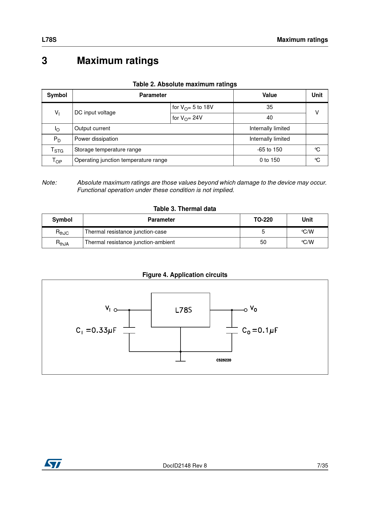

L78S. Maximum ratings. 3 Maximum. ratings. Table 2. Absolute maximum ratings. Symbol. Parameter. Value. Unit. Table 3. Thermal data. TO-220
L78S Maximum ratings 3 Maximum ratings Table 2 Absolute maximum ratings Symbol Parameter Value Unit Table 3 Thermal data TO-220
L78S Maximum ratings 3 Maximum ratings Table 2. Absolute maximum ratings Symbol Parameter Value Unit
for VO= 5 to 18V 35 VI DC input voltage V for VO= 24V 40 IO Output current Internally limited PD Power dissipation Internally limited TSTG Storage temperature range -65 to 150 °C TOP Operating junction temperature range 0 to 150 °C Note: Absolute maximum ratings are those values beyond which damage to the device may occur. Functional operation under these condition is not implied.
Table 3. Thermal data Symbol Parameter TO-220 Unit
RthJC Thermal resistance junction-case 5 °C/W RthJA Thermal resistance junction-ambient 50 °C/W
Figure 4. Application circuits
