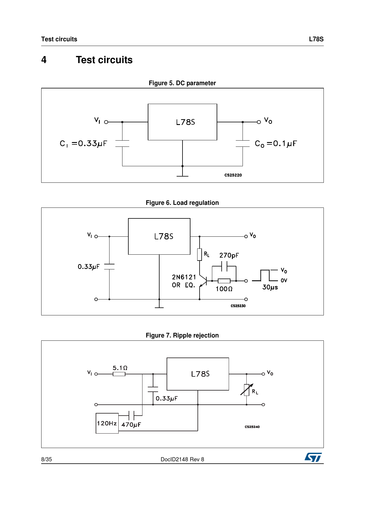

Pages / Page35 / 8 — Test circuits. L78S. 4 Test. circuits. Figure 5. DC parameter. Figure 6. …
Test circuits. L78S. 4 Test. circuits. Figure 5. DC parameter. Figure 6. Load regulation. Figure 7. Ripple rejection
Test circuits L78S 4 Test circuits Figure 5 DC parameter Figure 6 Load regulation Figure 7 Ripple rejection
Test circuits L78S 4 Test circuits Figure 5. DC parameter
4
4
