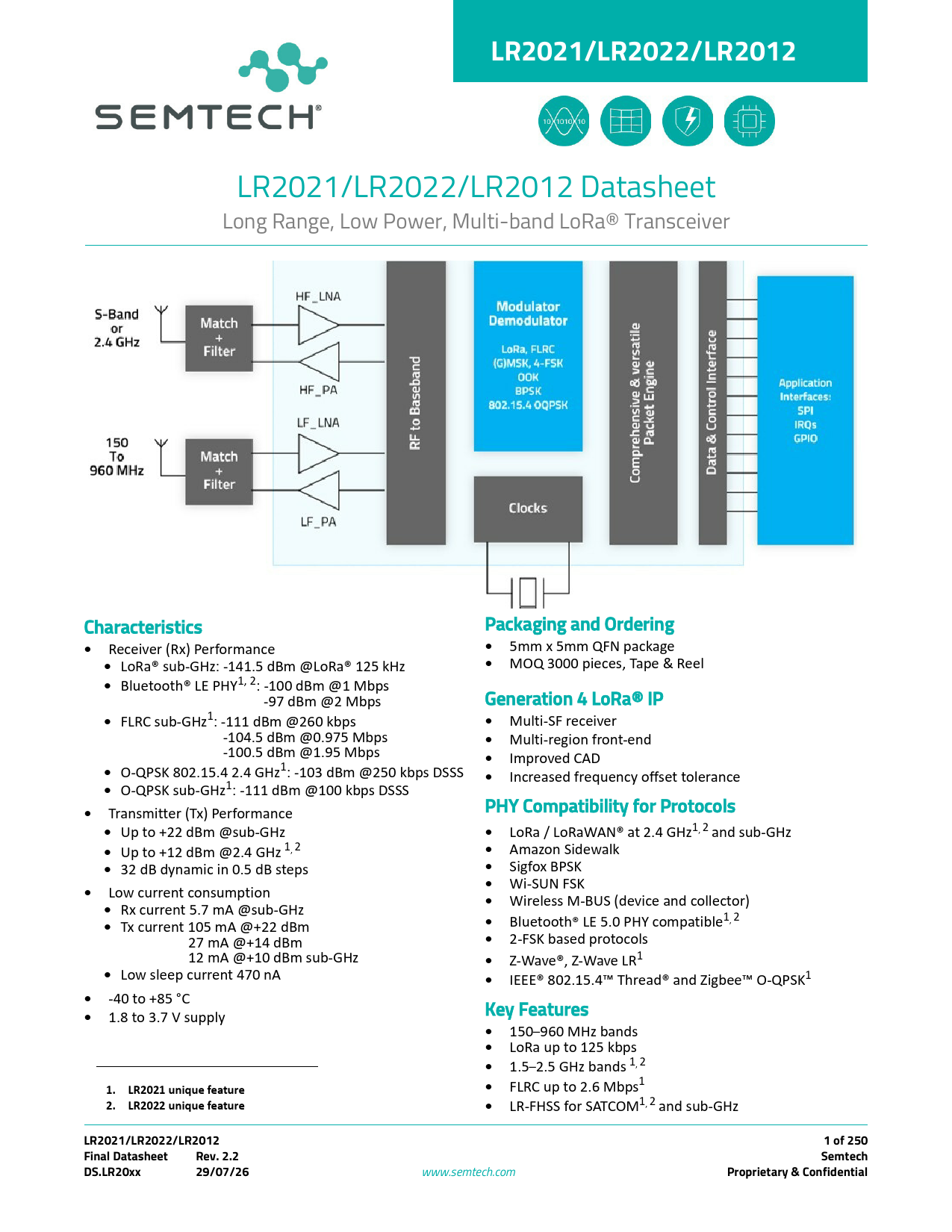

LR2021/LR2022/LR2012. Characteristics. Packaging and Ordering. Generation 4 LoRa® IP. PHY Compatibility for Protocols
link to page 1 link to page 250 link to page 1 link to page 1 link to page 1 link to page 1 link to page 1 link to page 1 link to page 1 link to page 1 link to page 1 link to page 1 link to page 1 link to page 1 link to page 1 link to page 1 link to page 1
LR2021/LR2022/LR2012 Datasheet Long Range, Low Power, Multi-band LoRa® Transceiver
Characteristics Packaging and Ordering •
Receiver (Rx) Performance
5mm x 5mm QFN package
LoRa® sub-GHz: -141.5 dBm @LoRa® 125 kHz
MOQ 3000 pieces, Tape & Reel
Bluetooth® LE PHY1, 2: -100 dBm @1 Mbps -97 dBm @2 Mbps
Generation 4 LoRa® IP •
FLRC sub-GHz1: -111 dBm @260 kbps
Multi-SF receiver -104.5 dBm @0.975 Mbps
Multi-region front-end -100.5 dBm @1.95 Mbps
Improved CAD
O-QPSK 802.15.4 2.4 GHz1: -103 dBm @250 kbps DSSS
Increased frequency offset tolerance
O-QPSK sub-GHz1: -111 dBm @100 kbps DSSS
Transmitter (Tx) Performance
PHY Compatibility for Protocols •
Up to +22 dBm @sub-GHz
LoRa / LoRaWAN® at 2.4 GHz1, 2 and sub-GHz
Up to +12 dBm @2.4 GHz 1, 2
Amazon Sidewalk
32 dB dynamic in 0.5 dB steps
Sigfox BPSK
Low current consumption
Wi-SUN FSK
Rx current 5.7 mA @sub-GHz
Wireless M-BUS (device and col ector)
Tx current 105 mA @+22 dBm
Bluetooth® LE 5.0 PHY compatible1, 2 27 mA @+14 dBm
2-FSK based protocols 12 mA @+10 dBm sub-GHz
Z-Wave®, Z-Wave LR1
Low sleep current 470 nA
IEEE® 802.15.4™ Thread® and Zigbee™ O-QPSK1
-40 to +85 °C
1.8 to 3.7 V supply
Key Features •
150–960 MHz bands
LoRa up to 125 kbps
1.5–2.5 GHz bands 1, 2
1. LR2021 unique feature •
FLRC up to 2.6 Mbps1
2. LR2022 unique feature •
LR-FHSS for SATCOM1, 2 and sub-GHz
LR2021/LR2022/LR2012 1 of 250 Final Datasheet Rev. 2.2 Semtech DS.LR20xx 29/07/26
www.semtech.com
Proprietary & Confidential
