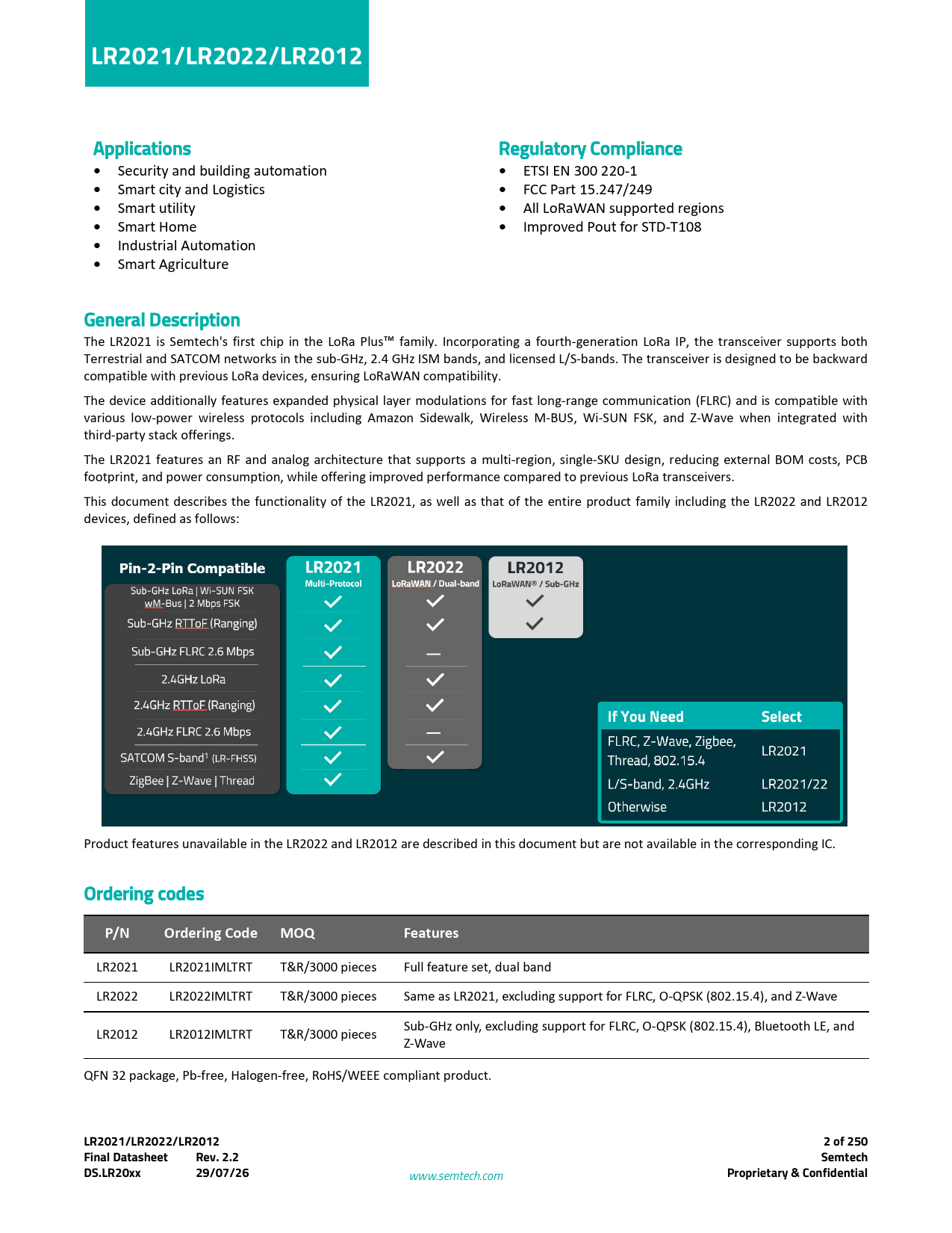

LR2021/LR2022/LR2012. Applications. Regulatory Compliance. General Description. Ordering codes. P/N. Ordering Code. MOQ. Features
LR2021/LR2022/LR2012 Applications Regulatory Compliance General Description Ordering codes P/N Ordering Code MOQ Features
link to page 250
Security and building automation
ETSI EN 300 220-1
Smart city and Logistics
FCC Part 15.247/249
Smart utility
Al LoRaWAN supported regions
Smart Home
Improved Pout for STD-T108
Industrial Automation
Smart Agriculture
General Description
The LR2021 is Semtech's first chip in the LoRa Plus™ family. Incorporating a fourth-generation LoRa IP, the transceiver supports both Terrestrial and SATCOM networks in the sub-GHz, 2.4 GHz ISM bands, and licensed L/S-bands. The transceiver is designed to be backward compatible with previous LoRa devices, ensuring LoRaWAN compatibility. The device additional y features expanded physical layer modulations for fast long-range communication (FLRC) and is compatible with various low-power wireless protocols including Amazon Sidewalk, Wireless M-BUS, Wi-SUN FSK, and Z-Wave when integrated with third-party stack offerings. The LR2021 features an RF and analog architecture that supports a multi-region, single-SKU design, reducing external BOM costs, PCB footprint, and power consumption, while offering improved performance compared to previous LoRa transceivers. This document describes the functionality of the LR2021, as wel as that of the entire product family including the LR2022 and LR2012 devices, defined as fol ows: Product features unavailable in the LR2022 and LR2012 are described in this document but are not available in the corresponding IC.
LR2021 LR2021IMLTRT T&R/3000 pieces Ful feature set, dual band LR2022 LR2022IMLTRT T&R/3000 pieces Same as LR2021, excluding support for FLRC, O-QPSK (802.15.4), and Z-Wave LR2012 LR2012IMLTRT T&R/3000 pieces Sub-GHz only, excluding support for FLRC, O-QPSK (802.15.4), Bluetooth LE, and Z-Wave QFN 32 package, Pb-free, Halogen-free, RoHS/WEEE compliant product.
