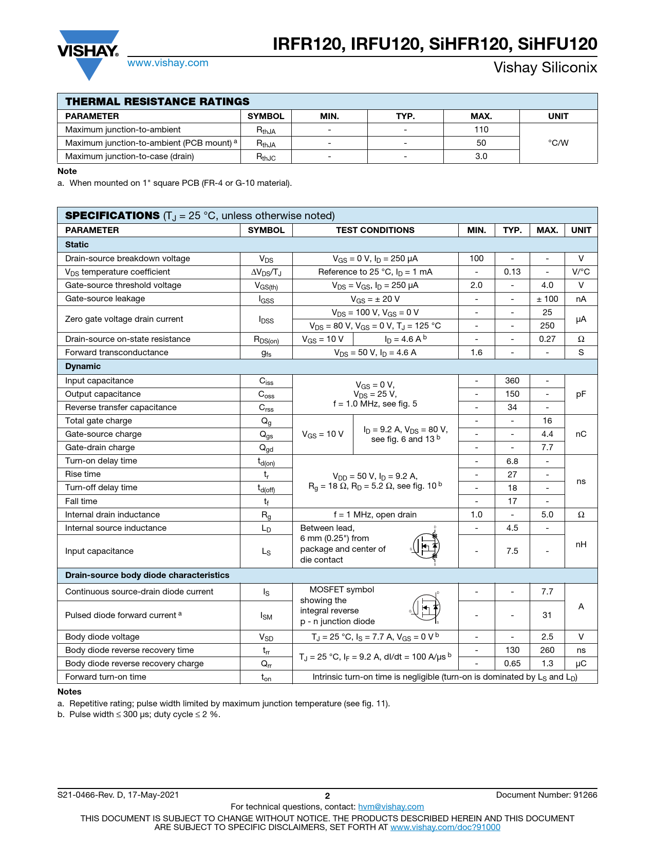

IRFR120, IRFU120, SiHFR120, SiHFU120. THERMAL RESISTANCE RATINGS PARAMETER SYMBOL. MIN. TYP. MAX. UNIT. Note. SPECIFICATIONS
IRFR120, IRFU120, SiHFR120, SiHFU120 THERMAL RESISTANCE RATINGS PARAMETER SYMBOL MIN TYP MAX UNIT Note SPECIFICATIONS
THERMAL RESISTANCE RATINGS PARAMETER SYMBOL MIN. TYP. MAX. UNIT
Maximum junction-to-ambient RthJA - - 110 Maximum junction-to-ambient (PCB mount) a RthJA - - 50 °C/W Maximum junction-to-case (drain) RthJC - - 3.0
Note
a. When mounted on 1" square PCB (FR-4 or G-10 material).
SPECIFICATIONS
(TJ = 25 °C, unless otherwise noted)
PARAMETER SYMBOL TEST CONDITIONS MIN. TYP. MAX. UNIT Static
Drain-source breakdown voltage VDS VGS = 0 V, ID = 250 μA 100 - - V VDS temperature coefficient ΔVDS/TJ Reference to 25 °C, ID = 1 mA - 0.13 - V/°C Gate-source threshold voltage VGS(th) VDS = VGS, ID = 250 μA 2.0 - 4.0 V Gate-source leakage IGSS VGS = ± 20 V - - ± 100 nA VDS = 100 V, VGS = 0 V - - 25 Zero gate voltage drain current IDSS μA VDS = 80 V, VGS = 0 V, TJ = 125 °C - - 250 Drain-source on-state resistance RDS(on) VGS = 10 V ID = 4.6 A b - - 0.27 Ω Forward transconductance gfs VDS = 50 V, ID = 4.6 A 1.6 - - S
Dynamic
Input capacitance Ciss V - 360 - GS = 0 V, Output capacitance Coss VDS = 25 V, - 150 - pF f = 1.0 MHz, see fig. 5 Reverse transfer capacitance Crss - 34 - Total gate charge Qg - - 16 I Gate-source charge Qgs V D = 9.2 A, VDS = 80 V, GS = 10 V - - 4.4 nC see fig. 6 and 13 b Gate-drain charge Qgd - - 7.7 Turn-on delay time td(on) - 6.8 - Rise time tr V - 27 - DD = 50 V, ID = 9.2 A, ns R Turn-off delay time t g = 18 Ω, RD = 5.2 Ω, see fig. 10 b d(off) - 18 - Fall time tf - 17 - Internal drain inductance Rg f = 1 MHz, open drain 1.0 - 5.0 Ω Internal source inductance L D D Between lead, - 4.5 - 6 mm (0.25") from nH package and center of Input capacitance L G S - 7.5 - die contact S
Drain-source body diode characteristics
Continuous source-drain diode current I MOSFET symbol S D - - 7.7 showing the A integral reverse G Pulsed diode forward current a ISM - - 31 p - n junction diode S Body diode voltage VSD TJ = 25 °C, IS = 7.7 A, VGS = 0 V b - - 2.5 V Body diode reverse recovery time trr - 130 260 ns TJ = 25 °C, IF = 9.2 A, dI/dt = 100 A/μs b Body diode reverse recovery charge Qrr - 0.65 1.3 μC Forward turn-on time ton Intrinsic turn-on time is negligible (turn-on is dominated by LS and LD)
Notes
a. Repetitive rating; pulse width limited by maximum junction temperature (see fig. 11). b. Pulse width ≤ 300 μs; duty cycle ≤ 2 %. S21-0466-Rev. D, 17-May-2021
