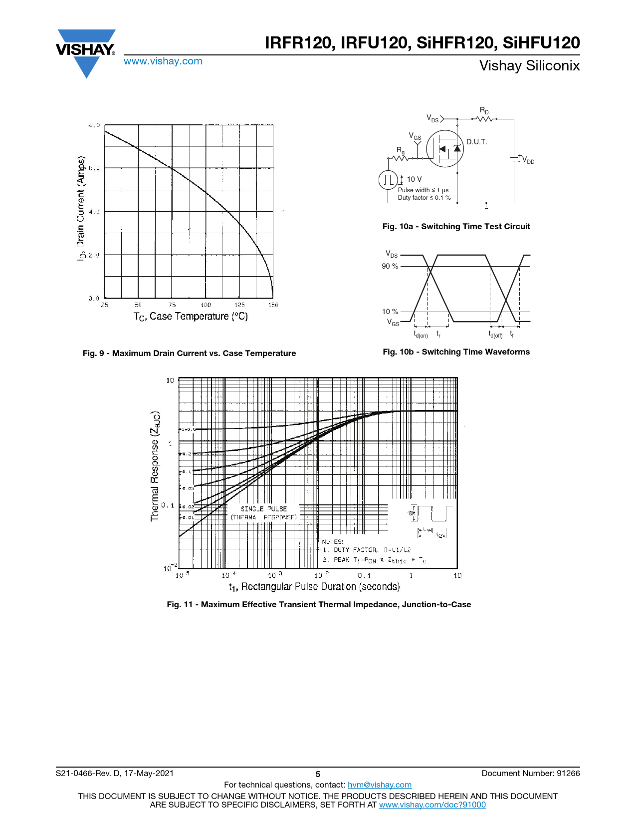

Pages / Page13 / 5 — IRFR120, IRFU120, SiHFR120, SiHFU120. Fig. 10a - Switching Time Test …
File Format / SizePDF / 851 Kb
IRFR120, IRFU120, SiHFR120, SiHFU120. Fig. 10a - Switching Time Test Circuit
IRFR120, IRFU120, SiHFR120, SiHFU120 Fig 10a - Switching Time Test Circuit
www.vishay.com Vishay Siliconix RD VDS VGS D.U.T. Rg + - VDD 10 V Pulse width ≤ 1 µs Duty factor ≤ 0.1 %
VDS 90 % 10 % VGS t t t t d(on) r d(off) f
Fig. 9 - Maximum Drain Current vs. Case Temperature Fig. 10b - Switching Time Waveforms Fig. 11 - Maximum Effective Transient Thermal Impedance, Junction-to-Case
