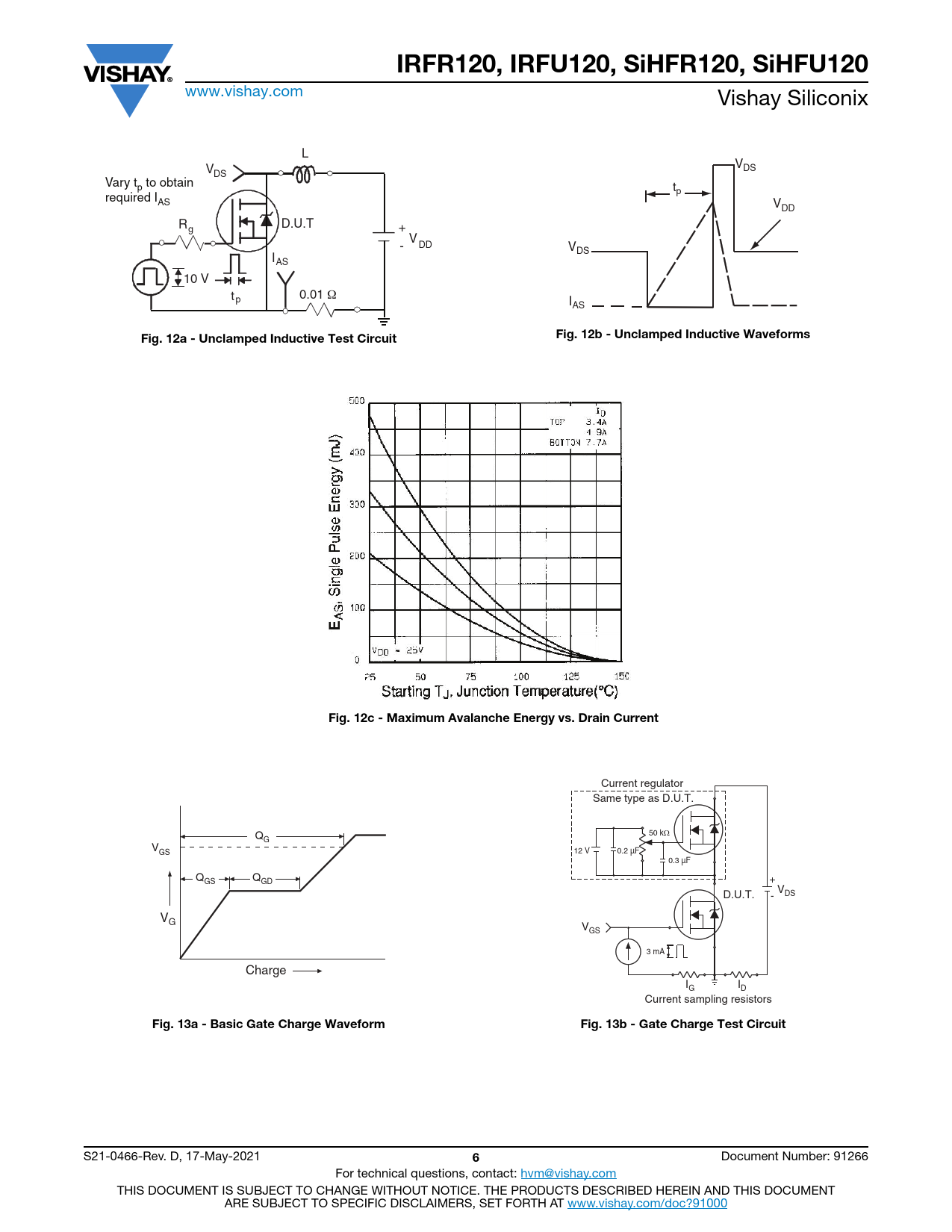

IRFR120, IRFU120, SiHFR120, SiHFU120. Fig. 12a - Unclamped Inductive Test Circuit. Fig. 12b - Unclamped Inductive Waveforms
IRFR120, IRFU120, SiHFR120, SiHFU120 Fig 12a - Unclamped Inductive Test Circuit Fig 12b - Unclamped Inductive Waveforms
www.vishay.com Vishay Siliconix L V VDS DS Vary tp to obtain tp required IAS VDD R D.U.T g + V - DD VDS IAS 10 V t 0.01 p Ω IAS
Fig. 12a - Unclamped Inductive Test Circuit Fig. 12b - Unclamped Inductive Waveforms Fig. 12c - Maximum Avalanche Energy vs. Drain Current
Current regulator Same type as D.U.T. Q 50 kΩ G VGS 12 V 0.2 µF 0.3 µF Q Q GS GD + V D.U.T. DS - VG VGS 3 mA Charge I I G D Current sampling resistors
Fig. 13a - Basic Gate Charge Waveform Fig. 13b - Gate Charge Test Circuit
