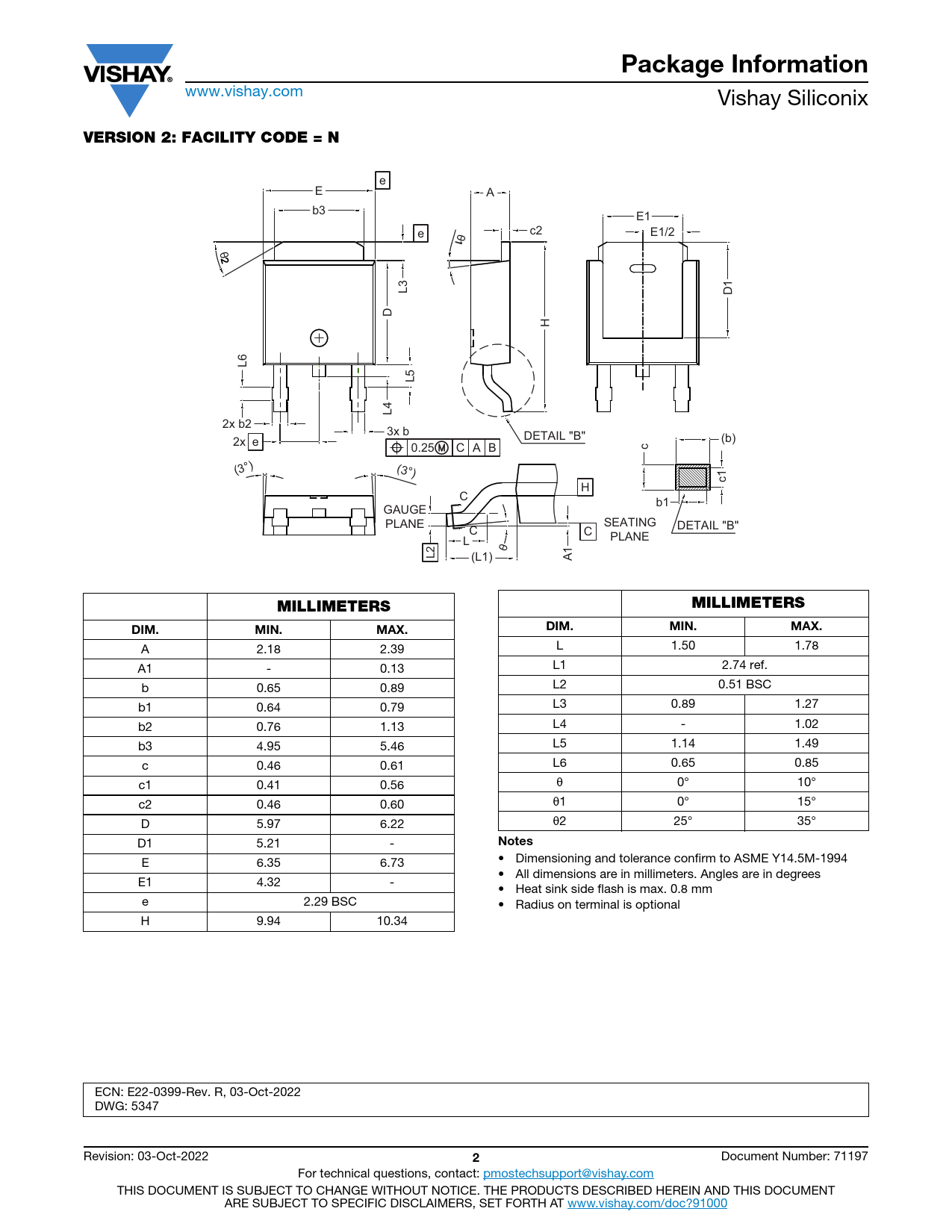

Package Information. VERSION 2: FACILITY CODE = N. MILLIMETERS. DIM. MIN. MAX. Notes
Package Information VERSION 2: FACILITY CODE = N MILLIMETERS DIM MIN MAX Notes
Package Information
e E A b3 E1 θ e c2 E1/2 θ L3 D1 D H L6 L5 L4 2x b2 3x b 2x e DETAIL "B" (b) 0.25 C A B c (3°) (3°) c1 H C b1 GAUGE PLANE SEATING C C DETAIL "B" L PLANE L2 θ (L1) A1
MILLIMETERS MILLIMETERS DIM. MIN. MAX. DIM. MIN. MAX.
A 2.18 2.39 L 1.50 1.78 A1 - 0.13 L1 2.74 ref. b 0.65 0.89 L2 0.51 BSC b1 0.64 0.79 L3 0.89 1.27 b2 0.76 1.13 L4 - 1.02 b3 4.95 5.46 L5 1.14 1.49 c 0.46 0.61 L6 0.65 0.85 c1 0.41 0.56  0° 10° c2 0.46 0.60 1 0° 15° D 5.97 6.22 2 25° 35°
Notes
D1 5.21 - • Dimensioning and tolerance confirm to ASME Y14.5M-1994 E 6.35 6.73 • All dimensions are in millimeters. Angles are in degrees E1 4.32 - • Heat sink side flash is max. 0.8 mm e 2.29 BSC • Radius on terminal is optional H 9.94 10.34      ECN: E22-0399-Rev. R, 03-Oct-2022 DWG: 5347 Revision: 03-Oct-2022
