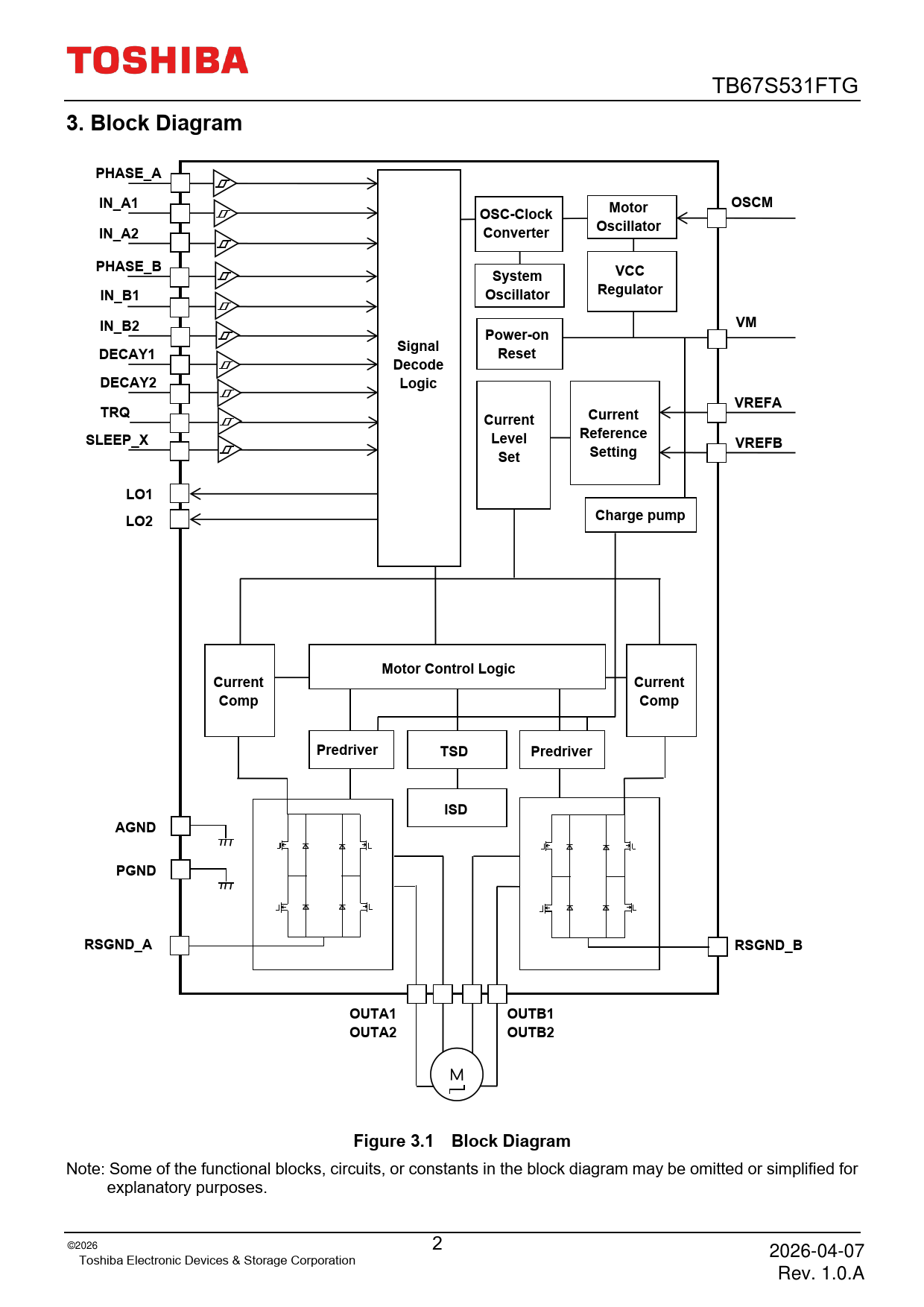

3. Block Diagram. PHASE_A. IN_A1. Motor. OSCM. OSC-Clock. IN_A2. Oscillator. Converter. PHASE_B. VCC. System. Regulator. IN_B1. IN_B2. Power-on. Signal
3 Block Diagram PHASE_A IN_A1 Motor OSCM OSC-Clock IN_A2 Oscillator Converter PHASE_B VCC System Regulator IN_B1 IN_B2 Power-on Signal
TB67S531FTG
3. Block Diagram PHASE_A IN_A1 Motor OSCM OSC-Clock IN_A2 Oscillator Converter PHASE_B VCC System Regulator IN_B1 Oscillator IN_B2 VM Power-on Signal DECAY1 Reset Decode DECAY2 Logic VREFA TRQ Current Current Reference SLEEP_X Level VREFB Setting Set LO1 LO2 Charge pump Motor Control Logic Current Current Comp Comp Predriver TSD Predriver ISD AGND PGND RSGND_A RSGND_B OUTA1 OUTB1 OUTA2 OUTB2 Figure 3.1 Block Diagram
