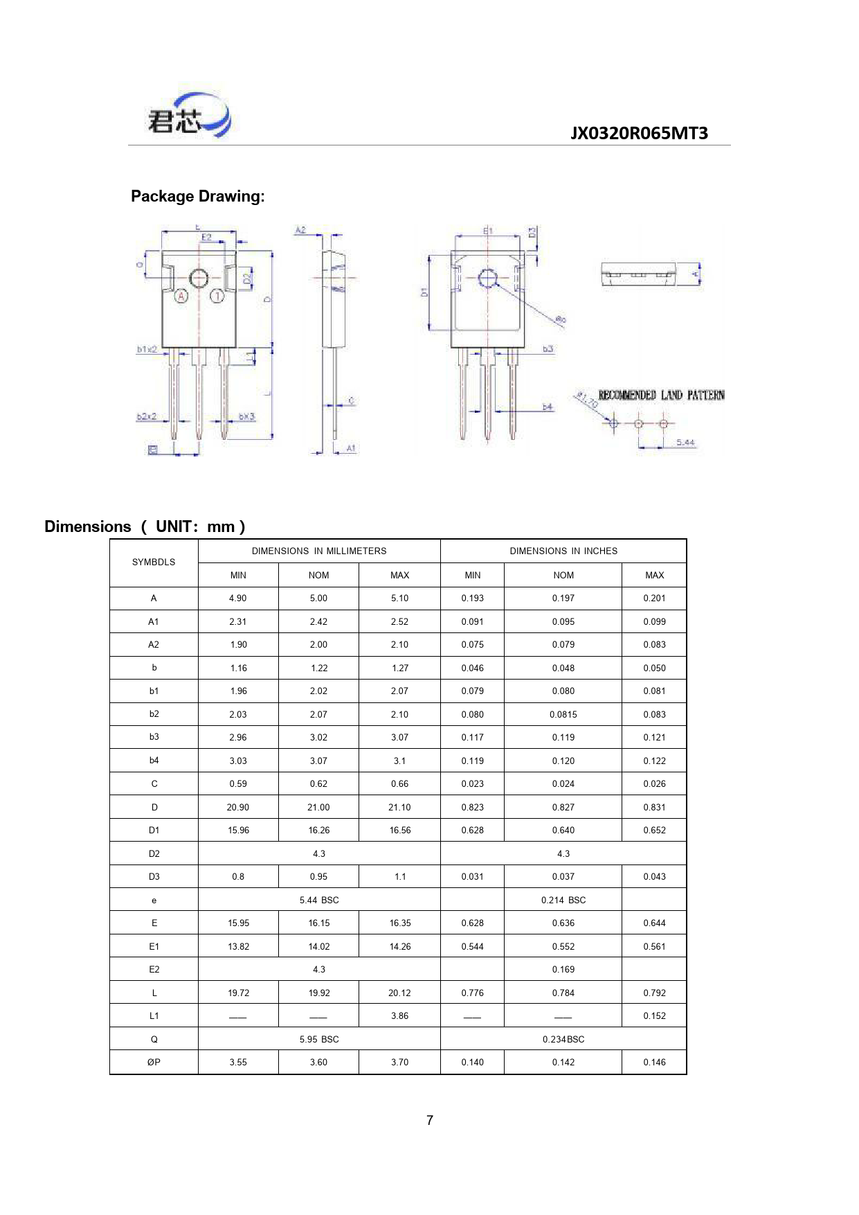

JX0320R065MT3. Package Drawing:. Dimensions( UNIT:mm )
JX0320R065MT3 Package Drawing: Dimensions( UNIT:mm )
DIMENSIONS IN MILLIMETERS DIMENSIONS IN INCHES SYMBDLS MIN NOM MAX MIN NOM MAX A 4.90 5.00 5.10 0.193 0.197 0.201 A1 2.31 2.42 2.52 0.091 0.095 0.099 A2 1.90 2.00 2.10 0.075 0.079 0.083 b 1.16 1.22 1.27 0.046 0.048 0.050 b1 1.96 2.02 2.07 0.079 0.080 0.081 b2 2.03 2.07 2.10 0.080 0.0815 0.083 b3 2.96 3.02 3.07 0.117 0.119 0.121 b4 3.03 3.07 3.1 0.119 0.120 0.122 C 0.59 0.62 0.66 0.023 0.024 0.026 D 20.90 21.00 21.10 0.823 0.827 0.831 D1 15.96 16.26 16.56 0.628 0.640 0.652 D2 4.3 4.3 D3 0.8 0.95 1.1 0.031 0.037 0.043 e 5.44 BSC 0.214 BSC E 15.95 16.15 16.35 0.628 0.636 0.644 E1 13.82 14.02 14.26 0.544 0.552 0.561 E2 4.3 0.169 L 19.72 19.92 20.12 0.776 0.784 0.792 L1 —— —— 3.86 —— —— 0.152 Q 5.95 BSC 0.234BSC ØP 3.55 3.60 3.70 0.140 0.142 0.146 7 Document Outline Description The values are based on the junction-to case therm 0 2 4 6 16 14 10 6 2 Fig5. Transfer Characteristic Fig7.Threshold Voltage vs. Temperature 0 5 Fig9. 3rd Quadrant Characteristic at 25 oC -10 -8 -6 -2 5 Fig11. Capacitances vs. Drain-Source Fig13. Switching Energy vs. Drain Current Fig15. Switching Energy vs. Temperature Fig17.Transient Thermal Impedance Fig16. Switching Times vs. RG(ext) Package Drawing:
