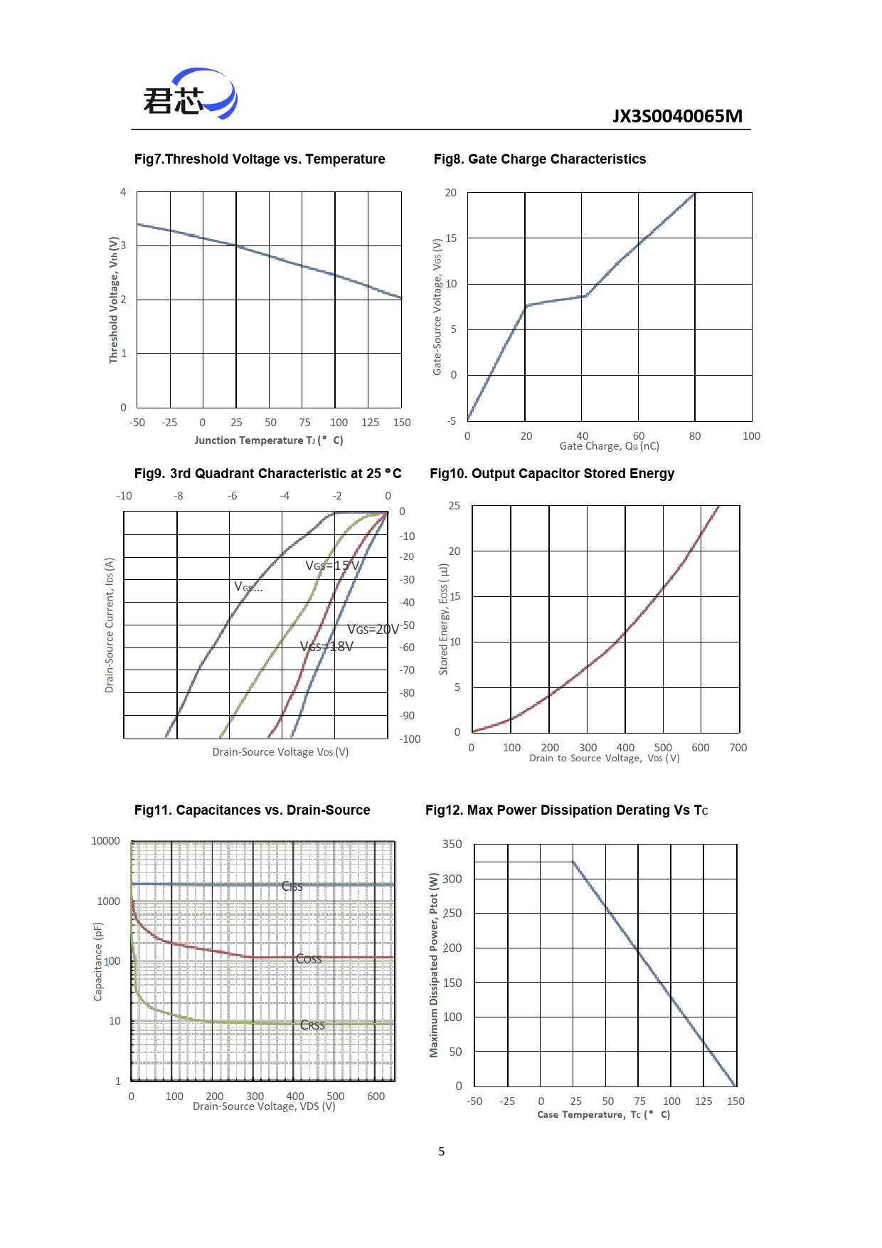

Description650V N-Channel MOSFET in TO247-3 package
Pages / Page7 / 5 — JX3S0040065M. Fig7.Threshold Voltage vs. Temperature. Fig8. Gate Charge …

JX3S0040065M. Fig7.Threshold Voltage vs. Temperature. Fig8. Gate Charge Characteristics. Junction Temperature TJ ( C)
JX3S0040065M Fig7.Threshold Voltage vs Temperature Fig8 Gate Charge Characteristics Junction Temperature TJ ( C)
JX3S0040065M Fig7.Threshold Voltage vs. Temperature Fig8. Gate Charge Characteristics
4 20 15 3 10 2 5 1 0 0 -50 -25 0 25 50 75 100 125 150 -5
0 20 40 60 80 100 Gate Charge, QG (nC)
Fig9. 3rd Quadrant Characteristic at 25 C Fig10. Output Capacitor Stored Energy
-10 -8 -6 -4 -2 0 0 25 -10 -20 20 VGS=15V -30 VGS… -40 15 VGS=20V-50 VGS=18V -60 10 -70 -80 5 -90 -100 0 Drain-Source Voltage VDS (V) 0 100 200 300 400 500 600 700 Drain to Source Voltage, VDS (V)
Fig11. Capacitances vs. Drain-Source Fig12. Max Power Dissipation Derating Vs TC
10000 350 C 300 ISS 1000 250 200 100 COSS 150 10 C 100 RSS 50 1 0 0 100 200 300 400 500 600 Drain-Source Voltage, VDS (V) -50 -25 0 25 50 75 100 125 150
Case Temperature, TC ( C)
