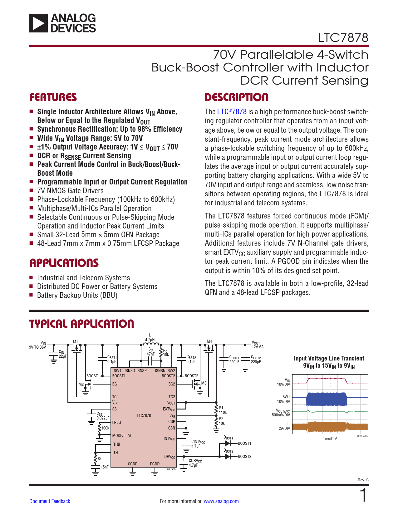

LTC7878 70V Parallelable 4-Switch Buck-Boost Controller with Inductor DCR Current Sensing
FEATURES DESCRIPTION
n
Single Inductor Architecture Allows VIN Above,
The LTC®7878 is a high performance buck-boost switch-
Below or Equal to the Regulated VOUT
ing regulator controller that operates from an input volt- n
Synchronous Rectification: Up to 98% Efficiency
age above, below or equal to the output voltage. The con- n
Wide VIN Voltage Range: 5V to 70V
stant-frequency, peak current mode architecture allows n
±1% Output Voltage Accuracy: 1V ≤ VOUT ≤ 70V
a phase-lockable switching frequency of up to 600kHz, n
DCR or RSENSE Current Sensing
while a programmable input or output current loop regu- n
Peak Current Mode Control in Buck/Boost/Buck-
lates the average input or output current accurately sup-
Boost Mode
porting battery charging applications. With a wide 5V to n
Programmable Input or Output Current Regulation
70V input and output range and seamless, low noise tran- n 7V NMOS Gate Drivers sitions between operating regions, the LTC7878 is ideal n Phase-Lockable Frequency (100kHz to 600kHz) for industrial and telecom systems. n Multiphase/Multi-ICs Parallel Operation n Selectable Continuous or Pulse-Skipping Mode The LTC7878 features forced continuous mode (FCM)/ Operation and Inductor Peak Current Limits pulse-skipping mode operation. It supports multiphase/ n Small 32-Lead 5mm × 5mm QFN Package multi-ICs parallel operation for high power applications. n 48-Lead 7mm x 7mm x 0.75mm LFCSP Package Additional features include 7V N-Channel gate drivers, smart EXTVCC auxiliary supply and programmable induc- tor peak current limit. A PGOOD pin indicates when the
APPLICATIONS
output is within 10% of its designed set point. n Industrial and Telecom Systems n The LTC7878 is available in both a low-profile, 32-lead Distributed DC Power or Battery Systems n QFN and a 48-lead LFCSP packages. Battery Backup Units (BBU)
TYPICAL APPLICATION
L V M1 4.7µH M4 V IN OUT 9V TO 36V 12V, 6A C CC R IN C 22µF 47nF 10k C C BST1 BST2 COUT1 COUT2
