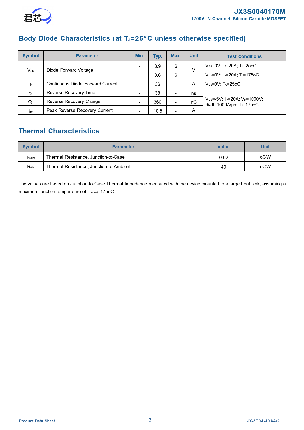

JX3S0040170M. 1700V, N-Channel, Silicon Carbide MOSFET. Body Diode Characteristics (at TJ=25°C unless otherwise specified)
JX3S0040170M 1700V, N-Channel, Silicon Carbide MOSFET Body Diode Characteristics (at TJ=25°C unless otherwise specified)
JX3S0040170M 1700V, N-Channel, Silicon Carbide MOSFET Body Diode Characteristics (at TJ=25°C unless otherwise specified) Symbol Parameter Min. Typ. Max. Unit Test Conditions
- 3.9 6 VGS=0V; IF=20A; TJ=25oC VSD Diode Forward Voltage V - 3.6 6 VGS=0V; IF=20A; TJ=175oC IS Continuous Diode Forward Current - 36 - A VGS=0V; TC=25oC trr Reverse Recovery Time - 38 - ns VGS=-5V; IF=20A; VR=1000V; Qrr Reverse Recovery Charge - 360 - nC di/dt=1000A/μs; TJ=175oC Irrm Peak Reverse Recovery Current - 10.5 - A
Thermal Characteristics Symbol Parameter Value Unit
RθJC Thermal Resistance, Junction-to-Case 0.62 oC/W RθJA Thermal Resistance, Junction-to-Ambient 40 oC/W The values are based on Junction-to-Case Thermal Impedance measured with the device mounted to a large heat sink, assuming a maximum junction temperature of TJ(max)=175oC.
