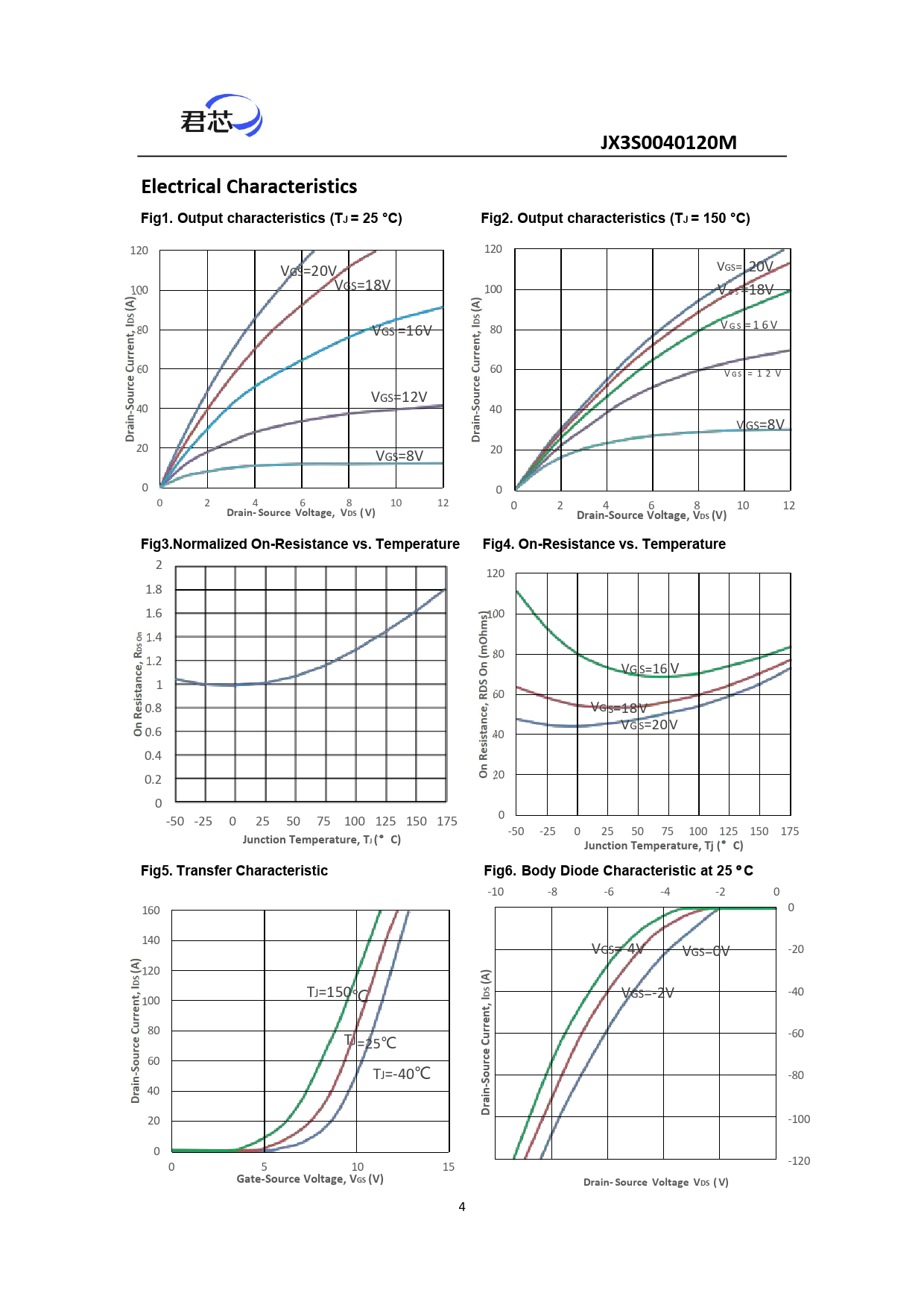

JX3S0040120M. Electrical Characteristics Fig1. Output characteristics (TJ = 25 °C)
JX3S0040120M Electrical Characteristics Fig1 Output characteristics (TJ = 25 °C)
JX3S0040120M Electrical Characteristics Fig1. Output characteristics (TJ = 25 °C) Fig2. Output characteristics (TJ = 150 °C)
120 120 VGS= 20V VGS=20V 100 VGS=18V 100 VG S =18V 80 VGS =16V 80 VGS = 1 6 V 60 60 V G S = 1 2 V VGS=12V 40 40 V GS=8V 20 20 VGS=8V 0 0 0 2 4 6 8 10 12
Drain- Source Voltage, V
0 2 4 6 8 10 12
DS (V) Drain-Source Voltage, VDS (V) Fig3.Normalized On-Resistance vs. Temperature Fig4. On-Resistance vs. Temperature
2 120 1.8 1.6 100 1.4 1.2 80 VG S=16 V 1 60 0.8 VGS=18V 0.6 VGS=20V 40 0.4 0.2 20 0 -50 -25 0 25 50 75 100 125 150 175 0 -50 -25 0 25 50 75 100 125 150 175
Junction Temperature, TJ( C) Junction Temperature, Tj ( C) Fig5. Transfer Characteristic Fig6. Body Diode Characteristic at 25 C
-10 -8 -6 -4 -2 0 160 0 140 VGS=-4V VGS=0V -20 120
(A)
T ℃ VGS=-2V -40 100 J=150 80 TJ=25℃
Current,IDS
-60 60 TJ=-40℃ -80 40
Drain-Source
20 -100 0 0 5 10 15 -120
Gate-Source Voltage, VGS (V) Drain- Source Voltage VDS ( V)
