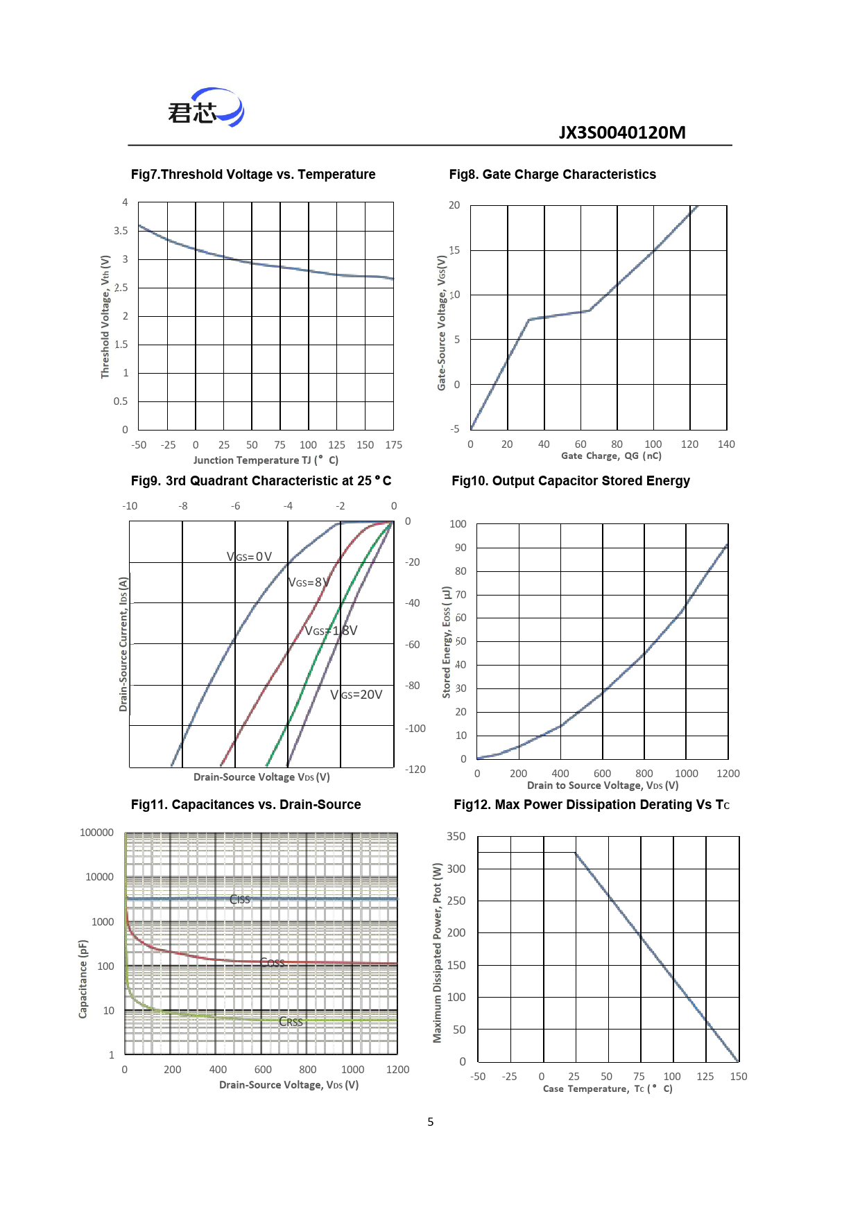

Description1200V N-Channel SiC MOSFET in TO-247 package
Pages / Page7 / 5 — JX3S0040120M. Fig7.Threshold Voltage vs. Temperature. Fig8. Gate Charge …
File Format / SizePDF / 568 Kb
JX3S0040120M. Fig7.Threshold Voltage vs. Temperature. Fig8. Gate Charge Characteristics. Junction Temperature TJ ( C)
JX3S0040120M Fig7.Threshold Voltage vs Temperature Fig8 Gate Charge Characteristics Junction Temperature TJ ( C)
JX3S0040120M Fig7.Threshold Voltage vs. Temperature Fig8. Gate Charge Characteristics
4 20 3.5 15 3 2.5 10 2 5 1.5 1 0 0.5 0 -5 -50 -25 0 25 50 75 100 125 150 175 0 20 40 60 80 100 120 140
Junction Temperature TJ ( C) Gate Charge, QG (nC) Fig9. 3rd Quadrant Characteristic at 25 C Fig10. Output Capacitor Stored Energy
-10 -8 -6 -4 -2 0 0 100 90 VGS=0V -20 80 VGS=8V 70 -40 60 VGS=1 8V -60 50 40 V -80 30 GS=20V 20 -100 10 0
Drain-Source Voltage V
-120
DS (V)
0 200 400 600 800 1000 1200
Drain to Source Voltage, VDS (V) Fig11. Capacitances vs. Drain-Source Fig12. Max Power Dissipation Derating Vs TC
100000 350 300 10000 CISS 250 1000 200 100 COSS 150 100 10 CRSS 50 1 0 0 200 400 600 800 1000 1200 -50 -25 0 25 50 75 100 125 150
Drain-Source Voltage, VDS (V) Case Temperature, TC ( C)
