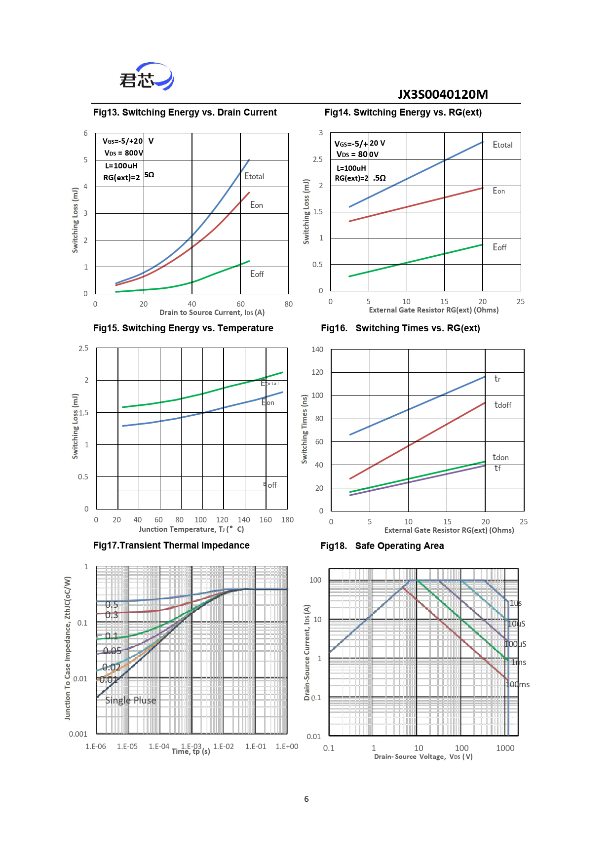

JX3S0040120M. Fig13. Switching Energy vs. Drain Current. Fig14. Switching Energy vs. RG(ext). VGS=-5/+20 V. VGS=-5/+ 20 V
JX3S0040120M Fig13 Switching Energy vs Drain Current Fig14 Switching Energy vs RG(ext) VGS=-5/+20 V VGS=-5/+ 20 V
JX3S0040120M Fig13. Switching Energy vs. Drain Current Fig14. Switching Energy vs. RG(ext)
6 3
Etotal
VDS = 800V V
5 2.5
DS = 80 0V L=100uH L=100uH RG(ext)=2 5Ω
Etotal
RG(ext)=2 .5Ω
4 2 Eon Eon 3 1.5 2 1 Eoff 1 0.5 Eoff 0 0 0 20 40 60 80 0 5 10 15 20 25
Drain to Source Current, IDS (A) External Gate Resistor RG(ext) (Ohms) Fig15. Switching Energy vs. Temperature Fig16. Switching Times vs. RG(ext)
2.5 140 120 2 tr E ottal E 100 on tdoff 1.5 80 1 60 tdon 40 tf 0.5 E off 20 0 0 0 20 40 60 80 100 120 140 160 180 0 5 10 15 20 25
Junction Temperature, TJ ( C) External Gate Resistor RG(ext) (Ohms) Fig17.Transient Thermal Impedance Fig18. Safe Operating Area
1 100 0.5 1us 0.3 0.1 10 10uS 0.1 0.05 100uS 1 0.02 1ms 0.01 0.01 100ms Single Pluse 0.1 0.001 0.01 1.E-06 1.E-05 1.E-04 1.E-03 1.E-02 1.E-01 1.E+00 0.1 1 10 100 1000
Time, tp (s) Drain- Source Voltage, VDS (V)
