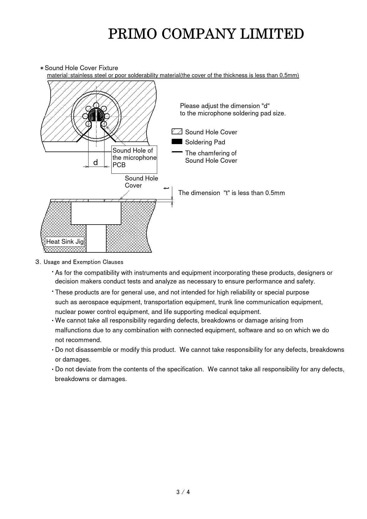

PRIMO. COMPANY. LIMITED. *Sound. Hole. Cover. Fixture. material:stainless. steel. or. poor. solderability. material(the. cover. of. the. thickness. is
PRIMO COMPANY LIMITED *Sound Hole Cover Fixture material:stainless steel or poor solderability material(the cover of the thickness is
PRIMO COMPANY LIMITED *Sound Hole Cover Fixture material:stainless steel or poor solderability material(the cover of the thickness is less than 0.5mm) Please adjust the dimension "d" to the microphone soldering pad size. Sound Hole Cover Soldering Pad Sound Hole of The chamfering of the microphone Sound Hole Cover d PCB Sound Hole Cover t The dimension "t" is less than 0.5mm Heat Sink Jig 3.Usage and Exemption Clauses ・ As for the compatibility with instruments and equipment incorporating these products, designers or decision makers conduct tests and analyze as necessary to ensure performance and safety. ・ These products are for general use, and not intended for high reliability or special purpose such as aerospace equipment, transportation equipment, trunk line communication equipment, nuclear power control equipment, and life supporting medical equipment. ・ We cannot take all responsibility regarding defects, breakdowns or damage arising from malfunctions due to any combination with connected equipment, software and so on which we do not recommend. ・ Do not disassemble or modify this product. We cannot take responsibility for any defects, breakdowns or damages. ・ Do not deviate from the contents of the specification. We cannot take all responsibility for any defects, breakdowns or damages. 3 / 4
