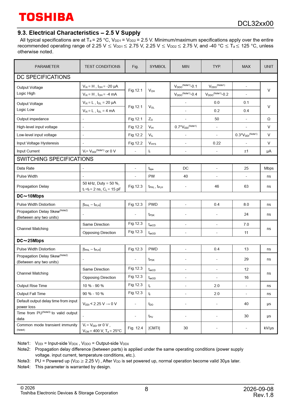

9.3. Electrical Characteristics – 2.5 V Supply
All typical specifications are at Ta = 25 °C, VDD1 = VDD2 = 2.5 V. Minimum/maximum specifications apply over the entire recommended operating range of 2.25 V ≤ VDD1 ≤ 2.75 V, 2.25 V ≤ VDD2 ≤ 2.75 V, and -40 °C ≤ Ta ≤ 125 °C, unless otherwise noted. PARAMETER TEST CONDITIONS Fig. SYMBOL MIN TYP. MAX UNIT DC SPECIFICATIONS Output Voltage V (Note1) (Note1) IX = H , IOH = -20 μA VDDO -0.1 VDDO - Fig.12.1 V V Logic High OH V (Note1) (Note1) IX = H , IOH = -4 mA VDDO -0.4 VDDO -0.2 - Output Voltage VIX = L , IOL = 20 μA - 0.0 0.1 Fig.12.1 V V Logic Low OL VIX = L , IOL = 4 mA - 0.2 0.4 Output impedance - Fig.12.1 ZO - 50 - Ω High-level input voltage - Fig.12.2 V (Note1) IH 0.7*VDDI - - V Low-level input voltage - Fig.12.2 V (Note1) IL - - 0.3*VDDI V Input Voltage Hysteresis - Fig.12.2 VHYS - 0.22 - V Input Current V (Note1) I= VDDI or 0 V - II - - ±1 μA SWITCHING SPECIFICATIONS Data Rate - - tbps DC - 25 Mbps Pulse Width - - PW 40 - - ns 50 kHz, Duty = 50 %, Propagation Delay Fig.12.3 t t PHL , tPLH - 46 63 ns r =tf = 2 ns, CL = 15 pF
DC
10Mbps
Pulse Width Distortion |tPHL – tPLH| Fig.12.3 PWD - 0.4 8.0 ns Propagation Delay Skew(Note2) - - t (Between any two units) PSK - - 24 ns Same Direction Fig.12.3 tskCD - - 7.0 Channel Matching ns Opposing Direction Fig.12.3 tskOD - - 11
DC
25Mbps
Pulse Width Distortion |tPHL – tPLH| Fig.12.3 PWD - 0.4 13 ns Propagation Delay Skew(Note2) - - t (Between any two units) PSK - - 29 ns Same Direction Fig.12.3 tskCD - - 12 Channel Matching ns Opposing Direction Fig.12.3 tskOD - - 16 Output Rise Time 10 % - 90 % Fig.12.3 tr - 2.0 - ns Output Fall Time 90 % - 10 % Fig.12.3 tf - 2.0 - ns Default output delay time from input V power loss DDI < 2.25 V → 0 V - tDO - - 40 μs Time from PU(Note3) to valid output - - t data PU - - 30 μs Common mode transient immunity VI = VDDI or 0 V , Fig. 12.4 |CMTI| 30 - - kV/μs (Note4) VCM = 400 V, Ta = 25°C Note1: VDDI = Input-side VDDX , VDDO = Output-side VDDX Note2: Propagation delay difference (between parts) is applied under the same operating conditions (power supply voltage. input current, temperature conditions, etc.). Note3: PU = Powered up (VDD ≥ 2.25 V) , After VDD is set powered up, normal operation become valid 30μs later. Note4: This parameter is warranted by design. © 2 0 2 6 8 2026-09-08 Toshiba Electronic Devices & Storage Corporation Rev.1.8
