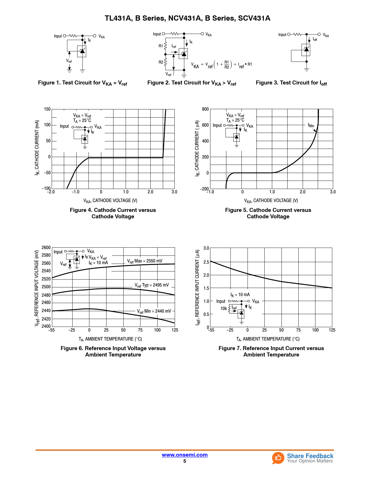

TL431A, B Series, NCV431A, B Series, SCV431A. Figure 1. Test Circuit for VKA = Vref
TL431A, B Series, NCV431A, B Series, SCV431A Figure 1 Test Circuit for VKA = Vref
Input V Input VKA Input V KA KA I I K I off K R1 Iref Vref R2 V + V ǒ1 ) R1Ǔ ) I SR1 KA ref R2 ref Vref
Figure 1. Test Circuit for VKA = Vref Figure 2. Test Circuit for VKA > Vref Figure 3. Test Circuit for Ioff
150 800 V V KA = Vref KA = Vref T T A = 25°C A = 25°C 100 A) 600 Input V μ Input V I KA Min (mA) KA ( IK IK 50 400 0 200 THODE CURRENT THODE CURRENT , CA -50 , CA I K 0 I K -100 -200 -2.0 -1.0 0 1.0 2.0 3.0 -1.0 0 1.0 2.0 3.0 V V KA, CATHODE VOLTAGE (V) KA, CATHODE VOLTAGE (V)
Figure 4. Cathode Current versus Figure 5. Cathode Current versus Cathode Voltage Cathode Voltage
2600 3.0 V Input KA A) 2580 I μ K VKA = Vref ( V V I ref Max = 2550 mV 2.5 2560 K = 10 mA ref TAGE (mV) 2540 2.0 VOL 2520 CURRENT 2500 Vref Typ = 2495 mV 1.5 2480 IK = 10 mA 1.0 2460 Input VKA I I 10k ref K 2440 Vref Min = 2440 mV 0.5 , REFERENCE INPUT 2420 , REFERENCE INPUT refV I ref 2400 0 -55 -25 0 25 50 75 100 125 -55 -25 0 25 50 75 100 125 T T A, AMBIENT TEMPERATURE (°C) A, AMBIENT TEMPERATURE (°C)
Figure 6. Reference Input Voltage versus Figure 7. Reference Input Current versus Ambient Temperature Ambient Temperature www.onsemi.com Share Feedback 5
