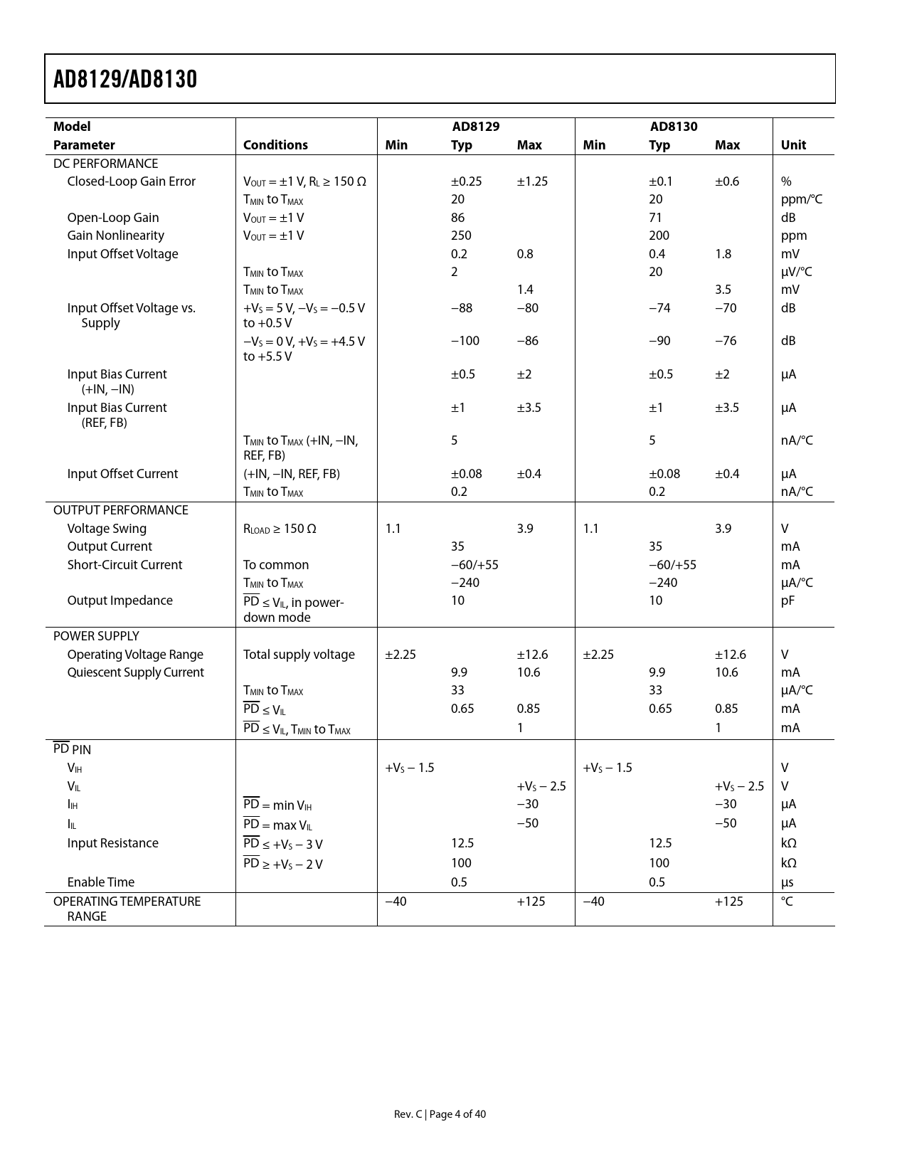

AD8129/AD8130. Model. AD8129 AD8130. Parameter. Conditions. Min Typ Max Min Typ Max Unit
AD8129/AD8130 Model AD8129 AD8130 Parameter Conditions Min Typ Max Min Typ Max Unit
DC PERFORMANCE Closed-Loop Gain Error VOUT = ±1 V, RL ≥ 150 Ω ±0.25 ±1.25 ±0.1 ±0.6 % TMIN to TMAX 20 20 ppm/°C Open-Loop Gain VOUT = ±1 V 86 71 dB Gain Nonlinearity VOUT = ±1 V 250 200 ppm Input Offset Voltage 0.2 0.8 0.4 1.8 mV TMIN to TMAX 2 20 μV/°C TMIN to TMAX 1.4 3.5 mV Input Offset Voltage vs. +VS = 5 V, −VS = −0.5 V −88 −80 −74 −70 dB Supply to +0.5 V −VS = 0 V, +VS = +4.5 V −100 −86 −90 −76 dB to +5.5 V Input Bias Current ±0.5 ±2 ±0.5 ±2 μA (+IN, −IN) Input Bias Current ±1 ±3.5 ±1 ±3.5 μA (REF, FB) TMIN to TMAX (+IN, −IN, 5 5 nA/°C REF, FB) Input Offset Current (+IN, −IN, REF, FB) ±0.08 ±0.4 ±0.08 ±0.4 μA TMIN to TMAX 0.2 0.2 nA/°C OUTPUT PERFORMANCE Voltage Swing RLOAD ≥ 150 Ω 1.1 3.9 1.1 3.9 V Output Current 35 35 mA Short-Circuit Current To common −60/+55 −60/+55 mA TMIN to TMAX −240 −240 μA/°C Output Impedance PD ≤ VIL, in power- 10 10 pF down mode POWER SUPPLY Operating Voltage Range Total supply voltage ±2.25 ±12.6 ±2.25 ±12.6 V Quiescent Supply Current 9.9 10.6 9.9 10.6 mA TMIN to TMAX 33 33 μA/°C PD ≤ VIL 0.65 0.85 0.65 0.85 mA PD ≤ VIL, TMIN to TMAX 1 1 mA PD PIN VIH +VS − 1.5 +VS − 1.5 V VIL +VS − 2.5 +VS − 2.5 V IIH PD = min VIH −30 −30 μA IIL PD = max VIL −50 −50 μA Input Resistance PD ≤ +VS − 3 V 12.5 12.5 kΩ PD ≥ +VS − 2 V 100 100 kΩ Enable Time 0.5 0.5 μs OPERATING TEMPERATURE −40 +125 −40 +125 °C RANGE Rev. C | Page 4 of 40 Document Outline FEATURES APPLICATIONS CONNECTION DIAGRAM GENERAL DESCRIPTION TABLE OF CONTENTS REVISION HISTORY AD8129/AD8130 SPECIFICATIONS 5 V SPECIFICATIONS ±5 V SPECIFICATIONS ±12 V SPECIFICATIONS ABSOLUTE MAXIMUM RATINGS THERMAL RESISTANCE Maximum Power Dissipation ESD CAUTION TYPICAL PERFORMANCE CHARACTERISTICS AD8130 FREQUENCY RESPONSE CHARACTERISTICS AD8129 FREQUENCY RESPONSE CHARACTERISTICS AD8130 HARMONIC DISTORTION CHARACTERISTICS AD8129 HARMONIC DISTORTION CHARACTERISTICS AD8130 TRANSIENT RESPONSE CHARACTERISTICS AD8129 TRANSIENT RESPONSE CHARACTERISTICS THEORY OF OPERATION OP AMP CONFIGURATION APPLICATIONS BASIC GAIN CIRCUITS TWISTED-PAIR CABLE, COMPOSITE VIDEO RECEIVER WITH EQUALIZATION USING AN AD8130 OUTPUT OFFSET/LEVEL TRANSLATOR RESISTORLESS GAIN OF 2 SUMMER CABLE-TAP AMPLIFIER POWER-DOWN EXTREME OPERATING CONDITIONS POWER DISSIPATION LAYOUT, GROUNDING, AND BYPASSING OUTLINE DIMENSIONS ORDERING GUIDE
