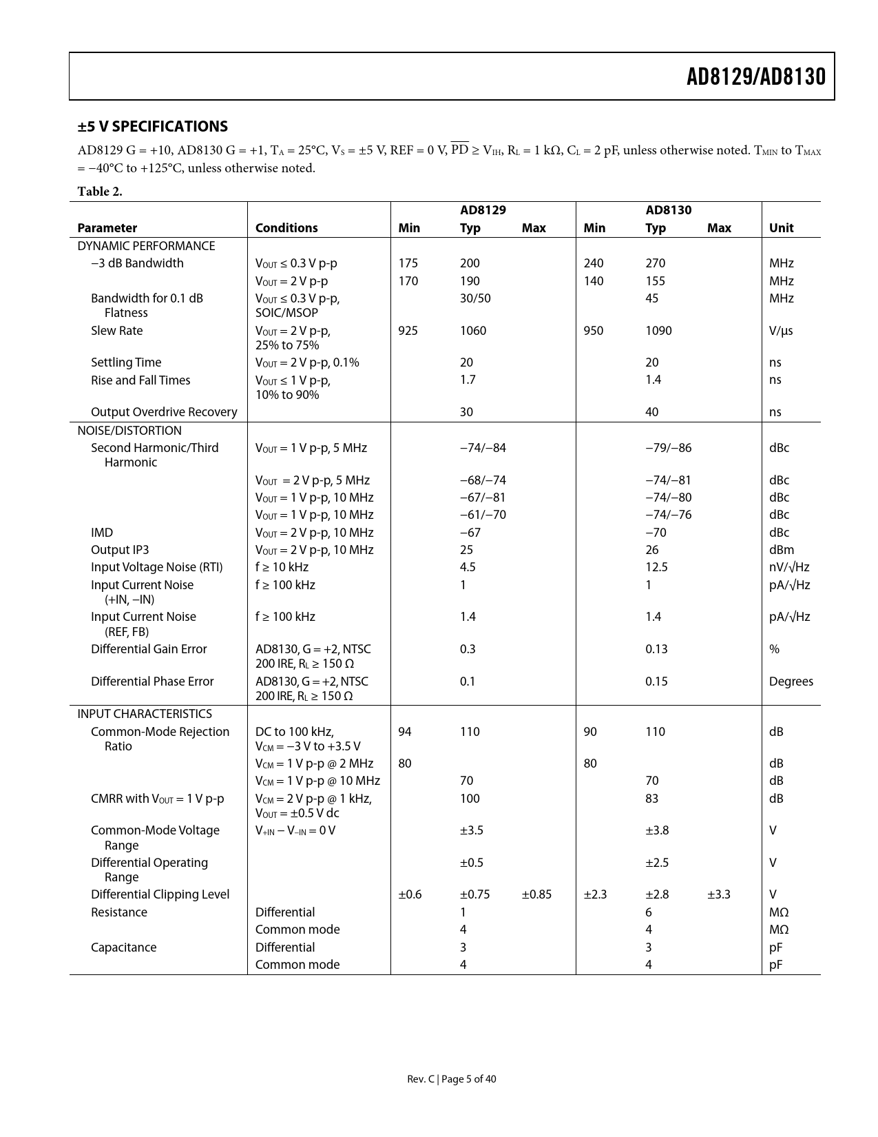

AD8129/AD8130. ±5 V SPECIFICATIONS. Table 2. AD8129. AD8130. Parameter. Conditions. Min Typ Max Min Typ Max Unit
AD8129/AD8130 ±5 V SPECIFICATIONS Table 2 AD8129 AD8130 Parameter Conditions Min Typ Max Min Typ Max Unit
AD8129 G = +10, AD8130 G = +1, TA = 25°C, VS = ±5 V, REF = 0 V, PD ≥ VIH, RL = 1 kΩ, CL = 2 pF, unless otherwise noted. TMIN to TMAX = −40°C to +125°C, unless otherwise noted.
Table 2. AD8129 AD8130 Parameter Conditions Min Typ Max Min Typ Max Unit
DYNAMIC PERFORMANCE −3 dB Bandwidth VOUT ≤ 0.3 V p-p 175 200 240 270 MHz VOUT = 2 V p-p 170 190 140 155 MHz Bandwidth for 0.1 dB VOUT ≤ 0.3 V p-p, 30/50 45 MHz Flatness SOIC/MSOP Slew Rate VOUT = 2 V p-p, 925 1060 950 1090 V/μs 25% to 75% Settling Time VOUT = 2 V p-p, 0.1% 20 20 ns Rise and Fall Times VOUT ≤ 1 V p-p, 1.7 1.4 ns 10% to 90% Output Overdrive Recovery 30 40 ns NOISE/DISTORTION Second Harmonic/Third VOUT = 1 V p-p, 5 MHz −74/−84 −79/−86 dBc Harmonic VOUT = 2 V p-p, 5 MHz −68/−74 −74/−81 dBc VOUT = 1 V p-p, 10 MHz −67/−81 −74/−80 dBc VOUT = 1 V p-p, 10 MHz −61/−70 −74/−76 dBc IMD VOUT = 2 V p-p, 10 MHz −67 −70 dBc Output IP3 VOUT = 2 V p-p, 10 MHz 25 26 dBm Input Voltage Noise (RTI) f ≥ 10 kHz 4.5 12.5 nV/√Hz Input Current Noise f ≥ 100 kHz 1 1 pA/√Hz (+IN, −IN) Input Current Noise f ≥ 100 kHz 1.4 1.4 pA/√Hz (REF, FB) Differential Gain Error AD8130, G = +2, NTSC 0.3 0.13 % 200 IRE, RL ≥ 150 Ω Differential Phase Error AD8130, G = +2, NTSC 0.1 0.15 Degrees 200 IRE, RL ≥ 150 Ω INPUT CHARACTERISTICS Common-Mode Rejection DC to 100 kHz, 94 110 90 110 dB Ratio VCM = −3 V to +3.5 V VCM = 1 V p-p @ 2 MHz 80 80 dB VCM = 1 V p-p @ 10 MHz 70 70 dB CMRR with VOUT = 1 V p-p VCM = 2 V p-p @ 1 kHz, 100 83 dB VOUT = ±0.5 V dc Common-Mode Voltage V+IN − V−IN = 0 V ±3.5 ±3.8 V Range Differential Operating ±0.5 ±2.5 V Range Differential Clipping Level ±0.6 ±0.75 ±0.85 ±2.3 ±2.8 ±3.3 V Resistance Differential 1 6 MΩ Common mode 4 4 MΩ Capacitance Differential 3 3 pF Common mode 4 4 pF Rev. C | Page 5 of 40 Document Outline FEATURES APPLICATIONS CONNECTION DIAGRAM GENERAL DESCRIPTION TABLE OF CONTENTS REVISION HISTORY AD8129/AD8130 SPECIFICATIONS 5 V SPECIFICATIONS ±5 V SPECIFICATIONS ±12 V SPECIFICATIONS ABSOLUTE MAXIMUM RATINGS THERMAL RESISTANCE Maximum Power Dissipation ESD CAUTION TYPICAL PERFORMANCE CHARACTERISTICS AD8130 FREQUENCY RESPONSE CHARACTERISTICS AD8129 FREQUENCY RESPONSE CHARACTERISTICS AD8130 HARMONIC DISTORTION CHARACTERISTICS AD8129 HARMONIC DISTORTION CHARACTERISTICS AD8130 TRANSIENT RESPONSE CHARACTERISTICS AD8129 TRANSIENT RESPONSE CHARACTERISTICS THEORY OF OPERATION OP AMP CONFIGURATION APPLICATIONS BASIC GAIN CIRCUITS TWISTED-PAIR CABLE, COMPOSITE VIDEO RECEIVER WITH EQUALIZATION USING AN AD8130 OUTPUT OFFSET/LEVEL TRANSLATOR RESISTORLESS GAIN OF 2 SUMMER CABLE-TAP AMPLIFIER POWER-DOWN EXTREME OPERATING CONDITIONS POWER DISSIPATION LAYOUT, GROUNDING, AND BYPASSING OUTLINE DIMENSIONS ORDERING GUIDE
