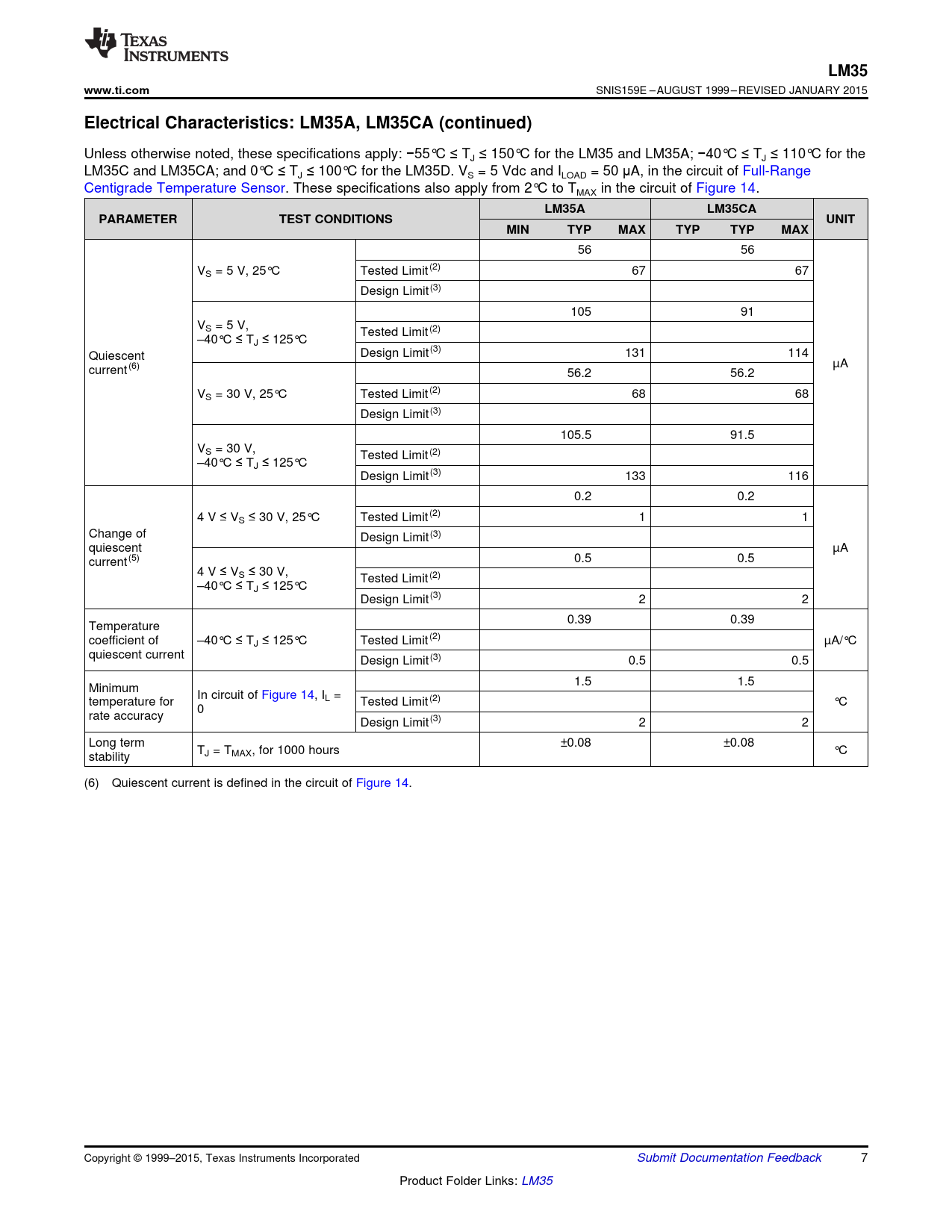

LM35. www.ti.com. Electrical Characteristics: LM35A, LM35CA (continued). LM35A. LM35CA. PARAMETER. TEST CONDITIONS. UNIT. MIN. TYP. MAX
link to page 1 link to page 1 link to page 15 link to page 15 link to page 15
LM35 www.ti.com
SNIS159E – AUGUST 1999 – REVISED JANUARY 2015
Unless otherwise noted, these specifications apply: −55°C ≤ TJ ≤ 150°C for the LM35 and LM35A; −40°C ≤ TJ ≤ 110°C for the LM35C and LM35CA; and 0°C ≤ TJ ≤ 100°C for the LM35D. VS = 5 Vdc and ILOAD = 50 μA, in the circuit of Full-Range Centigrade Temperature Sensor. These specifications also apply from 2°C to TMAX in the circuit of Figure 14.
LM35A LM35CA PARAMETER TEST CONDITIONS UNIT MIN TYP MAX TYP TYP MAX
56 56 VS = 5 V, 25°C Tested Limit(2) 67 67 Design Limit(3) 105 91 VS = 5 V, Tested Limit(2) –40°C ≤ TJ ≤ 125°C Design Limit(3) 131 114 Quiescent µA current(6) 56.2 56.2 VS = 30 V, 25°C Tested Limit(2) 68 68 Design Limit(3) 105.5 91.5 VS = 30 V, Tested Limit(2) –40°C ≤ TJ ≤ 125°C Design Limit(3) 133 116 0.2 0.2 4 V ≤ VS ≤ 30 V, 25°C Tested Limit(2) 1 1 Change of Design Limit(3) quiescent µA 0.5 0.5 current(5) 4 V ≤ VS ≤ 30 V, Tested Limit(2) –40°C ≤ TJ ≤ 125°C Design Limit(3) 2 2 0.39 0.39 Temperature coefficient of –40°C ≤ TJ ≤ 125°C Tested Limit(2) µA/°C quiescent current Design Limit(3) 0.5 0.5 1.5 1.5 Minimum In circuit of Figure 14, IL = temperature for Tested Limit(2) °C 0 rate accuracy Design Limit(3) 2 2 Long term ±0.08 ±0.08 TJ = TMAX, for 1000 hours °C stability (6) Quiescent current is defined in the circuit of Figure 14. Copyright © 1999–2015, Texas Instruments Incorporated Submit Documentation Feedback 7 Product Folder Links: LM35 Document Outline 1 Features 2 Applications 3 Description Table of Contents 4 Revision History 5 Pin Configuration and Functions 6 Specifications 6.1 Absolute Maximum Ratings 6.2 ESD Ratings 6.3 Recommended Operating Conditions 6.4 Thermal Information 6.5 Electrical Characteristics: LM35A, LM35CA Limits 6.6 Electrical Characteristics: LM35A, LM35CA 6.7 Electrical Characteristics: LM35, LM35C, LM35D Limits 6.8 Electrical Characteristics: LM35, LM35C, LM35D 6.9 Typical Characteristics 7 Detailed Description 7.1 Overview 7.2 Functional Block Diagram 7.3 Feature Description 7.3.1 LM35 Transfer Function 7.4 Device Functional Modes 8 Application and Implementation 8.1 Application Information 8.1.1 Capacitive Drive Capability 8.2 Typical Application 8.2.1 Basic Centigrade Temperature Sensor 8.2.1.1 Design Requirements 8.2.1.2 Detailed Design Procedure 8.2.1.3 Application Curve 8.3 System Examples 9 Power Supply Recommendations 10 Layout 10.1 Layout Guidelines 10.2 Layout Example 11 Device and Documentation Support 11.1 Trademarks 11.2 Electrostatic Discharge Caution 11.3 Glossary 12 Mechanical, Packaging, and Orderable Information
