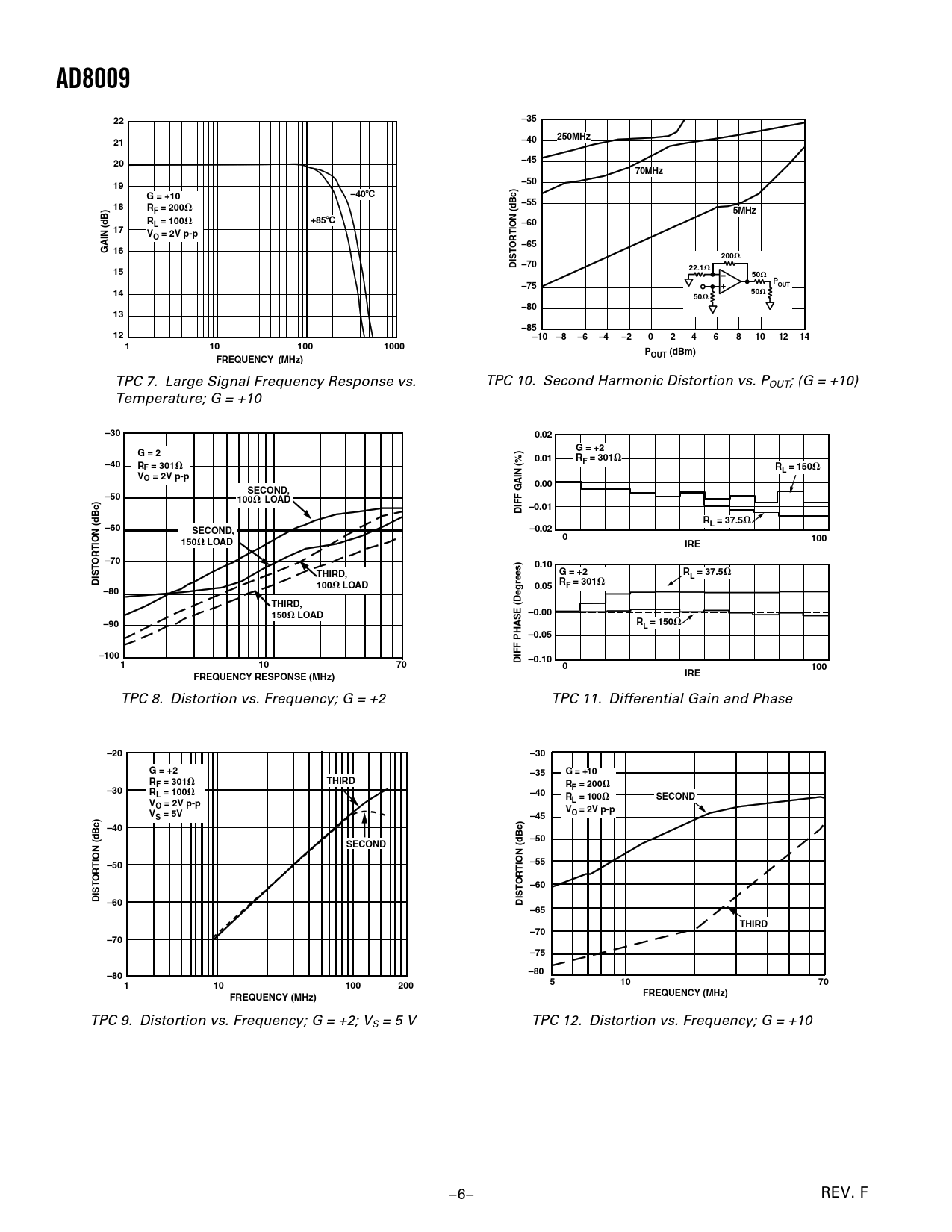

| Description | 1 GHz, 5,500 V/µs Low Distortion Amplifier |

AD8009. –35. 250MHz. –40. –45. 70MHz. –50. G = +10. –55. RF = 200. 5MHz. +85. L = 100. –60. O = 2V p-p. –65. GAIN (dB) 16. 200. DISTORTION (dBc) –70. 22.1. –75
AD8009 22 –35 250MHz 21 –40 20 –45 70MHz –50 19 G = +10 –40
ⴗ
C –55 18 RF = 200
5MHz R +85
ⴗ
C L = 100
–60 17 V O = 2V p-p –65 GAIN (dB) 16 200
DISTORTION (dBc) –70 15 22.1
50
P –75 OUT 14 50
50
–80 13 –85 12 –10 –8 –6 –4 –2 0 2 4 6 8 10 12 14 1 10 100 1000 POUT (dBm) FREQUENCY (MHz)
TPC 7. Large Signal Frequency Response vs. TPC 10. Second Harmonic Distortion vs. POUT; (G = +10) Temperature; G = +10
–30 0.02 G = +2 G = 2 ) 0.01 R –40 R F = 301
F = 301
RL = 150
VO = 2V p-p 0.00 SECOND, –50 100
LOAD DIFF GAIN (% –0.01 R –60 L = 37.5
SECOND, –0.02 0 150
LOAD 100 TION (dBc) IRE OR –70 0.10 THIRD, G = +2 RL = 37.5
DIST 100
LOAD R 0.05 F = 301
–80 THIRD, (Degrees) 150
LOAD –0.00 –90 RL = 150
–0.05 –100 DIFF PHASE –0.10 1 10 70 0 100 FREQUENCY RESPONSE (MHz) IRE
TPC 8. Distortion vs. Frequency; G = +2 TPC 11. Differential Gain and Phase
–20 –30 G = +2 –35 G = +10 RF = 301
THIRD R –30 F = 200
RL = 100
–40 R SECOND V L = 100
O = 2V p-p V V O = 2V p-p S = 5V –45 –40 –50 SECOND TION (dBc) –50 –55 TION (dBc) OR OR –60 DIST –60 DIST –65 THIRD –70 –70 –75 –80 –80 1 10 100 200 5 10 70 FREQUENCY (MHz) FREQUENCY (MHz)
TPC 9. Distortion vs. Frequency; G = +2; VS = 5 V TPC 12. Distortion vs. Frequency; G = +10 –6– REV. F Document Outline FEATURES APPLICATIONS FUNCTIONAL BLOCK DIAGRAMS PRODUCT DESCRIPTION SPECIFICATIONS ABSOLUTE MAXIMUM RATINGS MAXIMUM POWER DISSIPATION ORDERING GUIDE Typical Performance Characteristics APPLICATIONS RF Filter Driver RGB Monitor Driver Driving a Capacitive Load OUTLINE DIMENSIONS Revision History
