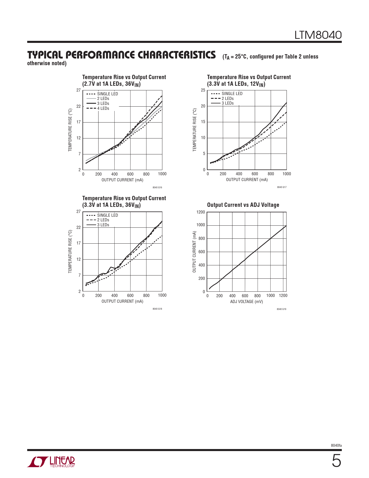

TYPICAL PERFORMANCE CHARACTERISTICS. (TA = 25°C, confi gured per Table 2 unless. otherwise noted)
TYPICAL PERFORMANCE CHARACTERISTICS (TA = 25°C, confi gured per Table 2 unless otherwise noted)
LTM8040
TYPICAL PERFORMANCE CHARACTERISTICS (TA = 25°C, confi gured per Table 2 unless otherwise noted) Temperature Rise vs Output Current Temperature Rise vs Output Current (2.7V at 1A LEDs, 36VIN) (3.3V at 1A LEDs, 12VIN)
27 25 SINGLE LED SINGLE LED 2 LEDs 2 LEDs 3 LEDs 3 LEDs 22 20 4 LEDs 17 15 TURE RISE (°C) TURE RISE (°C) 12 10 TEMPERA TEMPERA 7 5 2 0 0 200 400 600 800 1000 0 200 400 600 800 1000 OUTPUT CURRENT (mA) OUTPUT CURRENT (mA) 8040 G16 8040 G17
Temperature Rise vs Output Current (3.3V at 1A LEDs, 36VIN) Output Current vs ADJ Voltage
27 1200 SINGLE LED 2 LEDs 3 LEDs 1000 22 800 17 600 TURE RISE (°C) 12 400 TEMPERA OUTPUT CURRENT (mA) 7 200 2 0 0 200 400 600 800 1000 0 200 400 600 800 1000 1200 OUTPUT CURRENT (mA) ADJ VOLTAGE (mV) 8040 G18 8040 G19 8040fa 5
