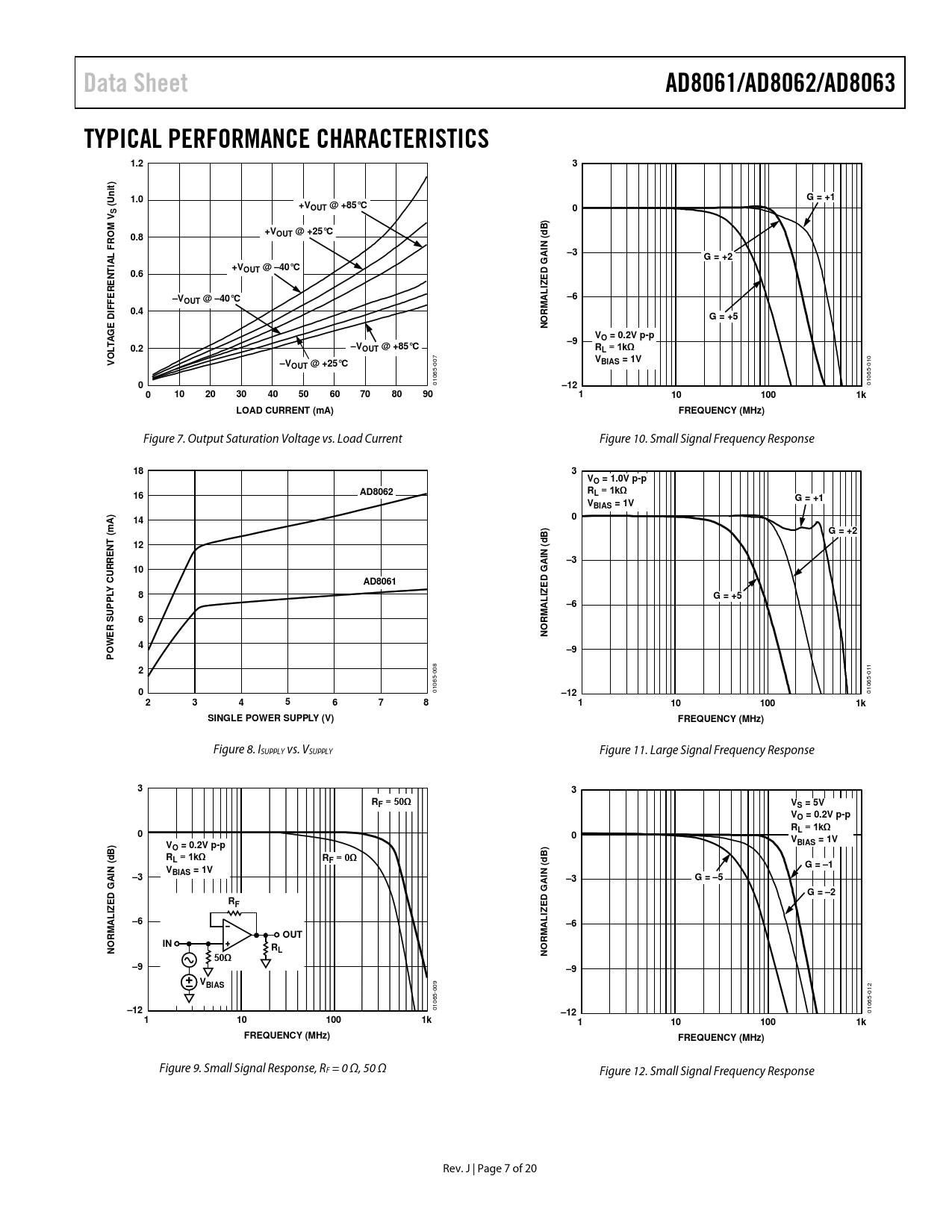

Data Sheet. AD8061/AD8062/AD8063. TYPICAL PERFORMANCE CHARACTERISTICS. 1.2. it) n. 1.0. G = +1. OUT @ +85°C. +VOUT @ +25°C. 0.8. G = +2. TIA
Data Sheet AD8061/AD8062/AD8063 TYPICAL PERFORMANCE CHARACTERISTICS 1.2 3 it) n 1.0 G = +1 (U +V S OUT @ +85°C 0 V B) OM +VOUT @ +25°C 0.8 (d FR IN L –3 G = +2 GA TIA +VOUT @ –40°C D N 0.6 E R LIZE –V A –6 OUT @ –40°C M IFFE 0.4 D OR G = +5 N GE V A –9 O = 0.2V p-p LT 0.2 –VOUT @ +85°C RL = 1kΩ VO –V VBIAS = 1V OUT @ +25°C
007 010
0
01065-
–12
01065-
0 10 20 30 40 50 60 70 80 90 1 10 100 1k LOAD CURRENT (mA) FREQUENCY (MHz)
Figure 7. Output Saturation Voltage vs. Load Current Figure 10. Small Signal Frequency Response
18 3 VO = 1.0V p-p R 16 AD8062 L = 1kΩ G = +1 VBIAS = 1V 14 0 mA) ( B) G = +2 (d NT 12 IN –3 10 GA D CURRE AD8061 Y L 8 LIZE G = +5 PP A –6 M SU 6 OR ER N W 4 –9 PO
1
2
1 008 0
0
01065-
–12
01065-
2 3 4 5 6 7 8 1 10 100 1k SINGLE POWER SUPPLY (V) FREQUENCY (MHz)
Figure 8. ISUPPLY vs. VSUPPLY Figure 11. Large Signal Frequency Response
3 3 RF = 50Ω VS = 5V VO = 0.2V p-p R 0 L = 1kΩ 0 V V BIAS = 1V B) O = 0.2V p-p d R B) R L = 1kΩ F = 0Ω d G = –1 N ( VBIAS = 1V N ( AI –3 AI –3 G = –5 D G G = –2 D G E RF E IZ IZ AL –6 AL –6 RM OUT RM IN NO RL 50Ω NO –9 –9 VBIAS
009 012
–12
01065-
–12
01065-
1 10 100 1k 1 10 100 1k FREQUENCY (MHz) FREQUENCY (MHz)
Figure 9. Small Signal Response, RF = 0 Ω, 50 Ω Figure 12. Small Signal Frequency Response Rev. J | Page 7 of 20 Document Outline Features Applications Connection Diagrams General Description Revision History Specifications Absolute Maximum Ratings Maximum Power Dissipation ESD Caution Typical Performance Characteristics Circuit Description Headroom Considerations Overload Behavior and Recovery Input Output Capacitive Load Drive Disable Operation Board Layout Considerations Applications Information Single-Supply Sync Stripper RGB Amplifier Multiplexer Outline Dimensions Ordering Guide
