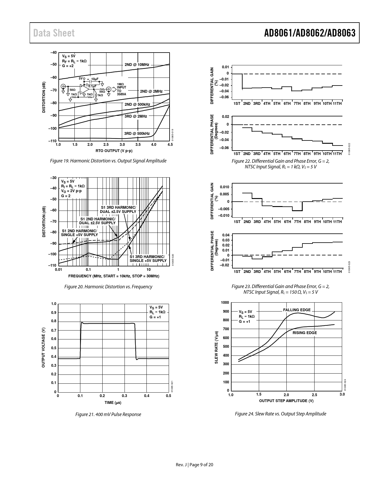

Data Sheet. AD8061/AD8062/AD8063. –40. VS = 5V RF = RL = 1kΩ. –50. 2ND @ 10MHz. G = +2. 0.01. –60. + 10µF. –0.01. 1MΩ. TIA. (%) –0.02. 0.1µF. INPUT
Data Sheet AD8061/AD8062/AD8063 –40 VS = 5V RF = RL = 1kΩ –50 2ND @ 10MHz G = +2 0.01 IN 0 –60 GA 5V + 10µF L –0.01 B) 1MΩ TIA (%) –0.02 (d 0.1µF INPUT N –70 50Ω 50Ω TO E 2ND @ 2MHz –0.04 1kΩ 1kΩ R 1kΩ 3589A TION –0.06 IFFE OR –80 D 1ST 2ND 3RD 4TH 5TH 6TH 7TH 8TH 9TH 10TH 11TH T 2ND @ 500kHz S DI –90 3RD @ 2MHz E 0.02 HAS 0 P –100 L rees) 3RD @ 500kHz
019
–0.02 TIA N (Deg –110
01065-
E –0.04 R 1.0 1.5 2.0 2.5 3.0 3.5 4.0 4.5 –0.06
022
RTO OUTPUT (V p-p) IFFE D 1ST 2ND 3RD 4TH 5TH 6TH 7TH 8TH 9TH 10TH 11TH
01065- Figure 19. Harmonic Distortion vs. Output Signal Amplitude Figure 22. Differential Gain and Phase Error, G = 2, NTSC Input Signal, RL = 1 kΩ, VS = 5 V
–30 VS = 5V R IN –40 I = RL = 1kΩ 0.010 VO = 2V p-p GA L G = 2 0.005 –50 TIA (%) 0 N E B) S1 3RD HARMONIC/ R –60 –0.005 (d DUAL ±2.5V SUPPLY IFFE –0.010 S1 2ND HARMONIC/ D TION –70 DUAL ±2.5V SUPPLY 1ST 2ND 3RD 4TH 5TH 6TH 7TH 8TH 9TH 10TH 11TH OR T S –80 S1 2ND HARMONIC/ E DI SINGLE +5V SUPPLY 0.04 HAS 0.03 –90 P L 0.02 rees) 0.01 TIA –100 N (Deg S1 3RD HARMONIC/ 0
020
E R SINGLE +5V SUPPLY –0.01 –110
01065-
–0.02
023
IFFE 0.01 0.1 1 10 D 1ST 2ND 3RD 4TH 5TH 6TH 7TH 8TH 9TH 10TH 11TH
01065-
FREQUENCY (MHz, START = 10kHz, STOP = 30MHz)
Figure 20. Harmonic Distortion vs. Frequency Figure 23. Differential Gain and Phase Error, G = 2, NTSC Input Signal, RL = 150 Ω, VS = 5 V
1.0 1000 VS = 5V FALLING EDGE 0.9 R 900 V L = 1kΩ S = 5V G = +1 RL = 1kΩ 0.8 800 G = +1 0.7 700 (V) ) s RISING EDGE E µ 0.6 600 AG LT E (V/ T O 0.5 500 A R T V U 0.4 400 EW TP SL 300 OU 0.3 0.2 200 0.1 100
024 021 01065-
0
01065-
0 0 0.1 0.2 0.3 0.4 0.5 1.0 1.5 2.0 2.5 3.0 TIME (µs) OUTPUT STEP AMPLITUDE (V)
Figure 21. 400 mV Pulse Response Figure 24. Slew Rate vs. Output Step Amplitude Rev. J | Page 9 of 20 Document Outline Features Applications Connection Diagrams General Description Revision History Specifications Absolute Maximum Ratings Maximum Power Dissipation ESD Caution Typical Performance Characteristics Circuit Description Headroom Considerations Overload Behavior and Recovery Input Output Capacitive Load Drive Disable Operation Board Layout Considerations Applications Information Single-Supply Sync Stripper RGB Amplifier Multiplexer Outline Dimensions Ordering Guide
