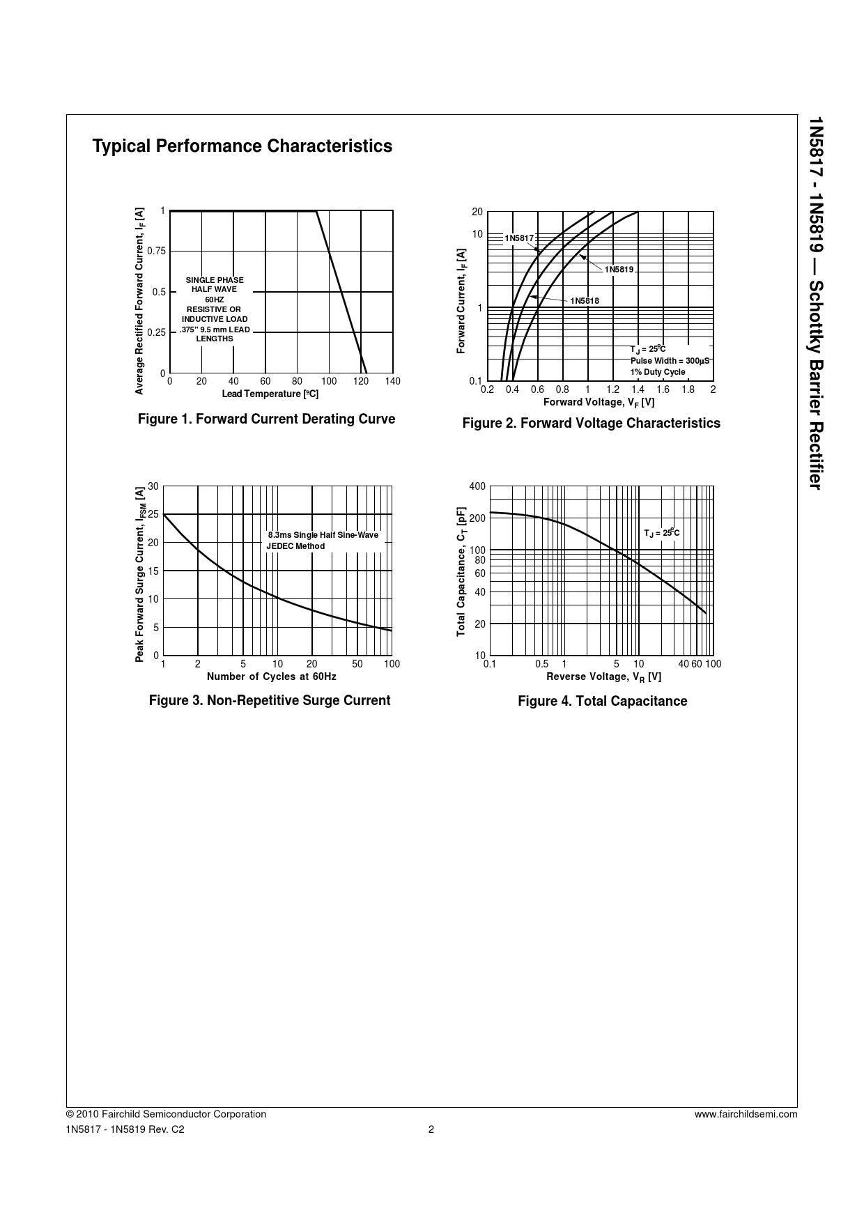

1N5817 - 1N5819 — Scho. Typical Performance Characteristics. [A] F. 1N5817. 1N5819. SINGLE PHASE. HALF WAVE. 60HZ. 1N5818. RESISTIVE OR
![1N5817 - 1N5819 — Scho Typical Performance Characteristics [A] F 1N5817 1N5819 SINGLE PHASE HALF WAVE 60HZ 1N5818 RESISTIVE OR](https://www.rlocman.ru/datasheet/img.php?di=35505&p=1)
1 20
[A] F
10
1N5817
0.75
[A] F 1N5819 SINGLE PHASE
0.5
1
INDUCTIVE LOAD tt
0.25
.375" 9.5 mm LEAD ky Barrier Rectifier LENGTHS Forward Current, I T = 25 C º J Pulse Width = 300
μ
S
0
1% Duty Cycle
0 20 40 60 80 100 120 140 0.1
Average Rectified Forward Current, I Lead Temperature [ºC]
0.2 0.4 0.6 0.8 1 1.2 1.4 1.6 1.8 2
Forward Voltage, V [V] F Figure 1. Forward Current Derating Curve Figure 2. Forward Voltage Characteristics
30 400
[A] FSM
25 200
[pF] T T = 25 C º 8.3ms Single Half Sine-Wave J
20
JEDEC Method
100 80 15 60 40 10 20 5
Total Capacitance, C
0 10
Peak Forward Surge Current, I
1 2 5 10 20 50 100 0.1 0.5 1 5 10 40 60 100
Number of Cycles at 60Hz Reverse Voltage, V [V] R Figure 3. Non-Repetitive Surge Current Figure 4. Total Capacitance
