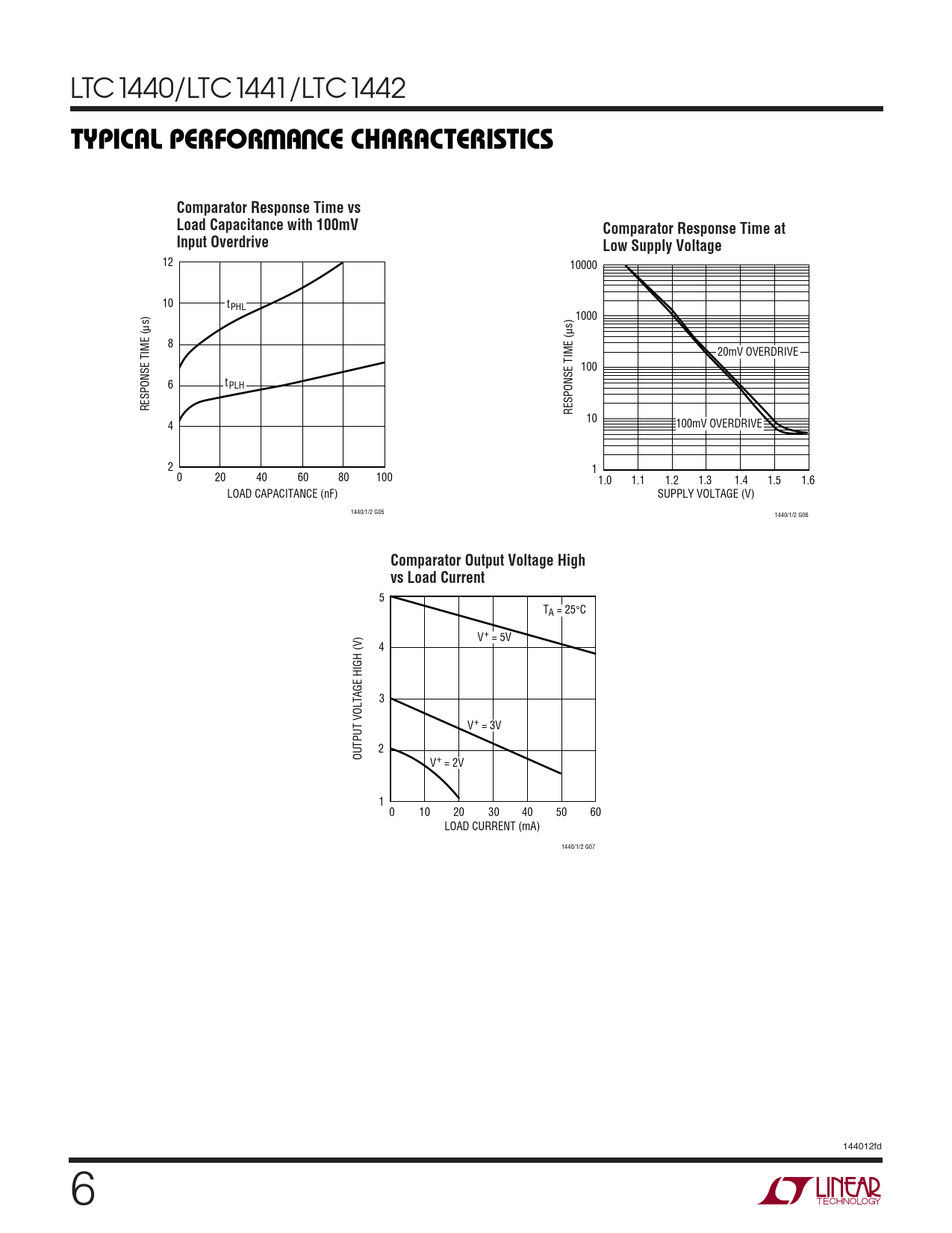

TYPICAL PERFOR A CE CHARACTERISTICS. Comparator Response Time vs Load Capacitance with 100mV. Comparator Response Time at
LTC1440/LTC1441/LTC1442
W U TYPICAL PERFOR A CE CHARACTERISTICS Comparator Response Time vs Load Capacitance with 100mV Comparator Response Time at Input Overdrive Low Supply Voltage
12 10000 10 tPHL 1000 µs) µs) 8 20mV OVERDRIVE 100 6 tPLH RESPONSE TIME ( RESPONSE TIME ( 10 4 100mV OVERDRIVE 2 1 0 20 40 60 80 100 1.0 1.1 1.2 1.3 1.4 1.5 1.6 LOAD CAPACITANCE (nF) SUPPLY VOLTAGE (V) 1440/1/2 G05 1440/1/2 G06
Comparator Output Voltage High vs Load Current
5 TA = 25°C V+ = 5V 4 3 V+ = 3V 2 OUTPUT VOLTAGE HIGH (V) V+ = 2V 1 0 10 20 30 40 50 60 LOAD CURRENT (mA) 1440/1/2 G07 144012fd 6
