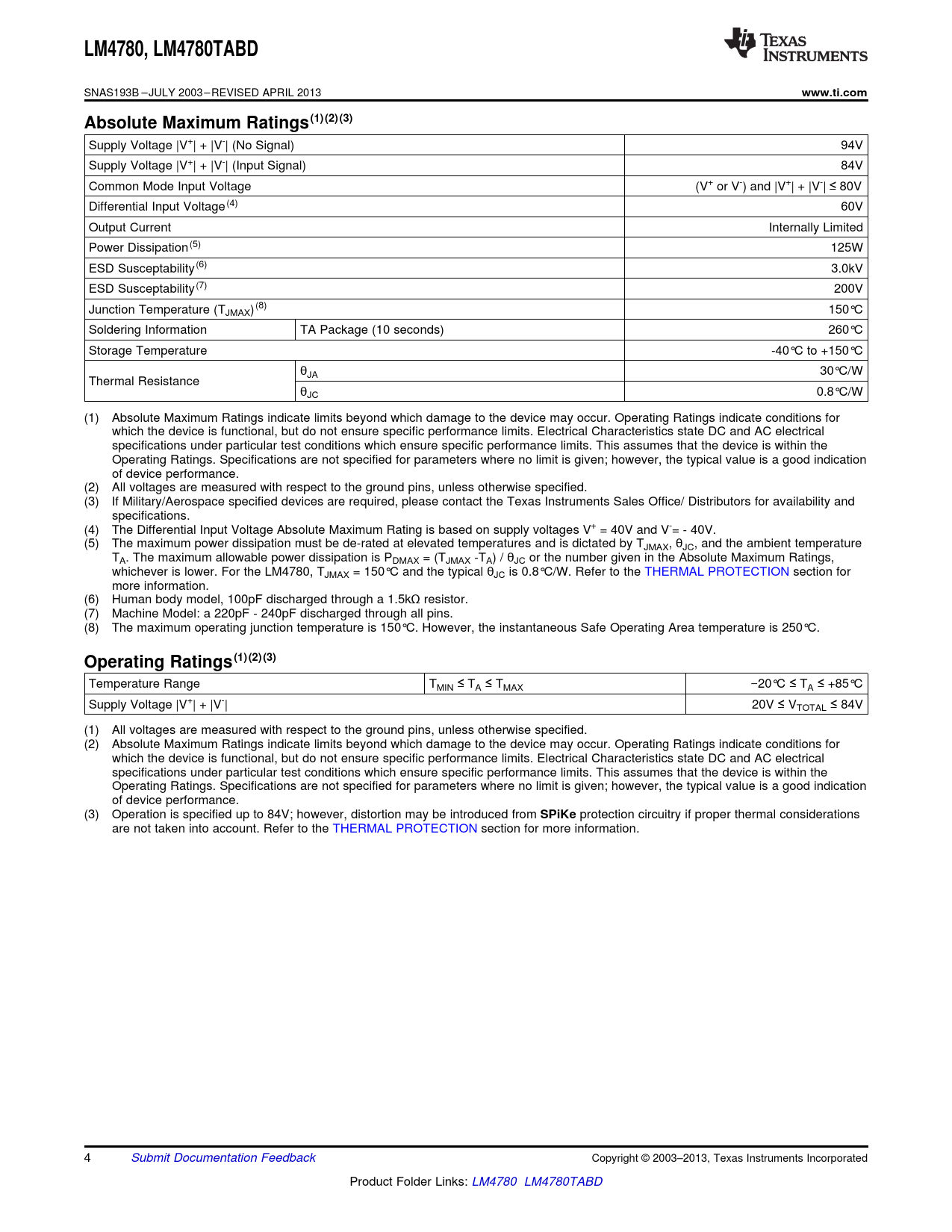

Supply Voltage |V+| + |V-| (No Signal) 94V Supply Voltage |V+| + |V-| (Input Signal) 84V Common Mode Input Voltage (V+ or V-) and |V+| + |V-| ≤ 80V Differential Input Voltage(4) 60V Output Current Internally Limited Power Dissipation(5) 125W ESD Susceptability(6) 3.0kV ESD Susceptability(7) 200V Junction Temperature (TJMAX)(8) 150°C Soldering Information TA Package (10 seconds) 260°C Storage Temperature -40°C to +150°C θJA 30°C/W Thermal Resistance θJC 0.8°C/W (1) Absolute Maximum Ratings indicate limits beyond which damage to the device may occur. Operating Ratings indicate conditions for which the device is functional, but do not ensure specific performance limits. Electrical Characteristics state DC and AC electrical specifications under particular test conditions which ensure specific performance limits. This assumes that the device is within the Operating Ratings. Specifications are not specified for parameters where no limit is given; however, the typical value is a good indication of device performance. (2) All voltages are measured with respect to the ground pins, unless otherwise specified. (3) If Military/Aerospace specified devices are required, please contact the Texas Instruments Sales Office/ Distributors for availability and specifications. (4) The Differential Input Voltage Absolute Maximum Rating is based on supply voltages V+ = 40V and V-= - 40V. (5) The maximum power dissipation must be de-rated at elevated temperatures and is dictated by TJMAX, θJC, and the ambient temperature TA. The maximum allowable power dissipation is PDMAX = (TJMAX -TA) / θJC or the number given in the Absolute Maximum Ratings, whichever is lower. For the LM4780, TJMAX = 150°C and the typical θJC is 0.8°C/W. Refer to the THERMAL PROTECTION section for more information. (6) Human body model, 100pF discharged through a 1.5kΩ resistor. (7) Machine Model: a 220pF - 240pF discharged through all pins. (8) The maximum operating junction temperature is 150°C. However, the instantaneous Safe Operating Area temperature is 250°C.
Operating Ratings(1)(2)(3)
Temperature Range TMIN ≤ TA ≤ TMAX −20°C ≤ TA ≤ +85°C Supply Voltage |V+| + |V-| 20V ≤ VTOTAL ≤ 84V (1) All voltages are measured with respect to the ground pins, unless otherwise specified. (2) Absolute Maximum Ratings indicate limits beyond which damage to the device may occur. Operating Ratings indicate conditions for which the device is functional, but do not ensure specific performance limits. Electrical Characteristics state DC and AC electrical specifications under particular test conditions which ensure specific performance limits. This assumes that the device is within the Operating Ratings. Specifications are not specified for parameters where no limit is given; however, the typical value is a good indication of device performance. (3) Operation is specified up to 84V; however, distortion may be introduced from
