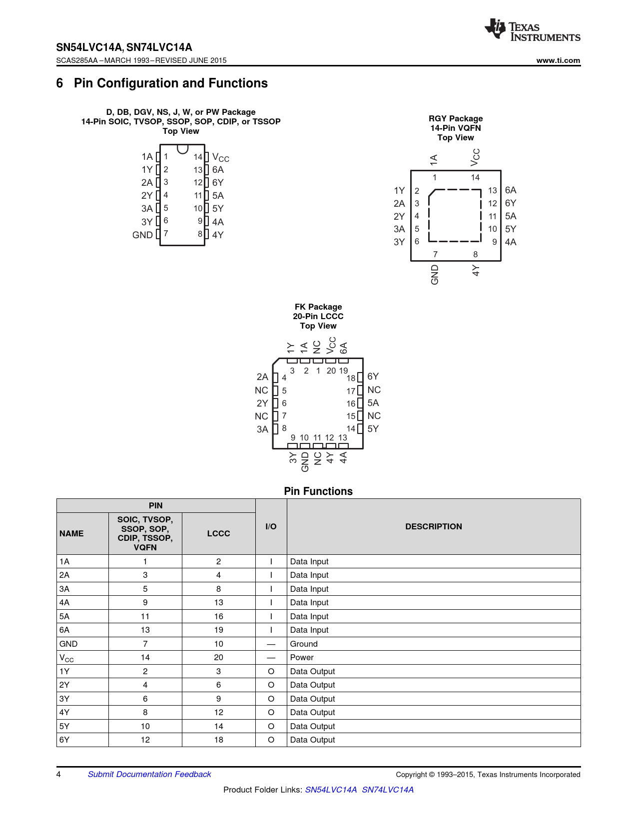

SN54LVC14A,. SN74LVC14A. www.ti.com. 6 Pin Configuration and Functions. D, DB, DGV, NS, J, W, or PW Package. RGY Package
SN54LVC14A, SN74LVC14A www.ti.com 6 Pin Configuration and Functions D, DB, DGV, NS, J, W, or PW Package RGY Package
SN74LVC14A
SCAS285AA – MARCH 1993 – REVISED JUNE 2015
www.ti.com 6 Pin Configuration and Functions D, DB, DGV, NS, J, W, or PW Package RGY Package 14-Pin SOIC, TVSOP, SSOP, SOP, CDIP, or TSSOP 14-Pin VQFN Top View Top View
1A 1 14 V CC CC 1A V 1Y 2 13 6A 1 14 2A 3 12 6Y 1Y 2 13 6A 2Y 4 11 5A 2A 3 12 6Y 3A 5 10 5Y 2Y 4 11 5A 6 3Y 9 4A 3A 5 10 5Y 7 8 GND 4Y 3Y 6 9 4A 7 8 4Y GND
FK Package 20-Pin LCCC Top View
CC 1Y 1A NC V 6A 3 2 1 20 19 2A 4 18 6Y NC 5 17 NC 2Y 6 16 5A NC 7 15 NC 3A 8 14 5Y 9 10 11 12 13 3Y 4Y 4A NC GND
Pin Functions PIN SOIC, TVSOP, I/O DESCRIPTION SSOP, SOP, NAME LCCC CDIP, TSSOP, VQFN
1A 1 2 I Data Input 2A 3 4 I Data Input 3A 5 8 I Data Input 4A 9 13 I Data Input 5A 11 16 I Data Input 6A 13 19 I Data Input GND 7 10 — Ground VCC 14 20 — Power 1Y 2 3 O Data Output 2Y 4 6 O Data Output 3Y 6 9 O Data Output 4Y 8 12 O Data Output 5Y 10 14 O Data Output 6Y 12 18 O Data Output 4 Submit Documentation Feedback Copyright © 1993–2015, Texas Instruments Incorporated Product Folder Links: SN54LVC14A SN74LVC14A Document Outline 1 Features 2 Applications 3 Description Table of Contents 4 Revision History 5 Device Options 6 Pin Configuration and Functions 7 Specifications 7.1 Absolute Maximum Ratings 7.2 ESD Ratings 7.3 Recommended Operating Conditions, SN54LVC14A 7.4 Recommended Operating Conditions, SN74LVC14A 7.5 Thermal Information 7.6 Electrical Characteristics, SN54LVC14A 7.7 Electrical Characteristics, SN74LVC14A 7.8 Switching Characteristics, SN54LVC14A 7.9 Switching Characteristics, SN74LVC14A 7.10 Operating Characteristics 7.11 Typical Characteristics 8 Parameter Measurement Information 9 Detailed Description 9.1 Overview 9.2 Functional Block Diagram 9.3 Feature Description 9.4 Device Functional Modes 10 Application and Implementation 10.1 Application Information 10.2 Typical Application 10.2.1 Design Requirements 10.2.2 Detailed Design Procedure 10.2.3 Application Curves 11 Power Supply Recommendations 12 Layout 12.1 Layout Guidelines 12.2 Layout Examples 13 Device and Documentation Support 13.1 Related Links 13.2 Community Resources 13.3 Trademarks 13.4 Electrostatic Discharge Caution 13.5 Glossary 14 Mechanical, Packaging, and Orderable Information
