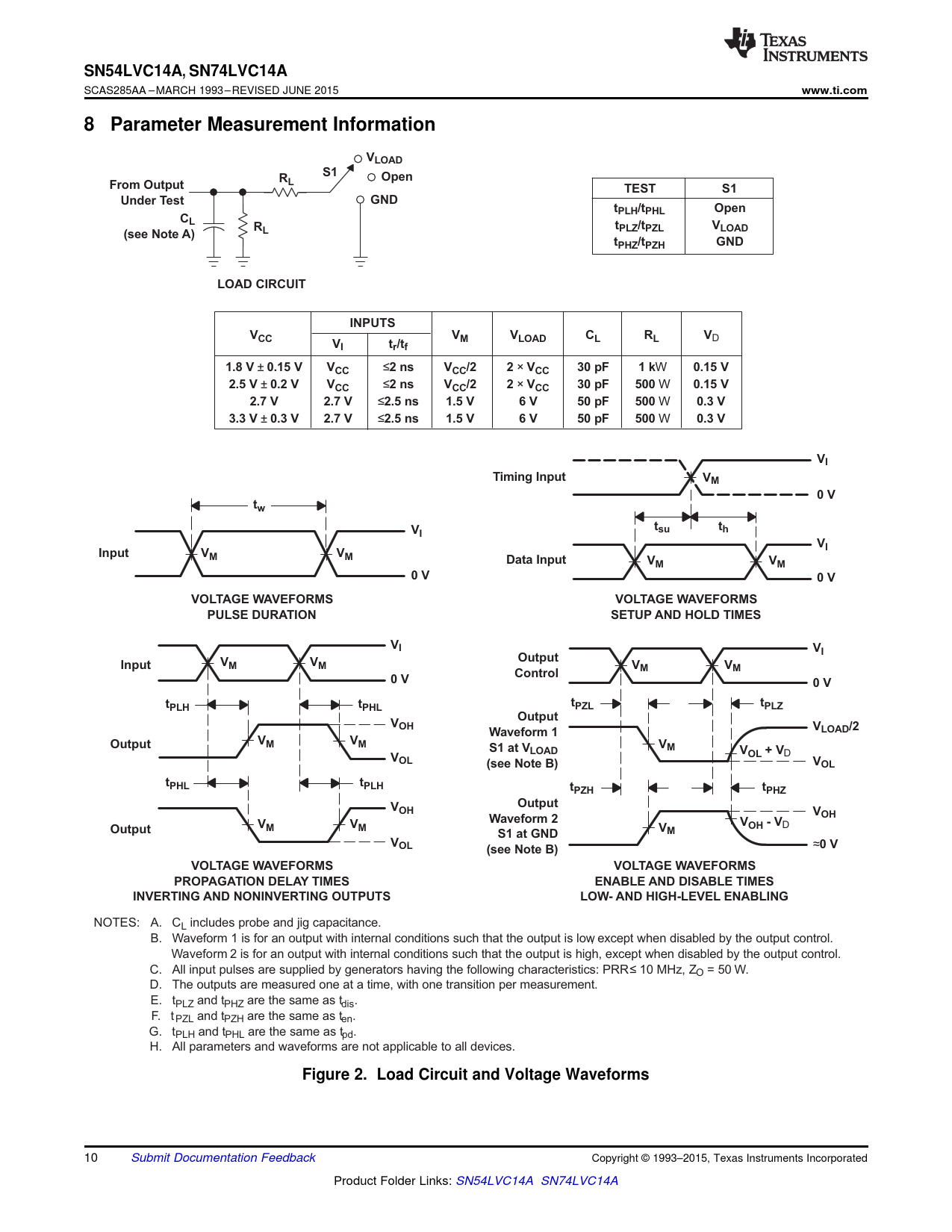

SN54LVC14A,. SN74LVC14A. www.ti.com. 8 Parameter Measurement Information. VLOAD. Open. From Output. TEST. Under Test. GND. tPLH/tPHL
SN54LVC14A, SN74LVC14A www.ti.com 8 Parameter Measurement Information VLOAD Open From Output TEST Under Test GND tPLH/tPHL
SN74LVC14A
SCAS285AA – MARCH 1993 – REVISED JUNE 2015
www.ti.com 8 Parameter Measurement Information VLOAD S1 R Open From Output L TEST S1 Under Test GND tPLH/tPHL Open CL R t V (see Note A) L PLZ/tPZL LOAD tPHZ/tPZH GND LOAD CIRCUIT INPUTS VCC V V R M LOAD CL L V
D
VI tr/tf 1.8 V
0.15 V V
2 ns V 2
V 30 pF 1 k
W
CC CC/2 CC 0.15 V 2.5 V
0.2 V V
2 ns V 2
V 30 pF 500
W
CC CC/2 CC 0.15 V 2.7 V 2.7 V
2.5 ns 1.5 V 6 V 50 pF 500
W
0.3 V 3.3 V
0.3 V 2.7 V
W
0.3 V VI Timing Input VM 0 V tw t t V su h I VI Input VM VM Data Input VM VM 0 V 0 V VOLTAGE WAVEFORMS VOLTAGE WAVEFORMS PULSE DURATION SETUP AND HOLD TIMES VI VI V Output Input M VM V Control M VM 0 V 0 V tPLH tPHL tPZL tPLZ Output VOH V Waveform 1 LOAD/2 Output VM VM S1 at V V LOAD M V V OL + V
D
OL (see Note B) VOL tPHL tPLH tPZH tPHZ V Output OH V Waveform 2 OH V VOH - V
D
Output M VM V S1 at GND M VOL (see Note B)
0 V VOLTAGE WAVEFORMS VOLTAGE WAVEFORMS PROPAGATION DELAY TIMES ENABLE AND DISABLE TIMES INVERTING AND NONINVERTING OUTPUTS LOW- AND HIGH-LEVEL ENABLING
NOTES: A. CL includes probe and jig capacitance. B. Waveform 1 is for an output with internal conditions such that the output is low, except when disabled by the output control. Waveform 2 is for an output with internal conditions such that the output is high, except when disabled by the output control. C. All input pulses are supplied by generators having the following characteristics: PRR≤ 10 MHz, ZO = 50 W. D. The outputs are measured one at a time, with one transition per measurement. E. tPLZ and tPHZ are the same as tdis. F. t PZL and tPZH are the same as ten. G. tPLH and tPHL are the same as tpd. H. All parameters and waveforms are not applicable to all devices.
Figure 2. Load Circuit and Voltage Waveforms
