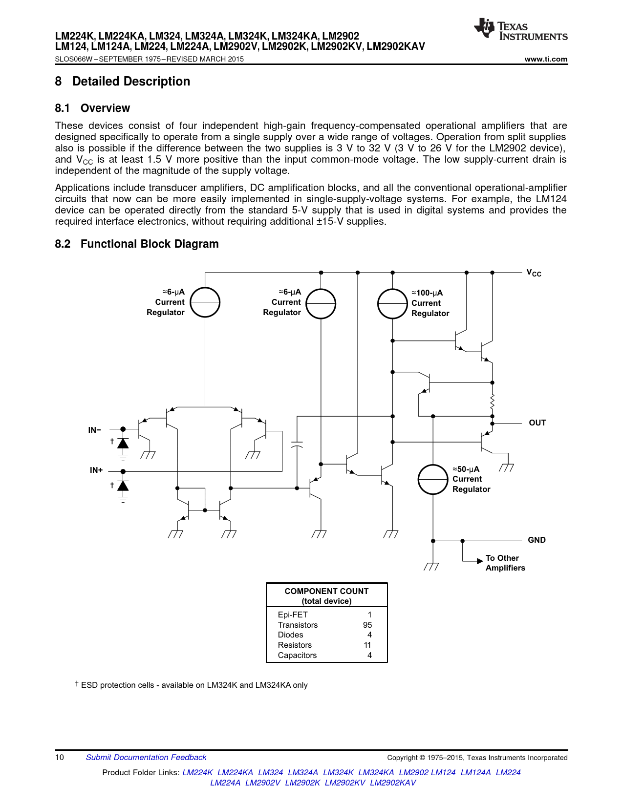

www.ti.com 8 Detailed Description 8.1 Overview
These devices consist of four independent high-gain frequency-compensated operational amplifiers that are designed specifically to operate from a single supply over a wide range of voltages. Operation from split supplies also is possible if the difference between the two supplies is 3 V to 32 V (3 V to 26 V for the LM2902 device), and VCC is at least 1.5 V more positive than the input common-mode voltage. The low supply-current drain is independent of the magnitude of the supply voltage. Applications include transducer amplifiers, DC amplification blocks, and all the conventional operational-amplifier circuits that now can be more easily implemented in single-supply-voltage systems. For example, the LM124 device can be operated directly from the standard 5-V supply that is used in digital systems and provides the required interface electronics, without requiring additional ±15-V supplies.
8.2 Functional Block Diagram VCC
6-
µ
A
6-
µ
A
100-
µ
A Current Current Current Regulator Regulator Regulator OUT IN− † IN+
50-
µ
A Current † Regulator GND To Other Amplifiers COMPONENT COUNT (total device)
Epi-FET 1 Transistors 95 Diodes 4 Resistors 11 Capacitors 4 † ESD protection cells - available on LM324K and LM324KA only 10 Submit Documentation Feedback Copyright © 1975–2015, Texas Instruments Incorporated Product Folder Links: LM224K LM224KA LM324 LM324A LM324K LM324KA LM2902 LM124 LM124A LM224 LM224A LM2902V LM2902K LM2902KV LM2902KAV Document Outline 1 Features 2 Applications 3 Description Table of Contents 4 Revision History 5 Pin Configuration and Functions 6 Specifications 6.1 Absolute Maximum Ratings 6.2 ESD Ratings 6.3 Recommended Operating Conditions 6.4 Thermal Information 6.5 Electrical Characteristics for LMx24 and LM324K 6.6 Electrical Characteristics for LM2902 and LM2902V 6.7 Electrical Characteristics for LMx24A and LM324KA 6.8 Operating Conditions 6.9 Typical Characteristics 7 Parameter Measurement Information 8 Detailed Description 8.1 Overview 8.2 Functional Block Diagram 8.3 Feature Description 8.3.1 Unity-Gain Bandwidth 8.3.2 Slew Rate 8.3.3 Input Common Mode Range 8.4 Device Functional Modes 9 Application and Implementation 9.1 Application Information 9.2 Typical Application 9.2.1 Design Requirements 9.2.2 Detailed Design Procedure 9.2.3 Application Curve 10 Power Supply Recommendations 11 Layout 11.1 Layout Guidelines 11.2 Layout Examples 12 Device and Documentation Support 12.1 Documentation Support 12.1.1 Related Documentation 12.2 Related Links 12.3 Trademarks 12.4 Electrostatic Discharge Caution 12.5 Glossary 13 Mechanical, Packaging, and Orderable Information
