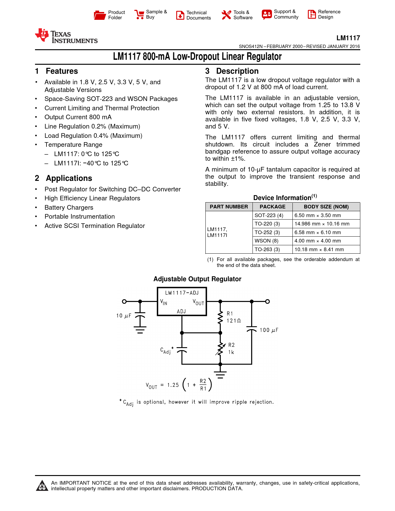

LM1117 800-mA Low-Dropout Linear Regulator 1 Features 3 Description
The LM1117 is a low dropout voltage regulator with a • Available in 1.8 V, 2.5 V, 3.3 V, 5 V, and 1 dropout of 1.2 V at 800 mA of load current. Adjustable Versions • Space-Saving SOT-223 and WSON Packages The LM1117 is available in an adjustable version, which can set the output voltage from 1.25 to 13.8 V • Current Limiting and Thermal Protection with only two external resistors. In addition, it is • Output Current 800 mA available in five fixed voltages, 1.8 V, 2.5 V, 3.3 V, • Line Regulation 0.2% (Maximum) and 5 V. • Load Regulation 0.4% (Maximum) The LM1117 offers current limiting and thermal • Temperature Range shutdown. Its circuit includes a Zener trimmed bandgap reference to assure output voltage accuracy – LM1117: 0°C to 125°C to within ±1%. – LM1117I: −40°C to 125°C A minimum of 10-µF tantalum capacitor is required at the output to improve the transient response and
2 Applications
stability. • Post Regulator for Switching DC–DC Converter
Device Information(1)
• High Efficiency Linear Regulators
PART NUMBER PACKAGE BODY SIZE (NOM)
• Battery Chargers SOT-223 (4) 6.50 mm × 3.50 mm • Portable Instrumentation TO-220 (3) 14.986 mm × 10.16 mm • Active SCSI Termination Regulator LM1117, TO-252 (3) 6.58 mm × 6.10 mm LM1117I WSON (8) 4.00 mm × 4.00 mm TO-263 (3) 10.18 mm × 8.41 mm (1) For all available packages, see the orderable addendum at the end of the data sheet.
Adjustable Output Regulator
