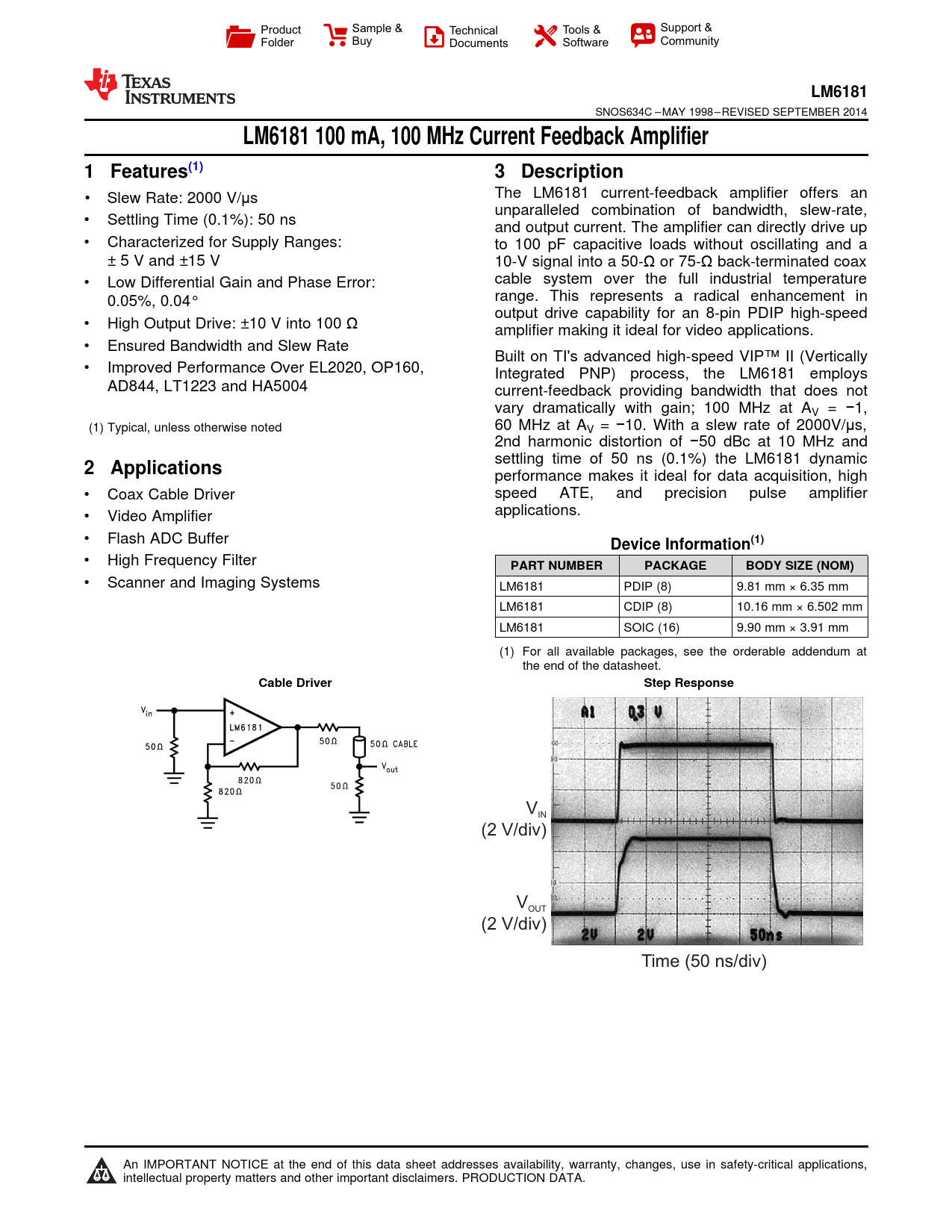

LM6181 100 mA, 100 MHz Current Feedback Amplifier 1 Features(1) 3 Description
The LM6181 current-feedback amplifier offers an • Slew Rate: 2000 V/μs 1 unparalleled combination of bandwidth, slew-rate, • Settling Time (0.1%): 50 ns and output current. The amplifier can directly drive up • Characterized for Supply Ranges: to 100 pF capacitive loads without oscillating and a ± 5 V and ±15 V 10-V signal into a 50-Ω or 75-Ω back-terminated coax cable system over the full industrial temperature • Low Differential Gain and Phase Error: range. This represents a radical enhancement in 0.05%, 0.04° output drive capability for an 8-pin PDIP high-speed • High Output Drive: ±10 V into 100 Ω amplifier making it ideal for video applications. • Ensured Bandwidth and Slew Rate Built on TI's advanced high-speed VIP™ II (Vertically • Improved Performance Over EL2020, OP160, Integrated PNP) process, the LM6181 employs AD844, LT1223 and HA5004 current-feedback providing bandwidth that does not vary dramatically with gain; 100 MHz at AV = −1, (1) Typical, unless otherwise noted 60 MHz at AV = −10. With a slew rate of 2000V/μs, 2nd harmonic distortion of −50 dBc at 10 MHz and settling time of 50 ns (0.1%) the LM6181 dynamic
2 Applications
performance makes it ideal for data acquisition, high • Coax Cable Driver speed ATE, and precision pulse amplifier applications. • Video Amplifier • Flash ADC Buffer
Device Information(1)
• High Frequency Filter
PART NUMBER PACKAGE BODY SIZE (NOM)
• Scanner and Imaging Systems LM6181 PDIP (8) 9.81 mm × 6.35 mm LM6181 CDIP (8) 10.16 mm × 6.502 mm LM6181 SOIC (16) 9.90 mm × 3.91 mm (1) For all available packages, see the orderable addendum at the end of the datasheet.
Cable Driver Step Response
VIN (2 V/div) VOUT (2 V/div) Time (50 ns/div) 1 An IMPORTANT NOTICE at the end of this data sheet addresses availability, warranty, changes, use in safety-critical applications, intellectual property matters and other important disclaimers. PRODUCTION DATA. Document Outline 1 Features 2 Applications 3 Description Table of Contents 4 Revision History 5 Pin Configuration and Functions 6 Specifications 6.1 Absolute Maximum Ratings 6.2 Handling Ratings 6.3 Recommended Operating Conditions 6.4 Thermal Information 6.5 ±15V DC Electrical Characteristics 6.6 ±15V AC Electrical Characteristics 6.7 ±5V DC Electrical Characteristics 6.8 ±5V AC Electrical Characteristics 6.9 Typical Performance Characteristics 7 Typical Applications 7.1 Current Feedback Topology 7.2 Power Supply Bypassing and Layout Considerations 7.3 Feedback Resistor Selection: Rf 7.4 Slew Rate Considerations 7.5 Driving Capacitive Loads 7.6 Capacitive Feedback 8 Application and Implementation 8.1 Typical Application 8.1.1 Typical Performance Characteristics 8.1.1.1 Overdrive Recovery 9 Device and Documentation Support 9.1 Trademarks 9.2 Electrostatic Discharge Caution 9.3 Glossary 10 Mechanical, Packaging, and Orderable Information
