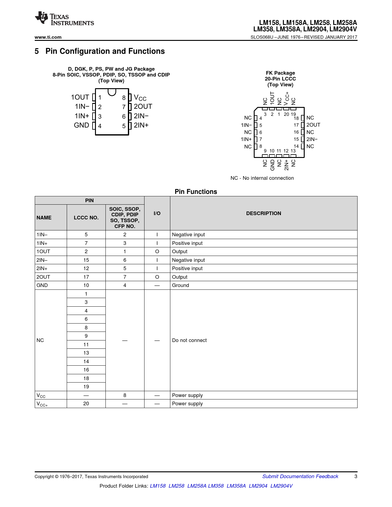

LM158,. LM158A, LM258. , LM258A. LM358,. LM358A,. LM2904. , LM2904V. www.ti.com. 5 Pin Configuration and Functions
LM158, LM158A, LM258 , LM258A LM358, LM358A, LM2904 , LM2904V www.ti.com
SLOS068U – JUNE 1976 – REVISED JANUARY 2017
5 Pin Configuration and Functions D, DGK, P, PS, PW and JG Package 8-Pin SOIC, VSSOP, PDIP, SO, TSSOP and CDIP FK Package (Top View) 20-Pin LCCC (Top View)
1OUT 1 8 VCC CC+ NC 1OUT NC V NC 1IN− 2 7 2OUT 3 2 1 20 19 1IN+ 3 6 2IN− NC 4 18 NC GND 2IN+ 1IN− 5 17 2OUT 4 5 NC 6 16 NC 1IN+ 7 15 2IN− NC 8 14 NC 9 10 11 12 13 NC NC NC GND 2IN+ NC - No internal connection
Pin Functions PIN SOIC, SSOP, I/O DESCRIPTION CDIP, PDIP NAME LCCC NO. SO, TSSOP, CFP NO.
1IN– 5 2 I Negative input 1IN+ 7 3 I Positive input 1OUT 2 1 O Output 2IN– 15 6 I Negative input 2IN+ 12 5 I Positive input 2OUT 17 7 O Output GND 10 4 — Ground 1 3 4 6 8 9 NC — — Do not connect 11 13 14 16 18 19 VCC — 8 — Power supply VCC+ 20 — — Power supply Copyright © 1976–2017, Texas Instruments Incorporated Submit Documentation Feedback 3 Product Folder Links: LM158 LM258 LM258A LM358 LM358A LM2904 LM2904V Document Outline 1 Features 2 Applications 3 Description Table of Contents 4 Revision History 5 Pin Configuration and Functions 6 Specifications 6.1 Absolute Maximum Ratings 6.2 ESD Ratings 6.3 Recommended Operating Conditions 6.4 Thermal Information 6.5 Electrical Characteristics for LMx58 6.6 Electrical Characteristics for LM2904 6.7 Electrical Characteristics for LM158A and LM258A 6.8 Electrical Characteristics for LM358A 6.9 Operating Conditions 6.10 Typical Characteristics 7 Parameter Measurement Information 8 Detailed Description 8.1 Overview 8.2 Functional Block Diagram 8.3 Feature Description 8.3.1 Unity-Gain Bandwidth 8.3.2 Slew Rate 8.3.3 Input Common Mode Range 8.4 Device Functional Modes 9 Application and Implementation 9.1 Application Information 9.2 Typical Application 9.2.1 Design Requirements 9.2.2 Detailed Design Procedure 9.2.3 Application Curve 10 Power Supply Recommendations 11 Layout 11.1 Layout Guidelines 11.2 Layout Examples 12 Device and Documentation Support 12.1 Documentation Support 12.1.1 Related Documentation 12.2 Related Links 12.3 Receiving Notification of Documentation Updates 12.4 Community Resources 12.5 Trademarks 12.6 Electrostatic Discharge Caution 12.7 Glossary 13 Mechanical, Packaging, and Orderable Information
