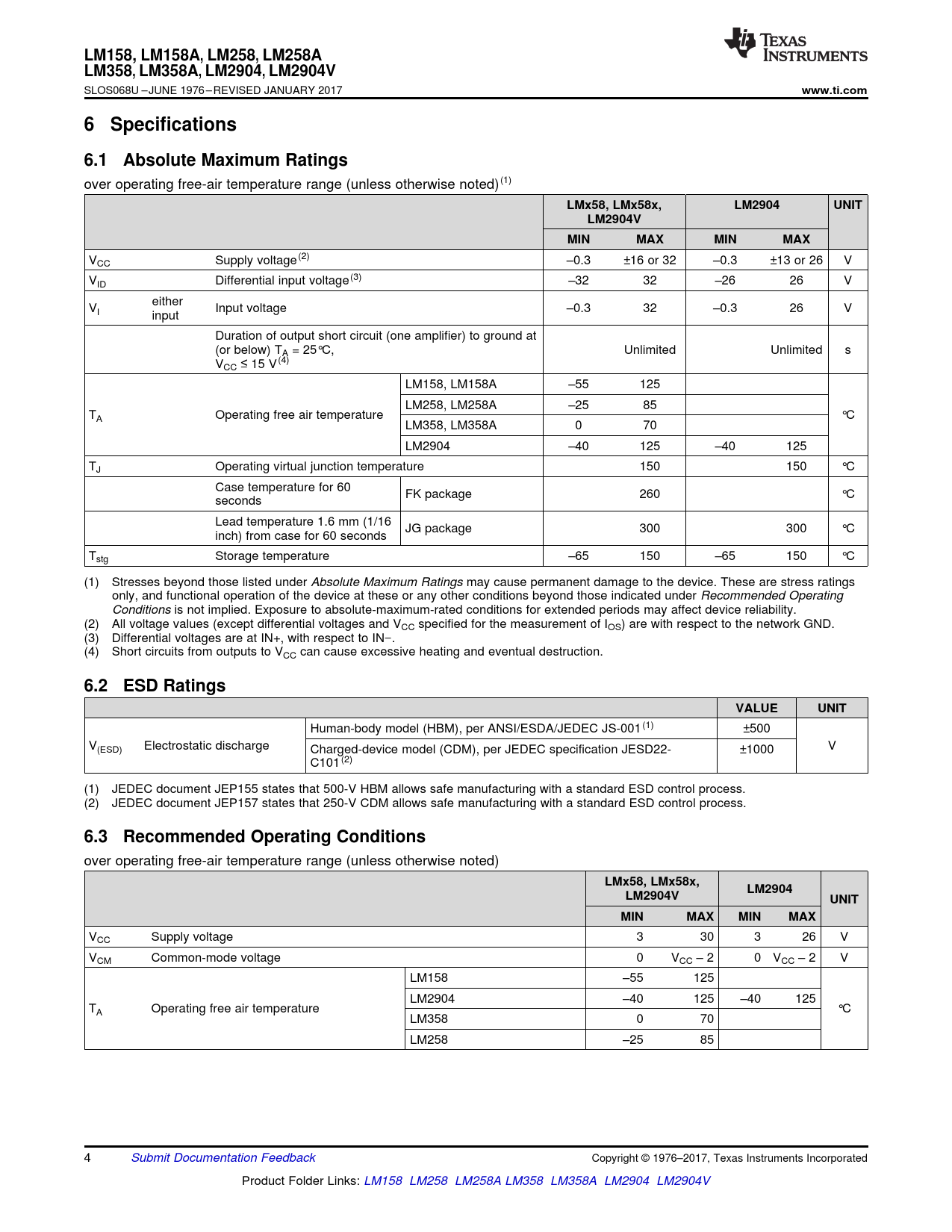

LM158,. LM158A, LM258. , LM258A. LM358,. LM358A. , LM2904,. LM2904V. www.ti.com. 6 Specifications. 6.1 Absolute Maximum Ratings
LM158, LM158A, LM258 , LM258A LM358, LM358A , LM2904, LM2904V
SLOS068U – JUNE 1976 – REVISED JANUARY 2017
www.ti.com 6 Specifications 6.1 Absolute Maximum Ratings
over operating free-air temperature range (unless otherwise noted)(1)
LMx58, LMx58x, LM2904 UNIT LM2904V MIN MAX MIN MAX
VCC Supply voltage(2) –0.3 ±16 or 32 –0.3 ±13 or 26 V VID Differential input voltage(3) –32 32 –26 26 V either VI Input voltage –0.3 32 –0.3 26 V input Duration of output short circuit (one amplifier) to ground at (or below) TA = 25°C, Unlimited Unlimited s VCC ≤ 15 V(4) LM158, LM158A –55 125 LM258, LM258A –25 85 TA Operating free air temperature °C LM358, LM358A 0 70 LM2904 –40 125 –40 125 TJ Operating virtual junction temperature 150 150 °C Case temperature for 60 FK package 260 °C seconds Lead temperature 1.6 mm (1/16 JG package 300 300 °C inch) from case for 60 seconds Tstg Storage temperature –65 150 –65 150 °C (1) Stresses beyond those listed under Absolute Maximum Ratings may cause permanent damage to the device. These are stress ratings only, and functional operation of the device at these or any other conditions beyond those indicated under Recommended Operating Conditions is not implied. Exposure to absolute-maximum-rated conditions for extended periods may affect device reliability. (2) All voltage values (except differential voltages and VCC specified for the measurement of IOS) are with respect to the network GND. (3) Differential voltages are at IN+, with respect to IN−. (4) Short circuits from outputs to VCC can cause excessive heating and eventual destruction.
6.2 ESD Ratings VALUE UNIT
Human-body model (HBM), per ANSI/ESDA/JEDEC JS-001(1) ±500 V(ESD) Electrostatic discharge V Charged-device model (CDM), per JEDEC specification JESD22- ±1000 C101(2) (1) JEDEC document JEP155 states that 500-V HBM allows safe manufacturing with a standard ESD control process. (2) JEDEC document JEP157 states that 250-V CDM allows safe manufacturing with a standard ESD control process.
6.3 Recommended Operating Conditions
LMx58, LMx58x, LM2904 LM2904V UNIT MIN MAX MIN MAX
VCC Supply voltage 3 30 3 26 V VCM Common-mode voltage 0 VCC – 2 0 VCC – 2 V LM158 –55 125 LM2904 –40 125 –40 125 TA Operating free air temperature °C LM358 0 70 LM258 –25 85 4 Submit Documentation Feedback Copyright © 1976–2017, Texas Instruments Incorporated Product Folder Links: LM158 LM258 LM258A LM358 LM358A LM2904 LM2904V Document Outline 1 Features 2 Applications 3 Description Table of Contents 4 Revision History 5 Pin Configuration and Functions 6 Specifications 6.1 Absolute Maximum Ratings 6.2 ESD Ratings 6.3 Recommended Operating Conditions 6.4 Thermal Information 6.5 Electrical Characteristics for LMx58 6.6 Electrical Characteristics for LM2904 6.7 Electrical Characteristics for LM158A and LM258A 6.8 Electrical Characteristics for LM358A 6.9 Operating Conditions 6.10 Typical Characteristics 7 Parameter Measurement Information 8 Detailed Description 8.1 Overview 8.2 Functional Block Diagram 8.3 Feature Description 8.3.1 Unity-Gain Bandwidth 8.3.2 Slew Rate 8.3.3 Input Common Mode Range 8.4 Device Functional Modes 9 Application and Implementation 9.1 Application Information 9.2 Typical Application 9.2.1 Design Requirements 9.2.2 Detailed Design Procedure 9.2.3 Application Curve 10 Power Supply Recommendations 11 Layout 11.1 Layout Guidelines 11.2 Layout Examples 12 Device and Documentation Support 12.1 Documentation Support 12.1.1 Related Documentation 12.2 Related Links 12.3 Receiving Notification of Documentation Updates 12.4 Community Resources 12.5 Trademarks 12.6 Electrostatic Discharge Caution 12.7 Glossary 13 Mechanical, Packaging, and Orderable Information
