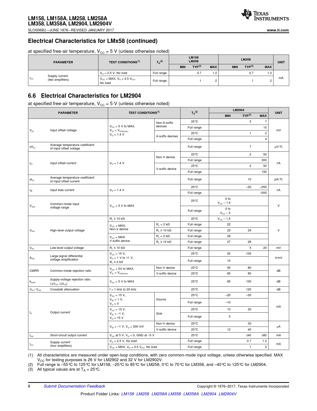

LM158,. LM158A, LM258. , LM258A. LM358,. LM358A. , LM2904,. LM2904V. www.ti.com. Electrical Characteristics for LMx58 (continued). LM158
LM158, LM158A, LM258 , LM258A LM358, LM358A , LM2904, LM2904V
SLOS068U – JUNE 1976 – REVISED JANUARY 2017
www.ti.com Electrical Characteristics for LMx58 (continued)
at specified free-air temperature, VCC = 5 V (unless otherwise noted)
LM158 LM358 PARAMETER TEST CONDITIONS(1) T (2) LM258 A UNIT MIN TYP(3) MAX MIN TYP(3) MAX
VO = 2.5 V, No load Full range 0.7 1.2 0.7 1.2 Supply current ICC mA (two amplifiers) VCC = MAX, VO = 0.5 VCC, Full range 1 2 1 2 No load
6.6 Electrical Characteristics for LM2904
LM2904 PARAMETER TEST CONDITIONS(1) T (2) A UNIT MIN TYP(3) MAX
Non-A-suffix 25°C 3 7 VCC = 5 V to MAX, devices Full range 10 VIO Input offset voltage VIC = VICR(min), mV V 25°C 1 2 O = 1.4 V A-suffix devices Full range 4 Average temperature coefficient αVIO Full range 7 μV/°C of input offset voltage 25°C 2 50 Non-V device Full range 300 IIO Input offset current VO = 1.4 V nA 25°C 2 50 V-suffix device Full range 150 Average temperature coefficient αIIO Full range 10 pA/°C of input offset current 25°C –20 –250 IIB Input bias current VO = 1.4 V nA Full range –500 0 to 25°C Common-mode input VCC – 1.5 VICR V V voltage range CC = 5 V to MAX 0 to Full range VCC – 2 RL ≥ 10 kΩ 25°C VCC – 1.5 V RL = 2 kΩ Full range 22 CC = MAX, V Non-V device OH High-level output voltage R V L ≥ 10 kΩ Full range 23 24 V RL = 2 kΩ Full range 26 CC = MAX V-suffix device RL ≥ 10 kΩ Full range 27 28 VOL Low-level output voltage RL ≤ 10 kΩ Full range 5 20 mV VCC = 15 V, 25°C 25 100 Large-signal differential AVD V V/mV voltage amplification O = 1 V to 11 V, R Full range 15 L ≥ 2 kΩ V Non-V device 25°C 50 80 CMRR Common-mode rejection ratio CC = 5V to MAX, dB VIC = VICR(min) V-suffix device 25°C 65 80 Supply-voltage rejection ratio kSVR V (ΔV CC = 5 V to MAX 25°C 65 100 dB CC /ΔVIO) VO1/ VO2 Crosstalk attenuation f = 1 kHz to 20 kHz 25°C 120 dB VCC = 15 V, 25°C –20 –30 VID = 1 V, Source V Full range –10 O = 0 mA VCC = 15 V, 25°C 10 20 IO Output current VID = –1 V, Sink V Full range 5 O = 15 V Non-V device 25°C 30 VID = –1 V, VO = 200 mV μA V-suffix device 25°C 12 40 IOS Short-circuit output current VCC at 5 V, VO = 0, GND at −5 V 25°C ±40 ±60 mA Supply current VO = 2.5 V, No load Full range 0.7 1.2 ICC mA (four amplifiers) VCC = MAX, VO = 0.5 VCC, No load Full range 1 2 (1) All characteristics are measured under open-loop conditions, with zero common-mode input voltage, unless otherwise specified. MAX VCC for testing purposes is 26 V for LM2902 and 32 V for LM2902V. (2) Full range is –55°C to 125°C for LM158, –25°C to 85°C for LM258, 0°C to 70°C for LM358, and –40°C to 125°C for LM2904. (3) All typical values are at TA = 25°C. 6 Submit Documentation Feedback Copyright © 1976–2017, Texas Instruments Incorporated Product Folder Links: LM158 LM258 LM258A LM358 LM358A LM2904 LM2904V Document Outline 1 Features 2 Applications 3 Description Table of Contents 4 Revision History 5 Pin Configuration and Functions 6 Specifications 6.1 Absolute Maximum Ratings 6.2 ESD Ratings 6.3 Recommended Operating Conditions 6.4 Thermal Information 6.5 Electrical Characteristics for LMx58 6.6 Electrical Characteristics for LM2904 6.7 Electrical Characteristics for LM158A and LM258A 6.8 Electrical Characteristics for LM358A 6.9 Operating Conditions 6.10 Typical Characteristics 7 Parameter Measurement Information 8 Detailed Description 8.1 Overview 8.2 Functional Block Diagram 8.3 Feature Description 8.3.1 Unity-Gain Bandwidth 8.3.2 Slew Rate 8.3.3 Input Common Mode Range 8.4 Device Functional Modes 9 Application and Implementation 9.1 Application Information 9.2 Typical Application 9.2.1 Design Requirements 9.2.2 Detailed Design Procedure 9.2.3 Application Curve 10 Power Supply Recommendations 11 Layout 11.1 Layout Guidelines 11.2 Layout Examples 12 Device and Documentation Support 12.1 Documentation Support 12.1.1 Related Documentation 12.2 Related Links 12.3 Receiving Notification of Documentation Updates 12.4 Community Resources 12.5 Trademarks 12.6 Electrostatic Discharge Caution 12.7 Glossary 13 Mechanical, Packaging, and Orderable Information
