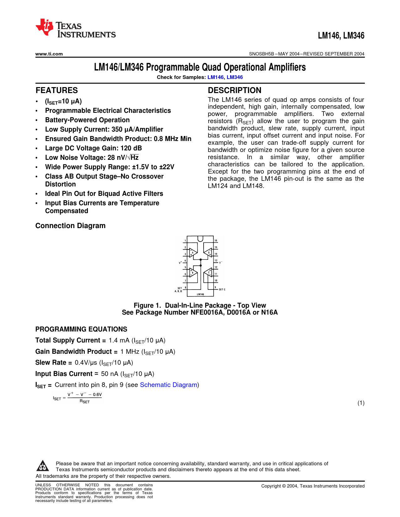

LM146/LM346 Programmable Quad Operational Amplifiers Check for Samples: LM146, LM346 FEATURES DESCRIPTION 1
The LM146 series of quad op amps consists of four
• (I 2 SET=10 μA)
independent, high gain, internally compensated, low
• Programmable Electrical Characteristics
power, programmable amplifiers. Two external
• Battery-Powered Operation
resistors (RSET) allow the user to program the gain bandwidth product, slew rate, supply current, input
• Low Supply Current: 350 μA/Amplifier
bias current, input offset current and input noise. For
• Ensured Gain Bandwidth Product: 0.8 MHz Min
example, the user can trade-off supply current for
• Large DC Voltage Gain: 120 dB
bandwidth or optimize noise figure for a given source
• Low Noise Voltage: 28 nV/√Hz
resistance. In a similar way, other amplifier characteristics can be tailored to the application.
• Wide Power Supply Range: ±1.5V to ±22V
Except for the two programming pins at the end of
• Class AB Output Stage–No Crossover
the package, the LM146 pin-out is the same as the
Distortion
LM124 and LM148.
• Ideal Pin Out for Biquad Active Filters • Input Bias Currents are Temperature Compensated Connection Diagram Figure 1. Dual-In-Line Package - Top View See Package Number NFE0016A, D0016A or N16A PROGRAMMING EQUATIONS Total Supply Current =
1.4 mA (ISET/10 μA)
Gain Bandwidth Product =
1 MHz (ISET/10 μA)
Slew Rate =
0.4V/μs (ISET/10 μA)
Input Bias Current
≃ 50 nA (ISET/10 μA)
ISET =
Current into pin 8, pin 9 (see Schematic Diagram) (1) 1 Please be aware that an important notice concerning availability, standard warranty, and use in critical applications of Texas Instruments semiconductor products and disclaimers thereto appears at the end of this data sheet. All trademarks are the property of their respective owners. 2 UNLESS OTHERWISE NOTED this document contains Copyright © 2004, Texas Instruments Incorporated PRODUCTION DATA information current as of publication date. Products conform to specifications per the terms of Texas Instruments standard warranty. Production processing does not necessarily include testing of all parameters. Document Outline FEATURES DESCRIPTION Connection Diagram Capacitorless Active Filters (Basic Circuit) ABSOLUTE MAXIMUM RATINGS DC ELECTRICAL CHARACTERISTICS DC ELECTRICAL CHARACTERISTIC DC ELECTRICAL CHARACTERISTICS TYPICAL PERFORMANCE CHARACTERISTICS APPLICATION HINTS COMMON-MODE INPUT VOLTAGE OUTPUT VOLTAGE SWING VS ISET INPUT CAPACITANCE TEMPERATURE EFFECT ON THE GBW ISOLATION BETWEEN AMPLIFIERS LM146 TYPICAL PERFORMANCE SUMMARY SPEED VS POWER CONSUMPTION Typical Applications Active Filters Applications Circuit Synthesis Equations Circuit Synthesis Equations Miscellaneous Applications Schematic Diagram
