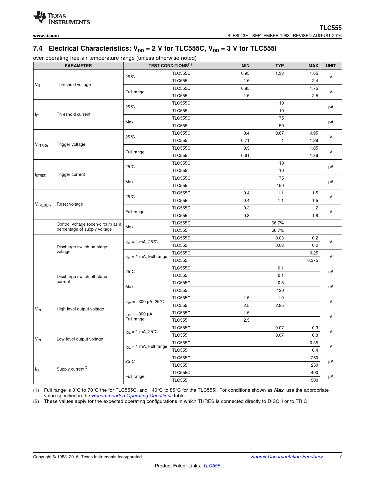

TLC555. www.ti.com. 7.4 Electrical Characteristics: VDD = 2 V for TLC555C, VDD = 3 V for TLC555I. PARAMETER. TEST CONDITIONS(1)
TLC555 www.ti.com 7.4 Electrical Characteristics: VDD = 2 V for TLC555C, VDD = 3 V for TLC555I PARAMETER TEST CONDITIONS(1)
link to page 6
TLC555 www.ti.com
SLFS043H – SEPTEMBER 1983 – REVISED AUGUST 2016
over operating free-air temperature range (unless otherwise noted)
PARAMETER TEST CONDITIONS(1) MIN TYP MAX UNIT
TLC555C 0.95 1.33 1.65 25°C V TLC555I 1.6 2.4 VIT Threshold voltage TLC555C 0.85 1.75 Full range V TLC555I 1.5 2.5 TLC555C 10 25°C pA TLC555I 10 IIT Threshold current TLC555C 75 Max pA TLC555I 150 TLC555C 0.4 0.67 0.95 25°C V TLC555I 0.71 1 1.29 VI(TRIG) Trigger voltage TLC555C 0.3 1.05 Full range V TLC555I 0.61 1.39 TLC555C 10 25°C pA TLC555I 10 II(TRIG) Trigger current TLC555C 75 Max pA TLC555I 150 TLC555C 0.4 1.1 1.5 25°C V TLC555I 0.4 1.1 1.5 VI(RESET) Reset voltage TLC555C 0.3 2 Full range V TLC555I 0.3 1.8 Control voltage (open-circuit) as a TLC555C 66.7% Max percentage of supply voltage TLC555I 66.7% TLC555C 0.03 0.2 IOL = 1 mA, 25°C V Discharge switch on-stage TLC555I 0.03 0.2 voltage TLC555C 0.25 IOL = 1 mA, Full range V TLC555I 0.375 TLC555C 0.1 25°C nA Discharge switch off-stage TLC555I 0.1 current TLC555C 0.5 Max nA TLC555I 120 TLC555C 1.5 1.9 IOH = –300 µA, 25°C V TLC555I 2.5 2.85 VOH High-level output voltage I TLC555C 1.5 OH = –300 µA, V Full range TLC555I 2.5 TLC555C 0.07 0.3 IOL = 1 mA, 25°C V TLC555I 0.07 0.3 VOL Low-level output voltage TLC555C 0.35 IOL = 1 mA, Full range V TLC555I 0.4 TLC555C 250 25°C µA TLC555I 250 IDD Supply current(2) TLC555C 400 Full range µA TLC555I 500 (1) Full range is 0°C to 70°C the for TLC555C, and −40°C to 85°C for the TLC555I. For conditions shown as
