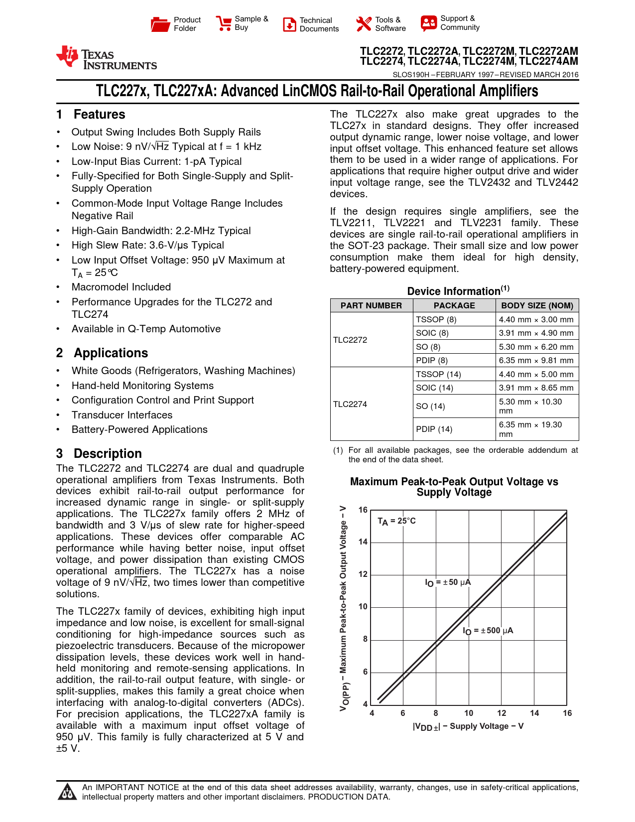

TLC227x, TLC227xA: Advanced LinCMOS Rail-to-Rail Operational Amplifiers 1 Features
The TLC227x also make great upgrades to the TLC27x in standard designs. They offer increased • Output Swing Includes Both Supply Rails 1 output dynamic range, lower noise voltage, and lower • Low Noise: 9 nV/√Hz Typical at f = 1 kHz input offset voltage. This enhanced feature set allows • Low-Input Bias Current: 1-pA Typical them to be used in a wider range of applications. For applications that require higher output drive and wider • Fully-Specified for Both Single-Supply and Split- input voltage range, see the TLV2432 and TLV2442 Supply Operation devices. • Common-Mode Input Voltage Range Includes Negative Rail If the design requires single amplifiers, see the TLV2211, TLV2221 and TLV2231 family. These • High-Gain Bandwidth: 2.2-MHz Typical devices are single rail-to-rail operational amplifiers in • High Slew Rate: 3.6-V/μs Typical the SOT-23 package. Their small size and low power • Low Input Offset Voltage: 950 μV Maximum at consumption make them ideal for high density, T battery-powered equipment. A = 25°C • Macromodel Included

3 Description
(1) For all available packages, see the orderable addendum at the end of the data sheet. The TLC2272 and TLC2274 are dual and quadruple operational amplifiers from Texas Instruments. Both
Maximum Peak-to-Peak Output Voltage vs
devices exhibit rail-to-rail output performance for
Supply Voltage
increased dynamic range in single- or split-supply
V 16
applications. The TLC227x family offers 2 MHz of
− e TA = 25
C
bandwidth and 3 V/μs of slew rate for higher-speed
g
applications. These devices offer comparable AC
lta o 14 V
performance while having better noise, input offset
t u
voltage, and power dissipation than existing CMOS
tp u
operational amplifiers. The TLC227x has a noise
12 O
voltage of 9 nV/√Hz, two times lower than competitive
k IO =
50
µ
A a e
solutions.
-P 10
The TLC227x family of devices, exhibiting high input
-to k a
impedance and low noise, is excellent for small-signal
e P IO =
500
µ
A
conditioning for high-impedance sources such as
m 8
piezoelectric transducers. Because of the micropower
u im
dissipation levels, these devices work well in hand-
x a
held monitoring and remote-sensing applications. In
M 6
addition, the rail-to-rail output feature, with single- or
) P
split-supplies, makes this family a great choice when
P
interfacing with analog-to-digital converters (ADCs).
(O O(PP) 4 V 4 6 8
For precision applications, the TLC227xA family is
10 12 14 16
available with a maximum input offset voltage of
|VDD
| − Supply Voltage − V
950 μV. This family is fully characterized at 5 V and ±5 V. 1 An IMPORTANT NOTICE at the end of this data sheet addresses availability, warranty, changes, use in safety-critical applications, intellectual property matters and other important disclaimers. PRODUCTION DATA. Document Outline 1 Features 2 Applications 3 Description Table of Contents 4 Revision History 5 Pin Configuration and Functions 6 Specifications 6.1 Absolute Maximum Ratings 6.2 ESD Ratings 6.3 Recommended Operating Conditions 6.4 Thermal Information 6.5 TLC2272 and TLC2272A Electrical Characteristics VDD = 5 V 6.6 TLC2272 and TLC2272A Electrical Characteristics VDD± = ±5 V 6.7 TLC2274 and TLC2274A Electrical Characteristics VDD = 5 V 6.8 TLC2274 and TLC2274A Electrical Characteristics VDD± = ±5 V 6.9 Typical Characteristics 7 Detailed Description 7.1 Overview 7.2 Functional Block Diagram 7.3 Feature Description 7.4 Device Functional Modes 8 Application and Implementation 8.1 Application Information 8.1.1 Macromodel Information 8.2 Typical Application 8.2.1 High-Side Current Monitor 8.2.1.1 Design Requirements 8.2.1.2 Detailed Design Procedure 8.2.1.3 Application Curves 9 Power Supply Recommendations 10 Layout 10.1 Layout Guidelines 10.2 Layout Example 11 Device and Documentation Support 11.1 Related Links 11.2 Community Resources 11.3 Trademarks 11.4 Electrostatic Discharge Caution 11.5 Glossary 12 Mechanical, Packaging, and Orderable Information
