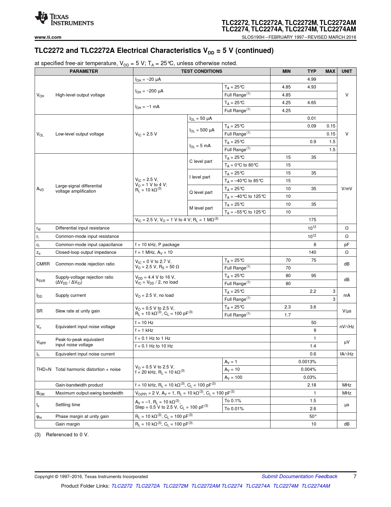

TLC2272. , TLC2272A,. TLC2272M. , TLC2272AM. TLC2274. , TLC2274A,. TLC2274M. , TLC2274AM. www.ti.com
TLC2272 , TLC2272A, TLC2272M , TLC2272AM TLC2274 , TLC2274A, TLC2274M , TLC2274AM www.ti.com
SLOS190H – FEBRUARY 1997 – REVISED MARCH 2016
TLC2272 and TLC2272A Electrical Characteristics VDD = 5 V (continued)
at specified free-air temperature, VDD = 5 V; TA = 25°C, unless otherwise noted.
PARAMETER TEST CONDITIONS MIN TYP MAX UNIT
IOH = −20 μA 4.99 TA = 25°C 4.85 4.93 IOH = −200 μA VOH High-level output voltage Full Range(1) 4.85 V TA = 25°C 4.25 4.65 IOH = −1 mA Full Range(1) 4.25 IOL = 50 μA 0.01 TA = 25°C 0.09 0.15 IOL = 500 μA VOL Low-level output voltage VIC = 2.5 V Full Range(1) 0.15 V TA = 25°C 0.9 1.5 IOL = 5 mA Full Range(1) 1.5 TA = 25°C 15 35 C level part TA = 0°C to 80°C 15 TA = 25°C 15 35 I level part VIC = 2.5 V, TA = –40°C to 85°C 15 Large-signal differential VO = 1 V to 4 V; AVD T V/mV voltage amplification RL = 10 kΩ(3) A = 25°C 10 35 Q level part TA = –40°C to 125°C 10 TA = 25°C 10 35 M level part TA = –55°C to 125°C 10 VIC = 2.5 V, VO = 1 V to 4 V; RL = 1 MΩ(3) 175 rid Differential input resistance 1012 Ω ri Common-mode input resistance 1012 Ω ci Common-mode input capacitance f = 10 kHz, P package 8 pF zo Closed-loop output impedance f = 1 MHz, AV = 10 140 Ω V TA = 25°C 70 75 CMRR Common-mode rejection ratio IC = 0 V to 2.7 V, dB VO = 2.5 V, RS = 50 Ω Full Range(1) 70 Supply-voltage rejection ratio V TA = 25°C 80 95 k DD = 4.4 V to 16 V, SVR dB (ΔVDD / ΔVIO) VIC = VDD / 2, no load Full Range(1) 80 TA = 25°C 2.2 3 IDD Supply currrent VO = 2.5 V, no load mA Full Range(1) 3 V TA = 25°C 2.3 3.6 SR Slew rate at unity gain O = 0.5 V to 2.5 V, V/µs RL = 10 kΩ(3), CL = 100 pF(3) Full Range(1) 1.7 f = 10 Hz 50 Vn Equivalent input noise voltage nV/√Hz f = 1 kHz 9 Peak-to-peak equivalent f = 0.1 Hz to 1 Hz 1 VNPP µV input noise voltage f = 0.1 Hz to 10 Hz 1.4 In Equivalent input noise current 0.6 fA/√Hz AV = 1 0.0013% V THD+N Total harmonic distortion + noise O = 0.5 V to 2.5 V, A f = 20 kHz, R V = 10 0.004% L = 10 kΩ (3) AV = 100 0.03% Gain-bandwidth product f = 10 kHz, RL = 10 kΩ(3), CL = 100 pF(3) 2.18 MHz BOM Maximum output-swing bandwidth VO(PP) = 2 V, AV = 1, RL = 10 kΩ(3), CL = 100 pF(3) 1 MHz A To 0.1% 1.5 t V = –1, RL = 10 kΩ (3), s Settling time µs Step = 0.5 V to 2.5 V, CL = 100 pF(3) To 0.01% 2.6 φm Phase margin at unity gain RL = 10 kΩ(3), CL = 100 pF(3) 50° Gain margin RL = 10 kΩ(3), CL = 100 pF(3) 10 dB (3) Referenced to 0 V. Copyright © 1997–2016, Texas Instruments Incorporated Submit Documentation Feedback 7 Product Folder Links: TLC2272 TLC2272A TLC2272M TLC2272AM TLC2274 TLC2274A TLC2274M TLC2274AM Document Outline 1 Features 2 Applications 3 Description Table of Contents 4 Revision History 5 Pin Configuration and Functions 6 Specifications 6.1 Absolute Maximum Ratings 6.2 ESD Ratings 6.3 Recommended Operating Conditions 6.4 Thermal Information 6.5 TLC2272 and TLC2272A Electrical Characteristics VDD = 5 V 6.6 TLC2272 and TLC2272A Electrical Characteristics VDD± = ±5 V 6.7 TLC2274 and TLC2274A Electrical Characteristics VDD = 5 V 6.8 TLC2274 and TLC2274A Electrical Characteristics VDD± = ±5 V 6.9 Typical Characteristics 7 Detailed Description 7.1 Overview 7.2 Functional Block Diagram 7.3 Feature Description 7.4 Device Functional Modes 8 Application and Implementation 8.1 Application Information 8.1.1 Macromodel Information 8.2 Typical Application 8.2.1 High-Side Current Monitor 8.2.1.1 Design Requirements 8.2.1.2 Detailed Design Procedure 8.2.1.3 Application Curves 9 Power Supply Recommendations 10 Layout 10.1 Layout Guidelines 10.2 Layout Example 11 Device and Documentation Support 11.1 Related Links 11.2 Community Resources 11.3 Trademarks 11.4 Electrostatic Discharge Caution 11.5 Glossary 12 Mechanical, Packaging, and Orderable Information
